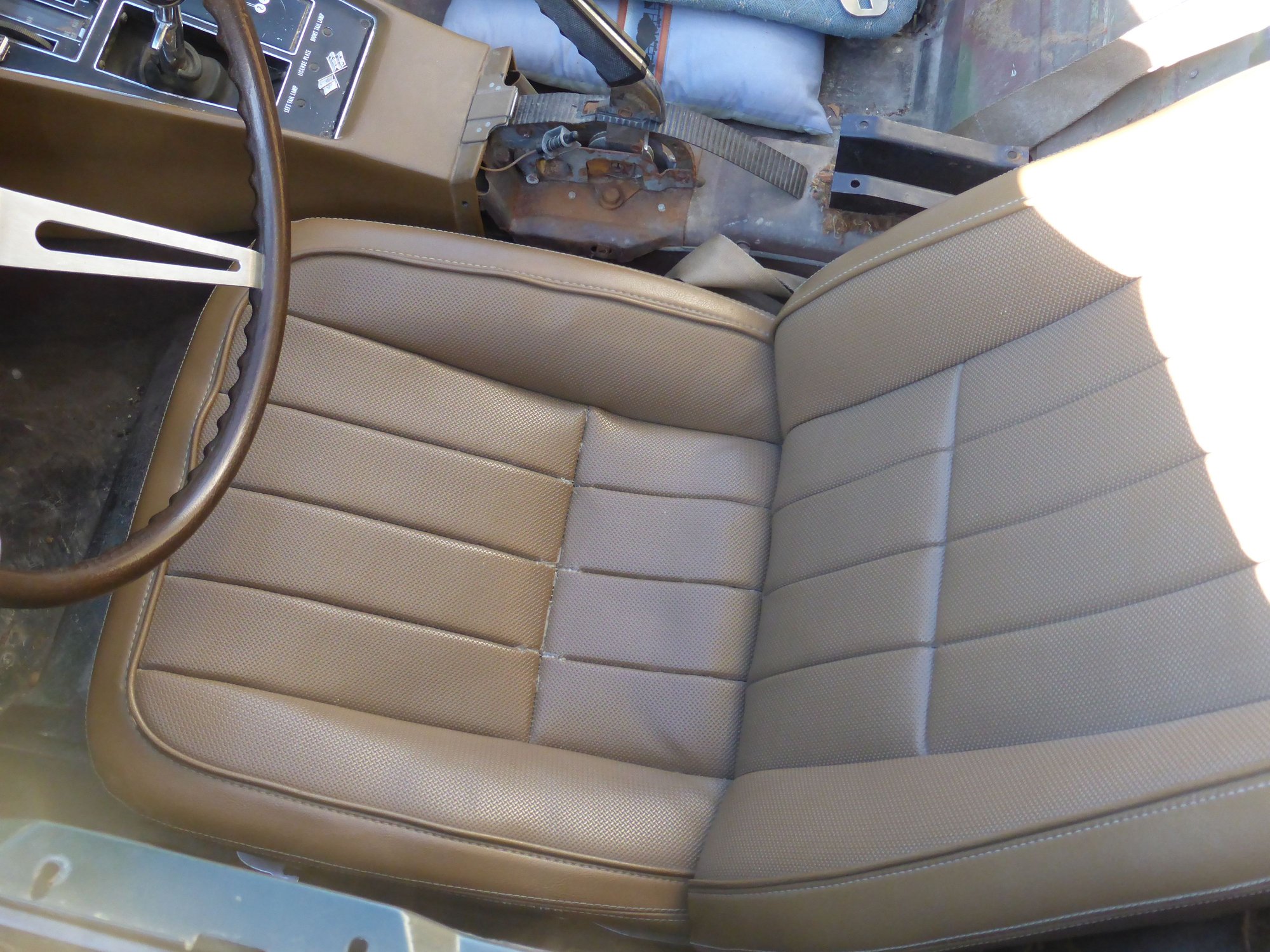

They would most likely be '68, there's no real chance of '69 parts. What are the seats that you have? What's the weave design? Were headrests added? Pictures again help a lot.
Some photos.
Seats

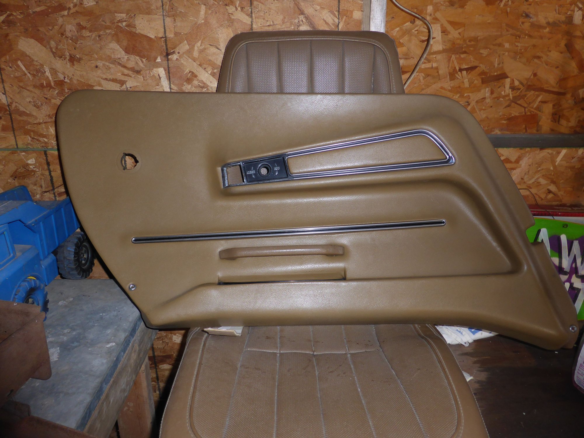

With the seats out of the car a tag that gives a part number and date becomes visible (hopefully) and will be a clue to when they were made and when they could have been installed.
There's likely a date on the door panels too.
Regards,
Alan

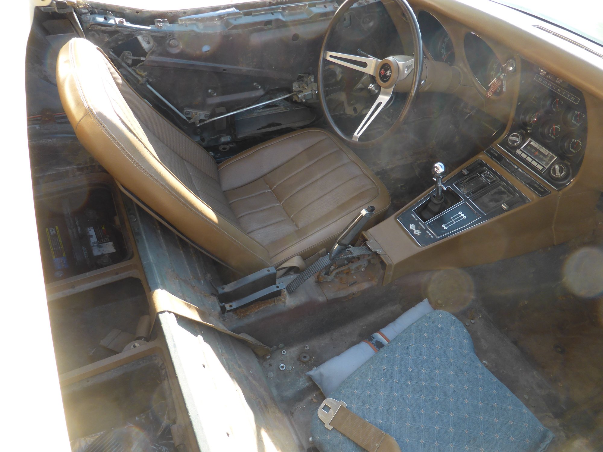

Seat Tag: part # and Julian date…. 348th day of 1970 for a car built about the 14th day of 1971
Door panel stamp: for the same car.

68 Had a unique color called tobacco. Your seats look very dark and they do look like 68 basket weave seats to me. Lou.
Tobacco is a bit darker, kind of orangish-brown.

That is definitely a medium saddle interior color. For other years, the saddle color might have been lighter or darker. 1973 had "Dark Saddle" as a specified interior color; 1975 had "Medium Saddle".
There was a "Beige" color that was similar to saddle and a "Neutral" which was even lighter than beige. And, if GM decided to change vendors for those items during the model year, the same color from the two vendors could be a bit different.
Since you have original parts, I suggest that you choose which part has the color you want to have, then have vinyl dye mixed to THAT color so that you can recolor repaired areas, as well as 'old' and 'new' parts. That way you will have uniform color on all your interior parts.
