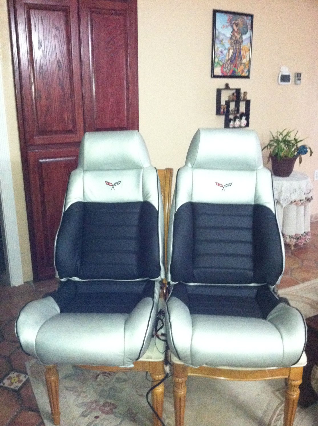

Seems like most use Fiero seats and buy replacement skins from My Mike (http://www.mrmikes.com). They aren't direct bolt in but you can still use the C3 seat tracks with a little work. I picked up a seat this past weekend for $100.00 for Craigslist.
My plan is to go with this look.

I have those same seats purchased from a fellow forum member. they are great. you can get an adapter plate that will allow them to bolt right into the C3. note these are a tad taller than OEM so if you are tall try someones on for size.

They look great now to just find b some feiro seats

I went with Fiero seats Put seat warmers in them for when It a little cool.. Used Mr Mikes covers also

Here is how I did mine.
