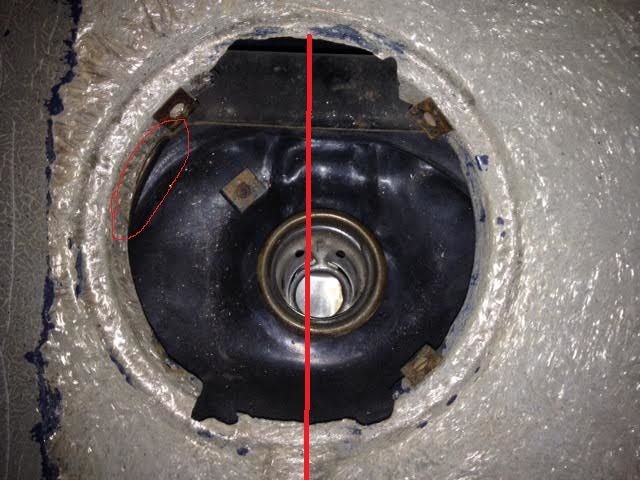

Maybe this shows. I had the tank out freshening it up before. It was off centered before I pulled it and was off centered when I put it back. I will loosen the tank straps and see if I can get the tank itself more centered, but I think I tried when I put it back in. You can see on the upper left where the actual tank cover is showing, and it has no adjustment. Does this warrant anymore attention from me, or is this good enough for a driver? I'm also thinking it is possible that when it was repaired before, they might have over pulled it a little because it is shifted towards the side of impact.

Hi,
"does this require anymore attention from me" ?
I guess it depends on the actual cause of the misalignment, and how much it bothers you.
For me I'd wonder about it each time I put gas in.
Is that the fiberglass on the rear deck surface we're seeing in the picture?
Regards,
Alan
Hope that loose u-clip doesn't slip into the tank.

The fiberglass is another story within itself, but I have a plan for that. I just wondered if this is "close enough" or if I need to stop what I'm doing, pull the body off and take a bare or rolling chassis to someone that can check the frame. This is a 77 that I just want to drive around and enjoy, so that's why I'm questioning whether to do anything about it or not.

Loosen up the tank straps, and position the tank so that it is centered (there should be enough movement at that point) and tighten the straps. You may want to use wood or ? as spacers/shims temporarily to keep it centered as you tighten up the straps.
The frame may be bent from an accident, but I wouldn't base that decision on the misalignment of the fuel fill neck, cars that have their tanks removed/replaced often will be off center, until/unless the installer catches it at the time of installation.
Seems your concern about a possible bent frame, wont go away until you have it checked out though. For that reason I would have that done for your peace of mind.
