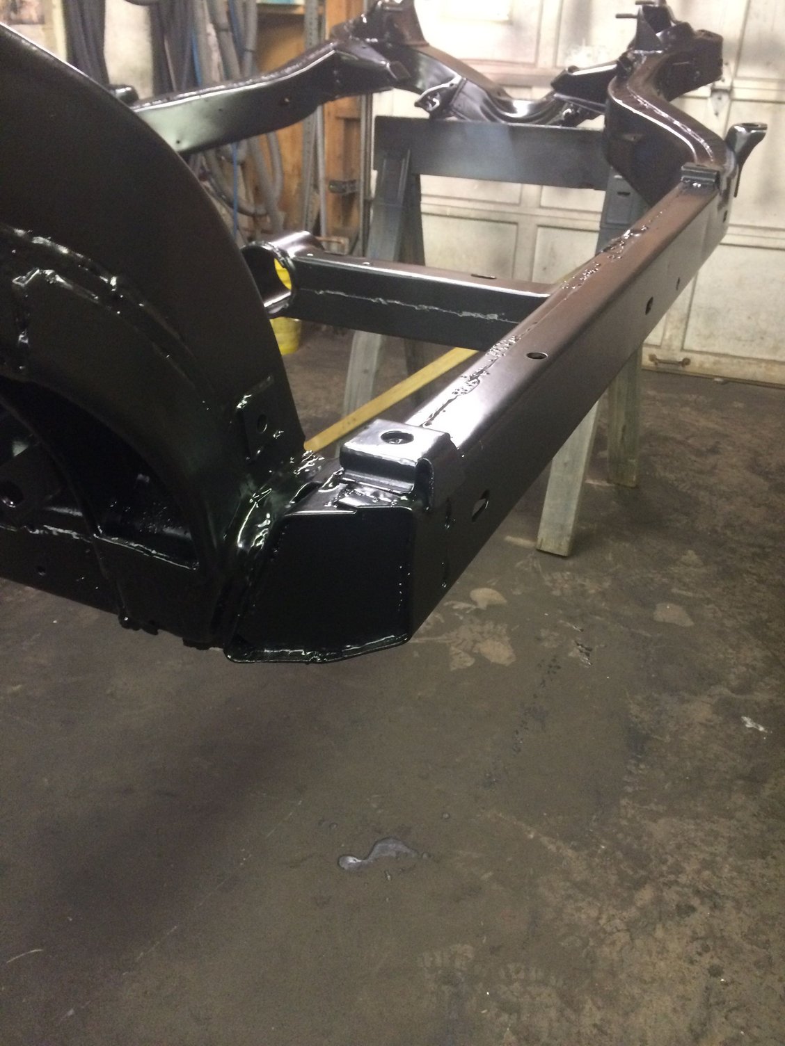

1969 replacement frame. Blasted and coatwd inside and out. What you think?

The coating is a SEMA product that I got from a local frame shop. I will def. measure. And you are right about the factory welds. They really enhanced after paint

This frame was sent out for blasting. Rust preventative was sprayed inside and hung at different angles. Then epoxied. Brought back to the shop and sanded with 220. Sprayed on the SEMA coating. Outside and inside. Then let hang. Took me 6 months to get it back from the guy I hired. It is a 69 big block frame with a welded in crossmember. I wish i could have gotten side by sides of my frame next to it. It def. looks beefier but my other was rotted completely. If you look on my posts you can see the rot. Overall I am happy. The 6 months allowed me to gather parts, components and Money!! She will go together quick hopefully!
