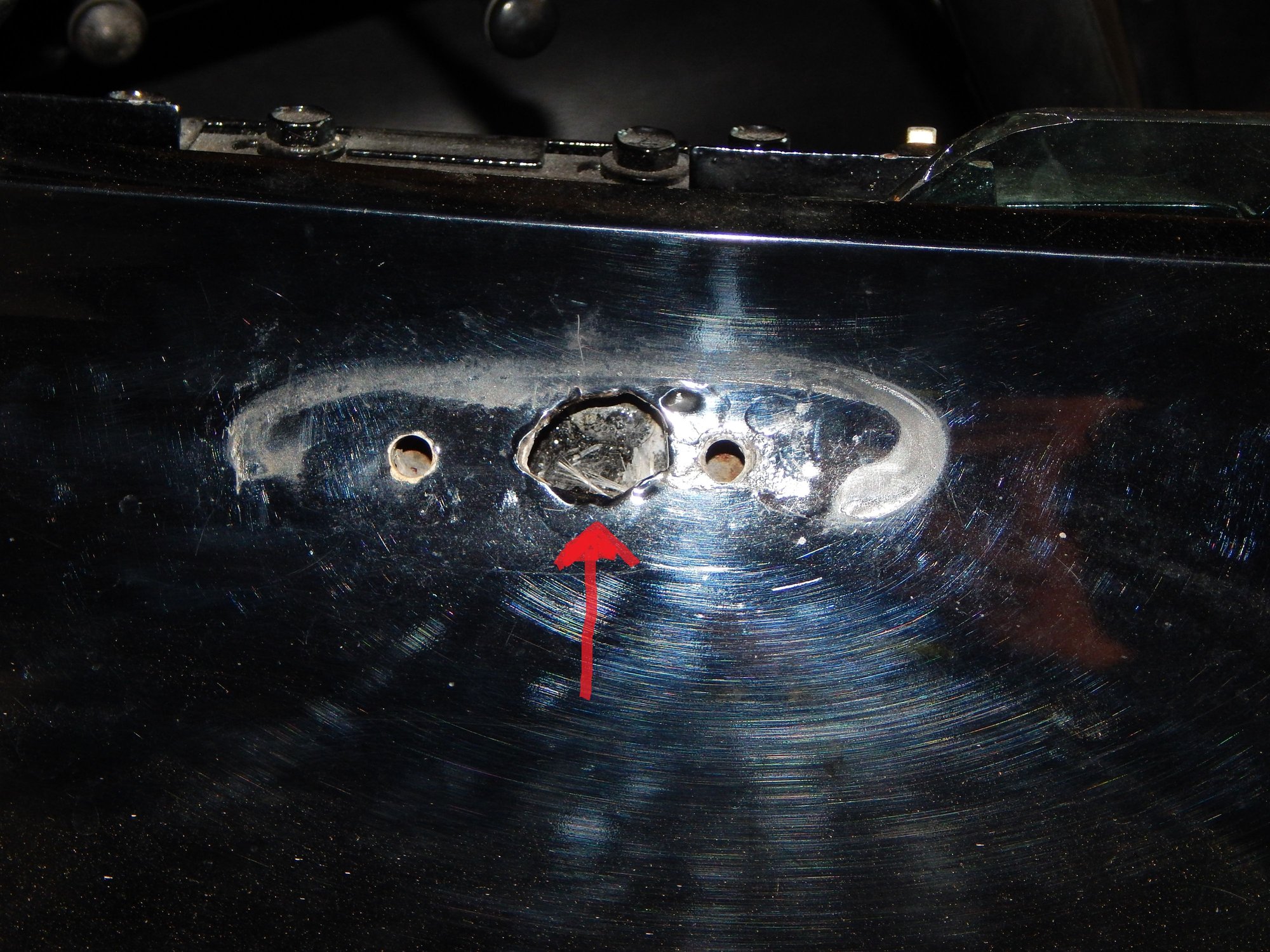

The previous owner cut a hole in between the two mounting screw holes on my '76. That way you can fenangle the bolt in there (I used a pencil magnet) and bolt it without removing the interior door panel. I'm not positive, but I'm pretty sure the mirror mounting style was very similar on the early-C3's compared to the mid-C3's.
