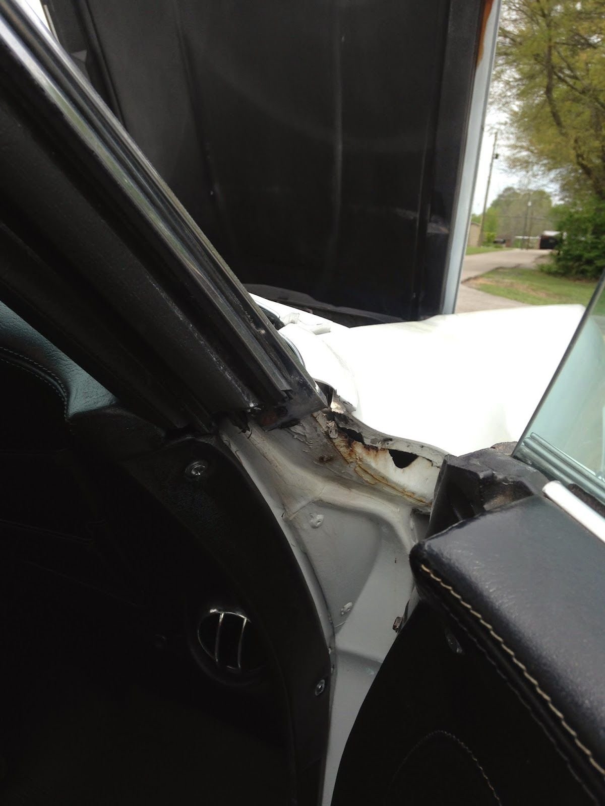

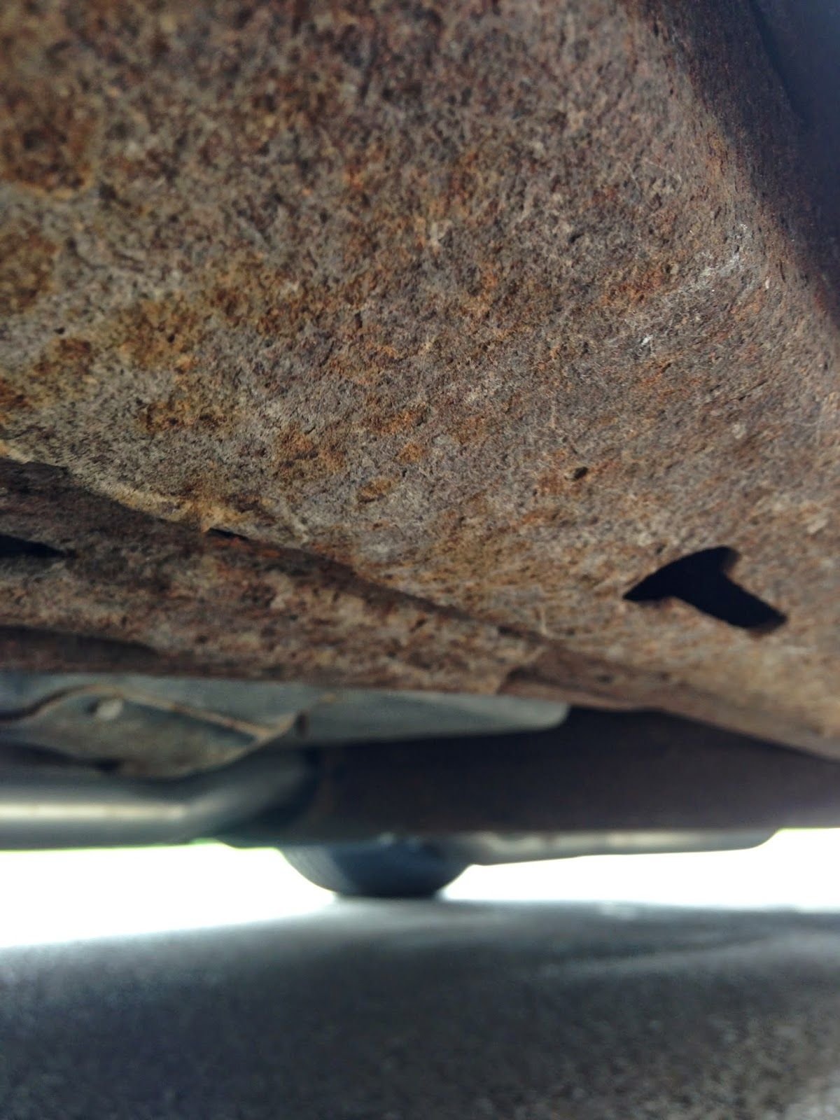

I went to look at a 72 4 speed today....Car drove solid and the body gaps looked pretty good but I'm afraid it may have some serious hidden rust issues....? I'm looking for opinions....? This car is not listed for sale on the forum and as far as I know the seller is not a member here. I was soo disappointed when I inspected the underside....The interior is in great shape, considering the miles that I think it has....Odometer shows around 45,000 but by the looks of the clutch pedal I think it has 145,000....See the last pic in this post for up close pic of it.
I posted all the pic I took today on my blog for those here that know the URL...If anybody else wants to see the other pics just send me a PM and I will send the link. Yes I did ask about taking pics and the guy was OK with it....Super nice guy that also has a mint 69 that he showed me.

I don't think the rust issues are hidden. They are very obvious. I would not buy a car in that condition.

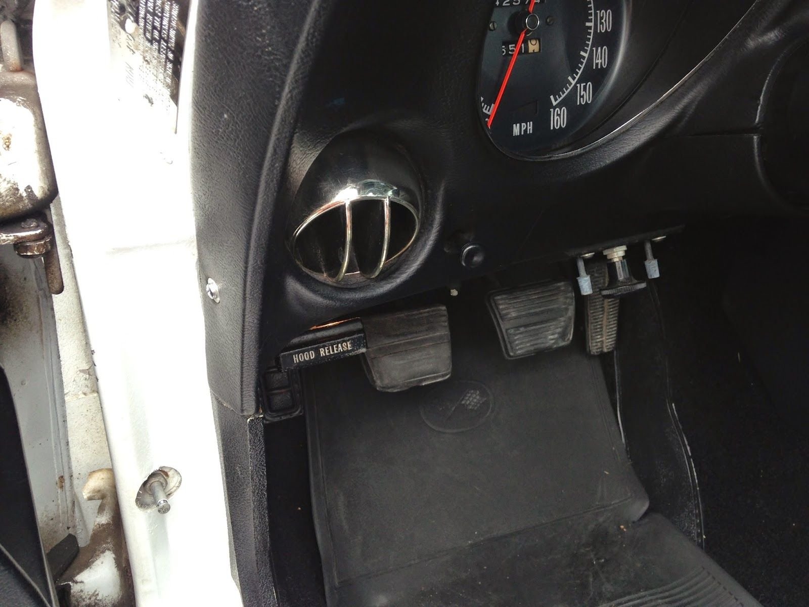

Pretty crusty.
145k looks right as well. Pedals are about worn through

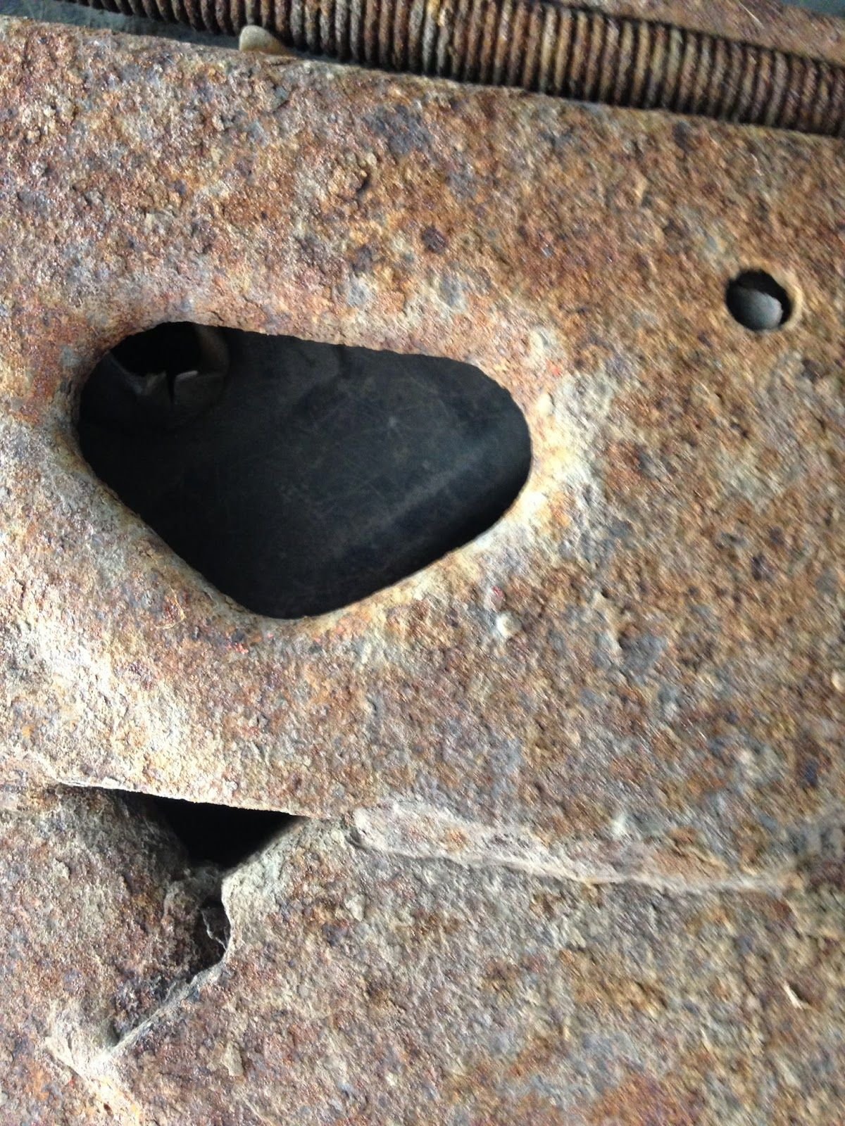

I've seen worse frame rust, but the rust on this frame appears to have progressed past the surface rust stage. Based on the pictures, I'd describe it as rust scale.

You are being kind. Even the doors are finished.

I would pass on this car, based on the rust shown in your pictures. I would be very concerned with what you cannot see. Let me show you.!
r
I am not saying this is all in the car you are looking at but this was my car when I purchased it. See any rust???

I guess it really depends what sort of work you're willing to get into with a car as to whether this one is even a possibility.
The doors are certainly rusted and the chassis has an 'odd' extremely consistent 'rust crust' to it. (Almost like it spent some time under water.)
The little bit of the interior that can be seen doesn't look too good either. The door panel for instance has a rather amateurish full length repair to the arm rest.
I think it's the kind of car you should avoid and even $16.5k is WAY too much money for it. It's one thing to unknowingly get involved with a car like this, but to buy it with your eyes open would be pretty foolish.
