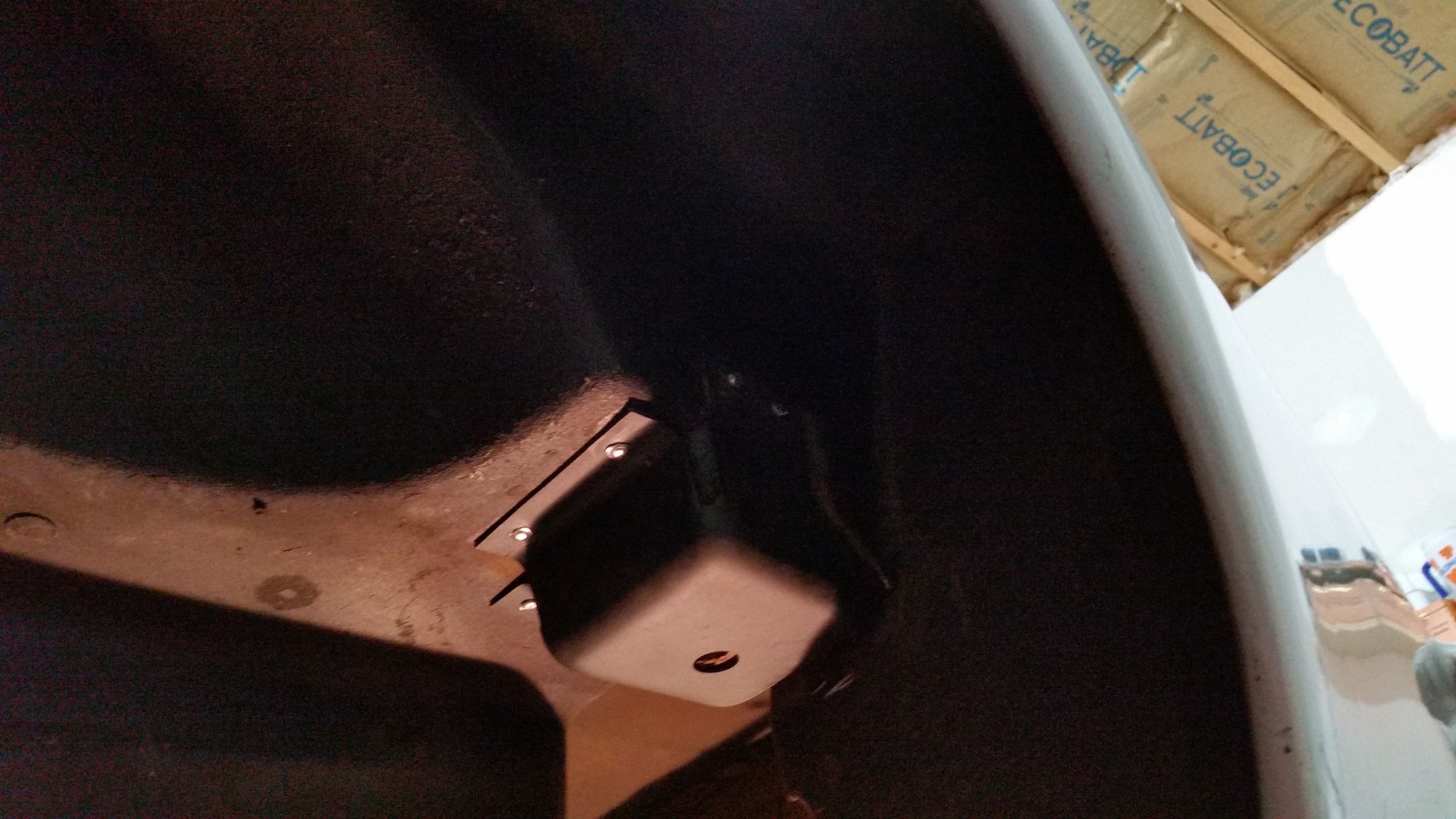

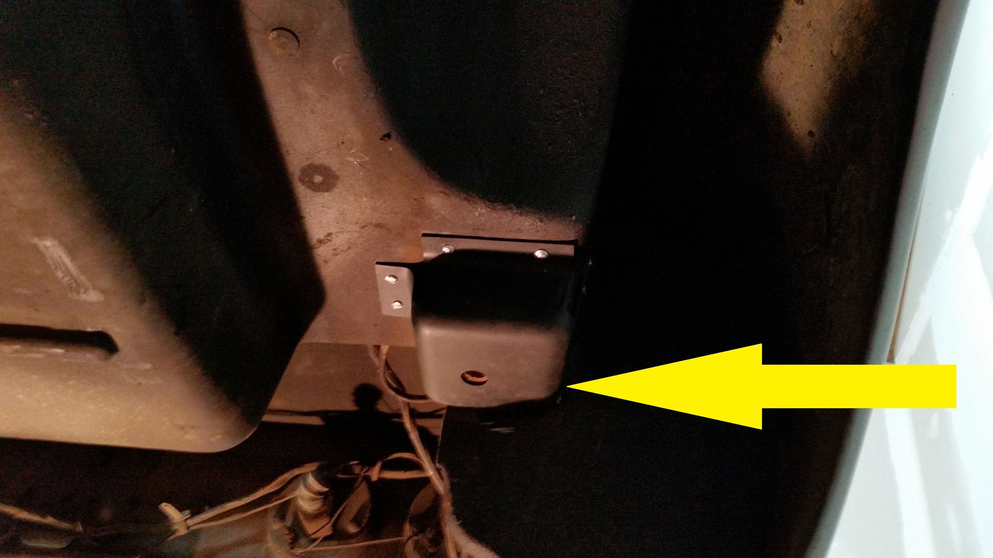

I am cleaning the underside , with the body off.
My number 4 mounts came off quite easy. lots of rust and dirt.
I have the replacements. I am cleaning the outside and inside of that area.
I saw on the forums here a while ago that someone used some "stuff" between the mount and the body so where was no holes at all that water can get into. Search but I couldn't find it.
Also should I rivet them in or just bolt them in?
Can anyone recommend anything else to do there.

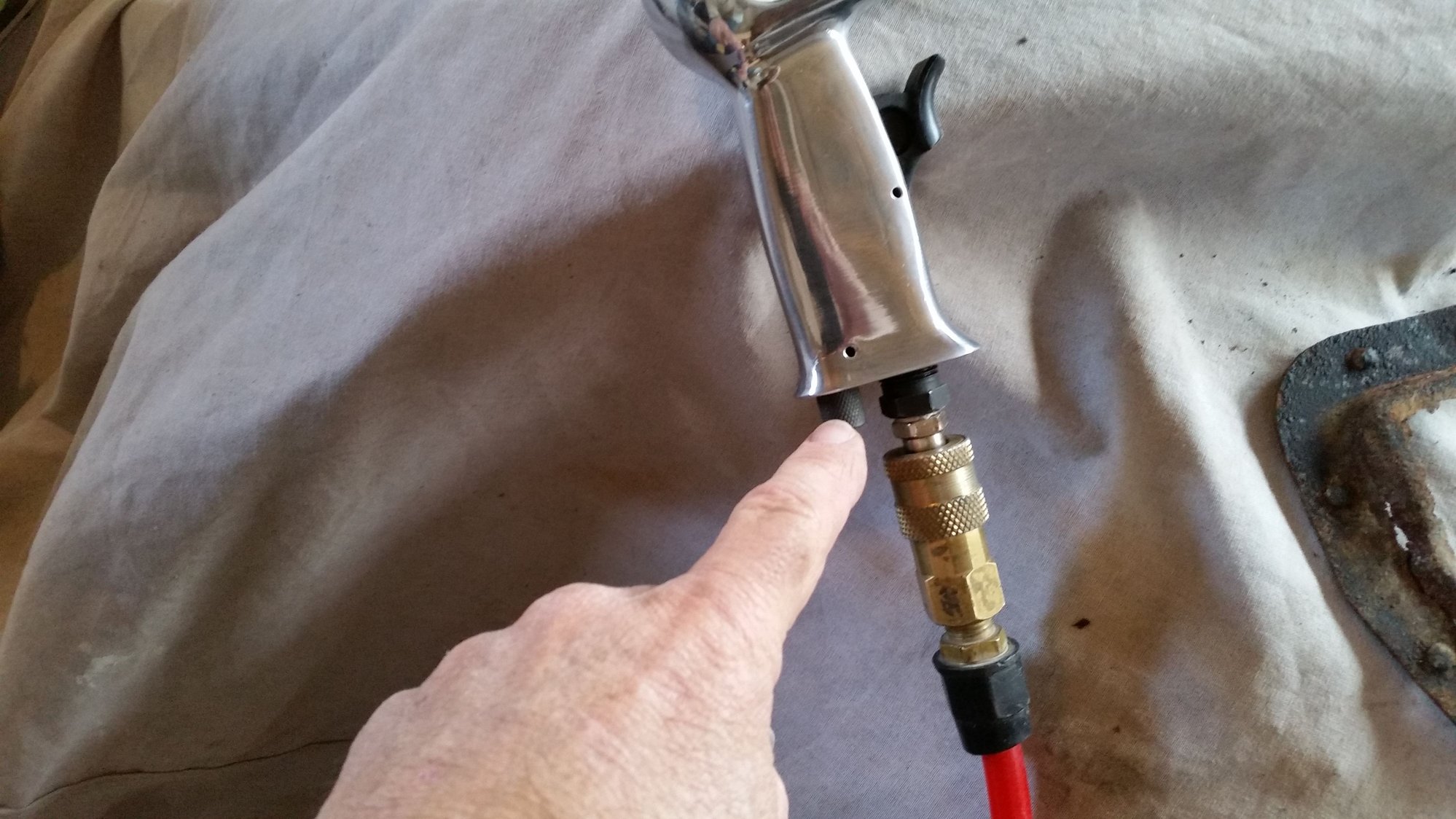

I assume a air rivet gun would be a better option.?

Hi Dirk76, if you are going to rivet the supports back onto the car then yes you will need a air gun. I would also recommend that it have a adjustable air adjustment on the bottom to regulat the amount of air (not to much). It is very difficult to get to some of them so I would also suggest an off set bit. You can get them from Aircraft Spruce. Not a fun job but doable.
Good Luck
r
Hope this helps you make a decision!

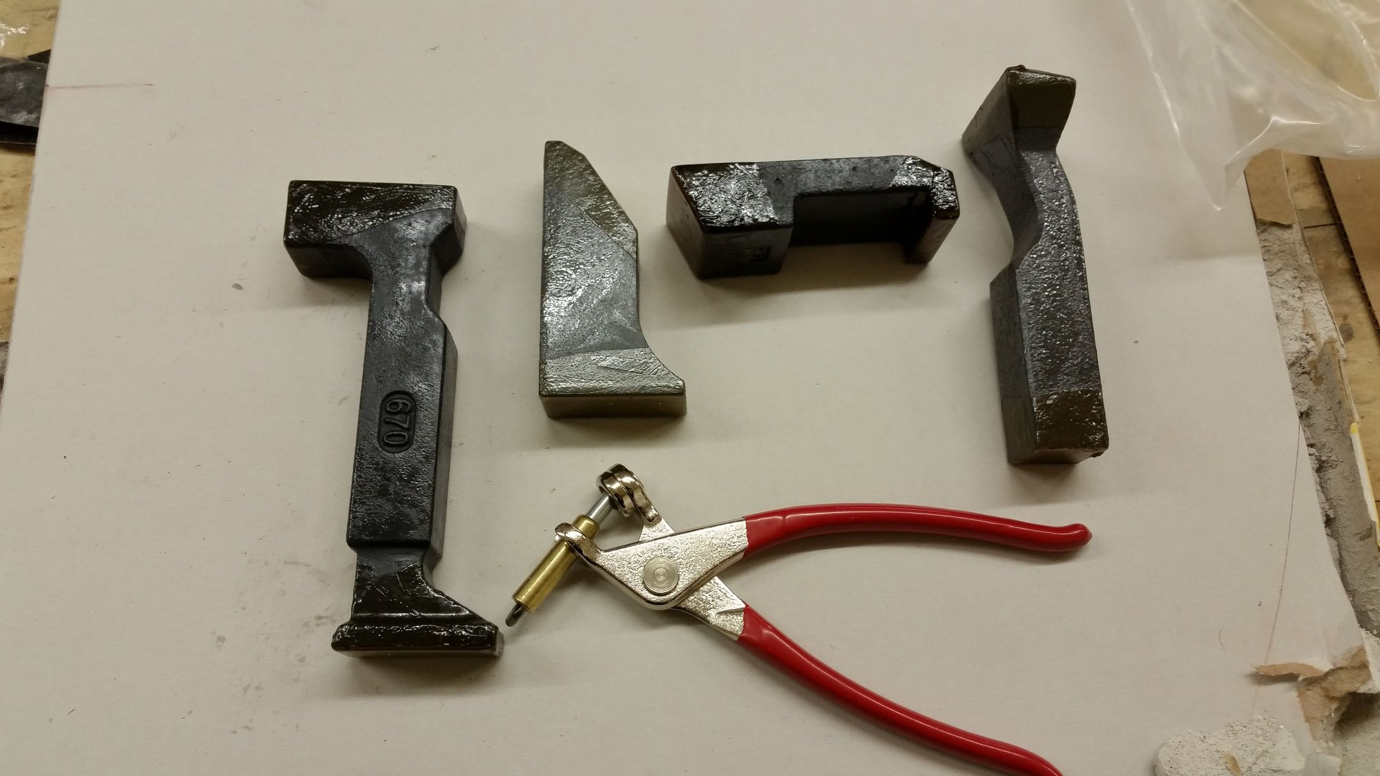

I'm curious what people use on the flat side if the rivets. A bucking bar or just a hammer face? I remember that there was a tool that put the rings into the face like the originals too.
Old Apr 17, 2015 | 09:01 AM
SB64's Avatar
SB64
Joined: Jun 2013
Posts: 4,399
Likes: 793
I used an assortment of bucking bars in different sizes and shapes.
r
The cleco pins are a must also for the parts that need to be held tight to the body.
