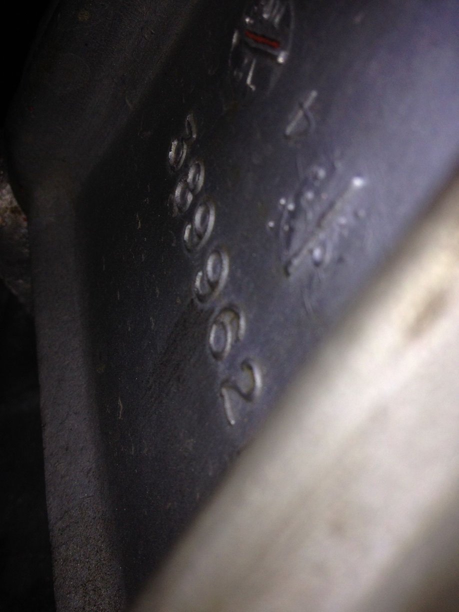

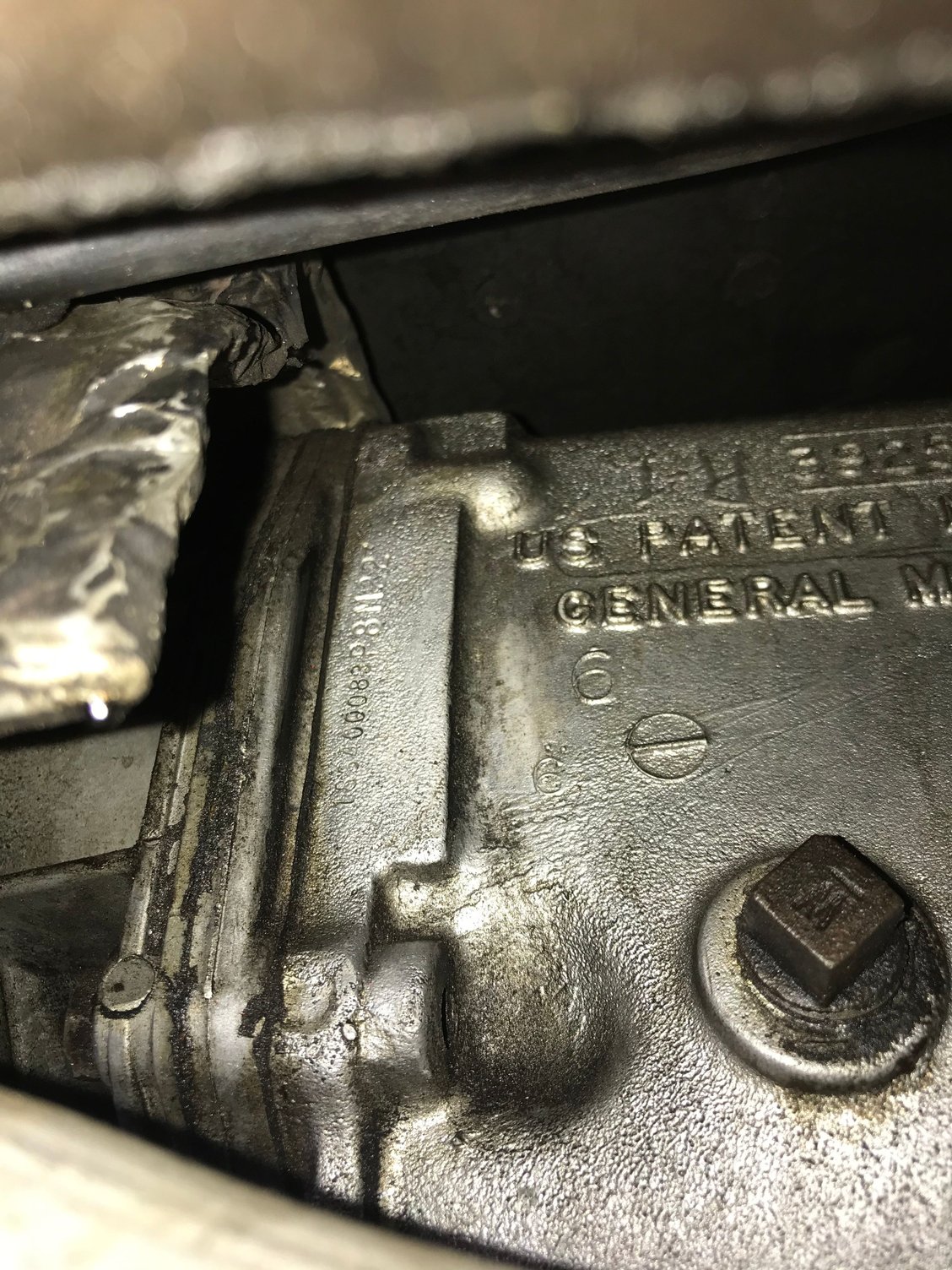

1968 - 1969 1" Bore Patent Number (3) Colvin's "by the numbers" book notes that Muncie data shows 1968 and 1969 M22 transmissions received main case #3925661. All documented M22 transmissions have the #3925660 main case. It is unclear why there is the discrepancy.
PIC 1
STAMP#3925660
US PATENT NO 3088336
(AND DRAIN PLUG)
=M22? (NOT FACTORY)?

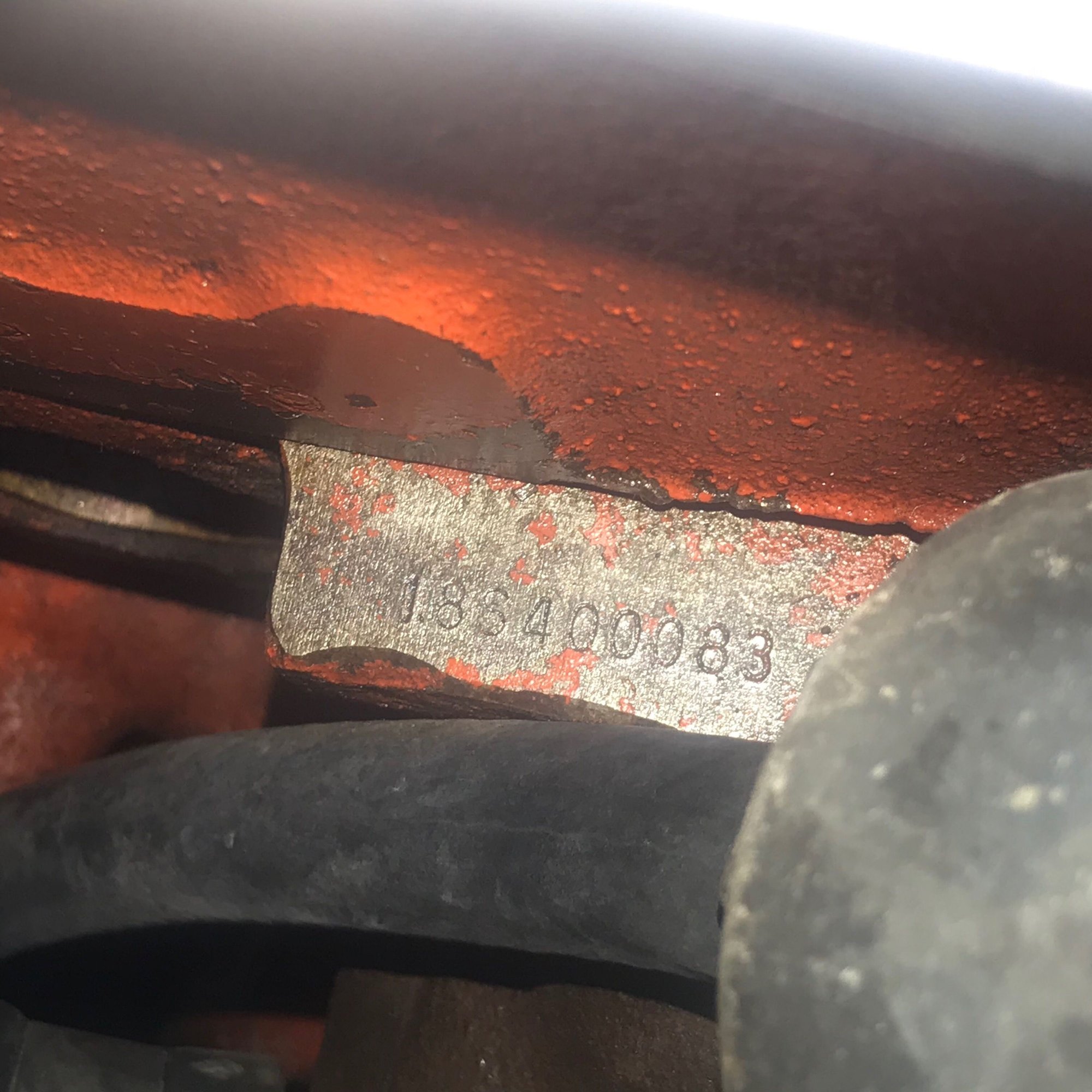

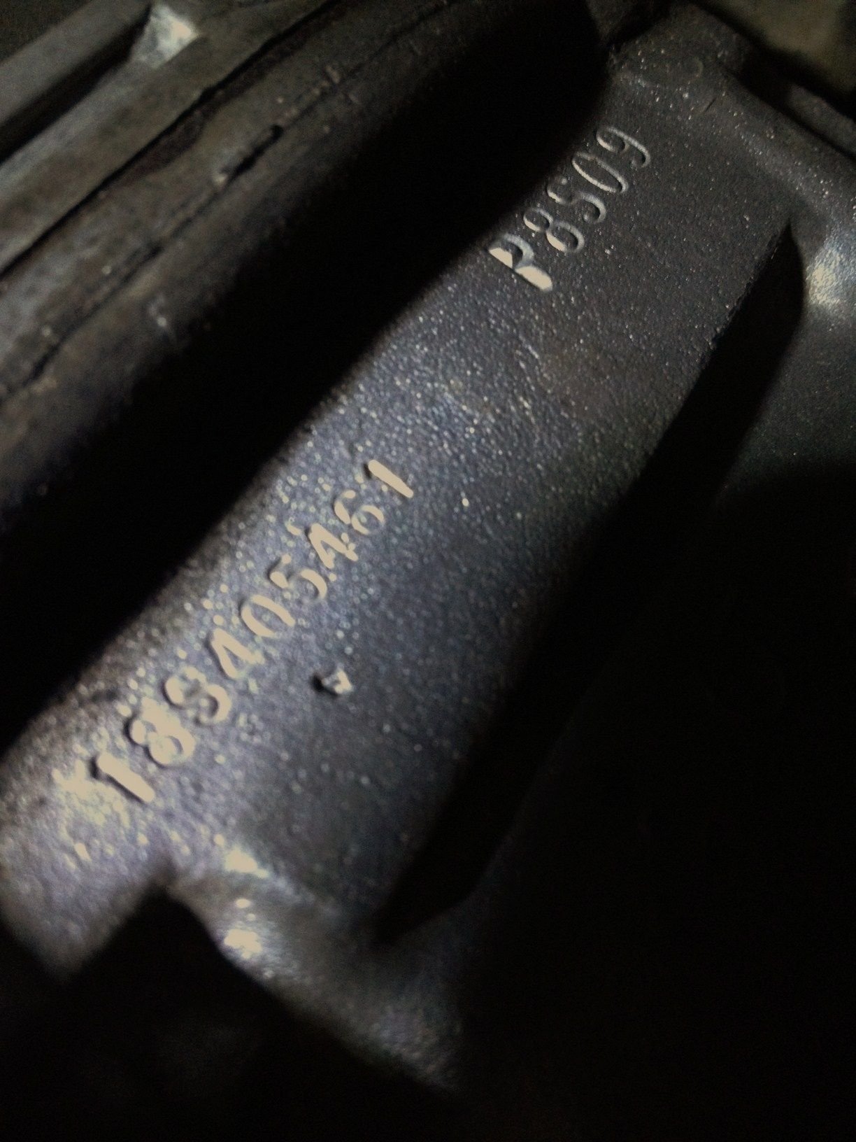

PIC2
PARTIAL VIN AND P8S09
=FACTORY? MUNCIE NOV09 1967

GM docs all say that the L71 engine was only available with the M21 transmission, so I would be shocked to find you have something other than that. It is simple to add a drain plug and many have done it, so that is not a reliable indicator of an M22. Even the gears can be easily changed.
For 1968 and early 1969 you can't tell if it is a M20, M21, or M22 from the POP or transmissions stampings. They simply tell you the date the transmission was made and the car vin it was put into. Later in the 1969 model year they started stamping A, B, or C at the end of the date to denote the type.
Does your transmission still have the metal tag with the part number on it? With this you should be able to determine M21 vs. M22.
Your rear end code of FA on the POP is a HD 3.70 rear end used in BB applications.

The metal tag isnt where it should be. Does this different casting no. mean anything? 38996621

Frank,
The P8M22 you see stamped on the transmission is the date code. P - Munice, 8 - model year, M - August, 22 - day.
A suffix code of A, B or C at the end of the date would signify the type. A = M20, B = M21, C = M22.
The suffix code didn't start until early in the 1969 model year.
