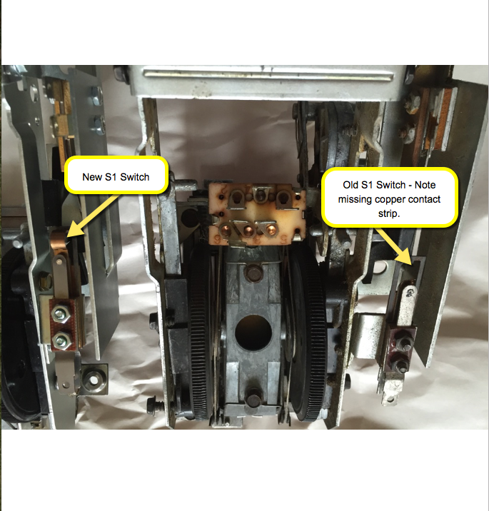

Ordered a new Heater/AC controller. Discovered the small contact strip on the old S1 switch had gone AWOL.
Tom
New AC control module on the left, old controller on the right.
