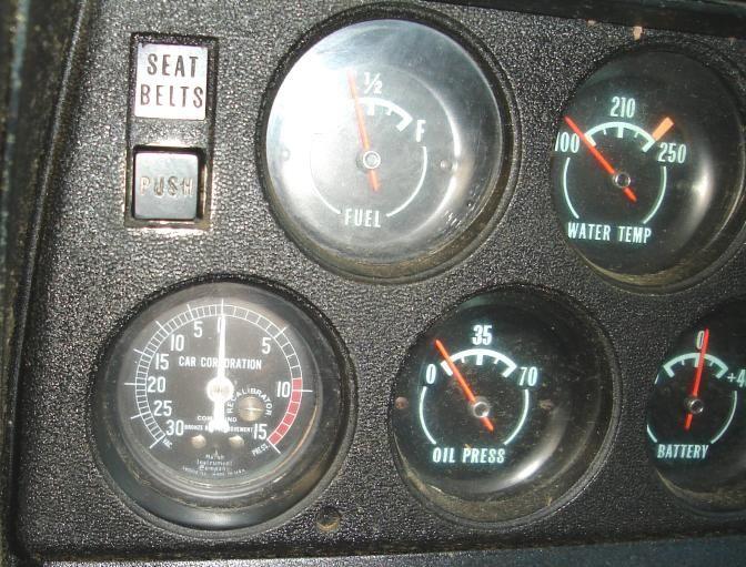

Originally Posted by F22
I said screw the clock and put a vacuum gauge in there. Much more useful. I can always check what time it is on my wrist watch, cell phone, blackberry or pager, but not my engine vacuum.
Would you be thinking something like this?
But yeah for people who are not so purists as they dont mind an upgrade the Quartz Clock Conversion Kit is the hot item...
Not to hijack, but would the pressure line come from a tap in the carb base/intake manifold?
Steve
It's a vacuum/pressure gauge as my car had a blower before I got it, blowers and turbos are where we would see it peg the pressure side in my car normal breathing 454 it's just an old school cool looking vacuum gauge....
