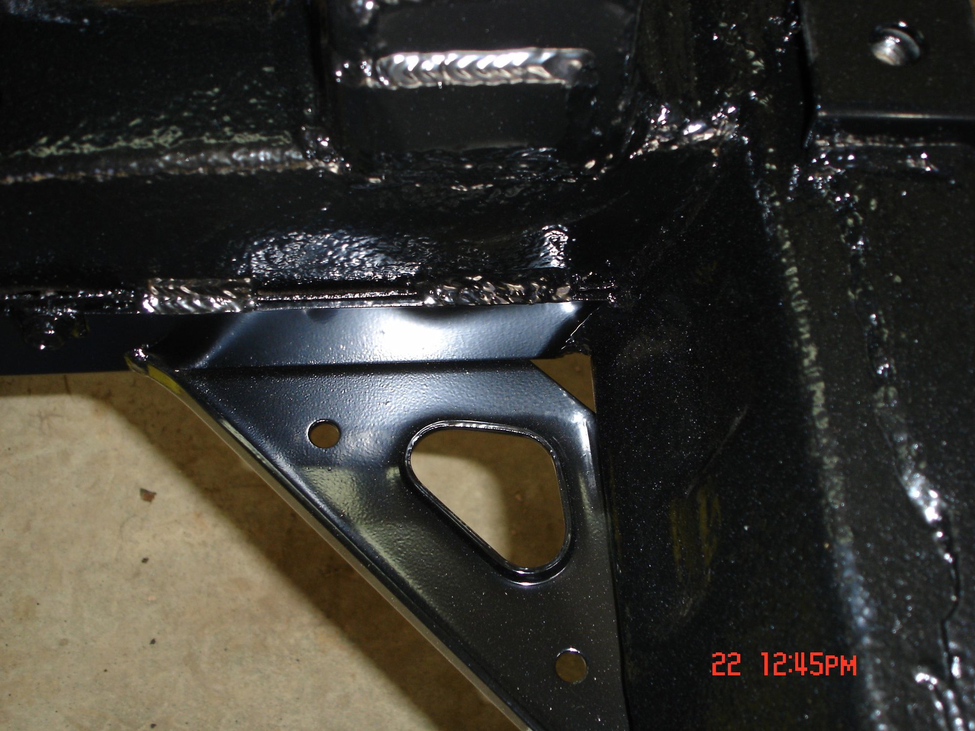

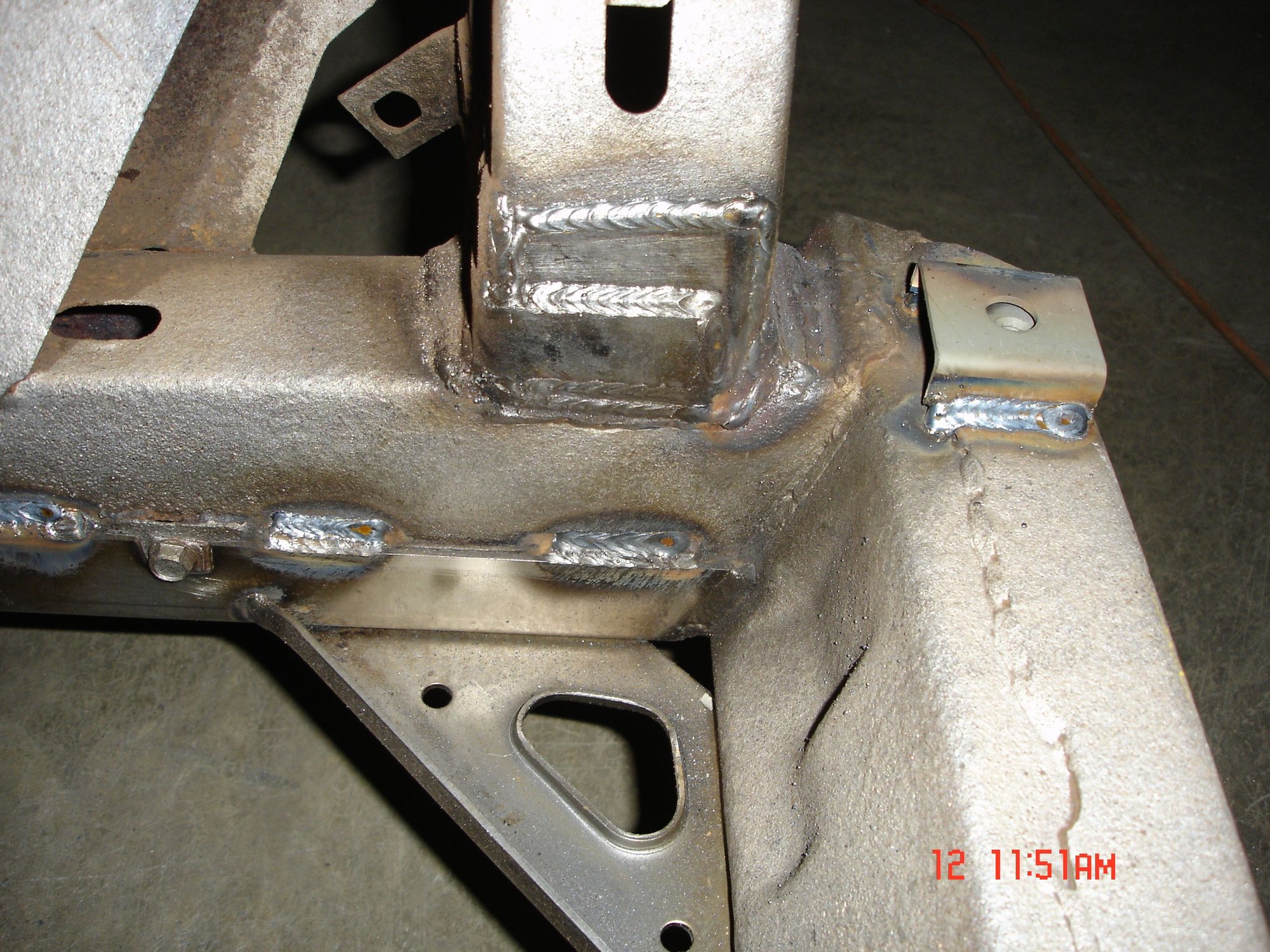

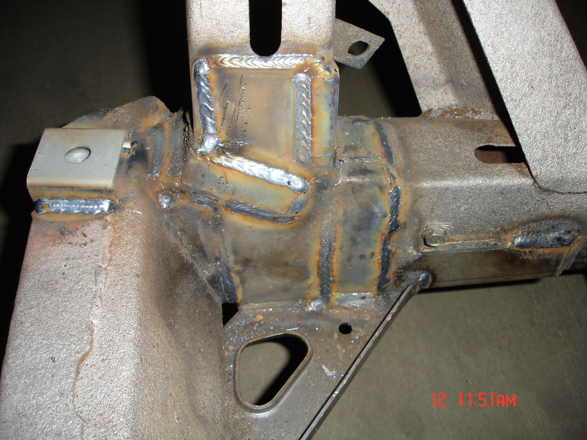

My bird frame was a total crock of **** and I repaired it in 1 week. Unless you're going for some wild NCRS build it's not a big deal. I am located in NJ if you need any help

Real nice job and a big difference.

Wow, that is awesome offer! I wish I closer, but live in Illinois. You did a great job!

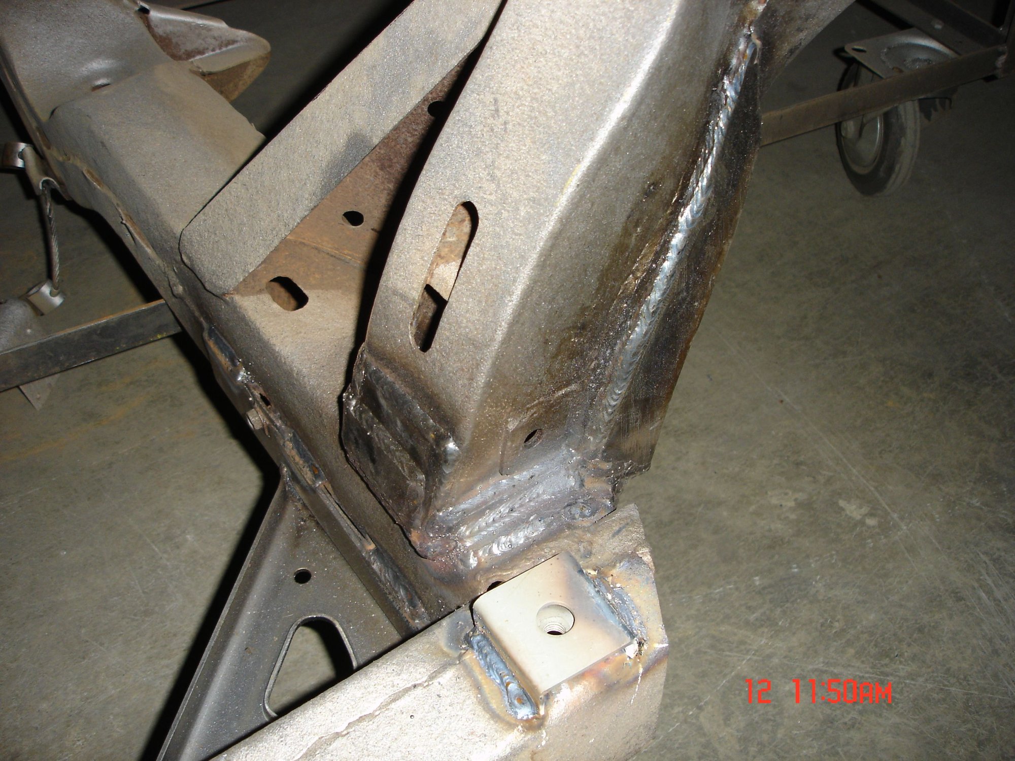

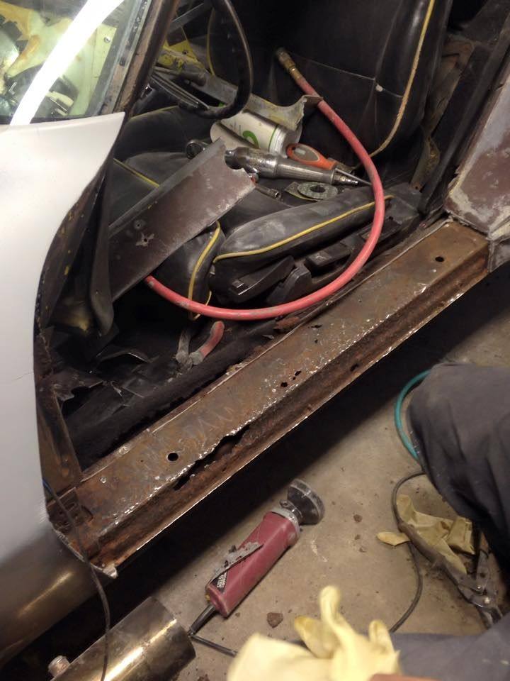

When I purchased my 69 it had frame rust in the upkick areas so I performed some surgery after purchasing some frame pieces from Zip!
r
Had to add new gussets also. Just wanted to show off!

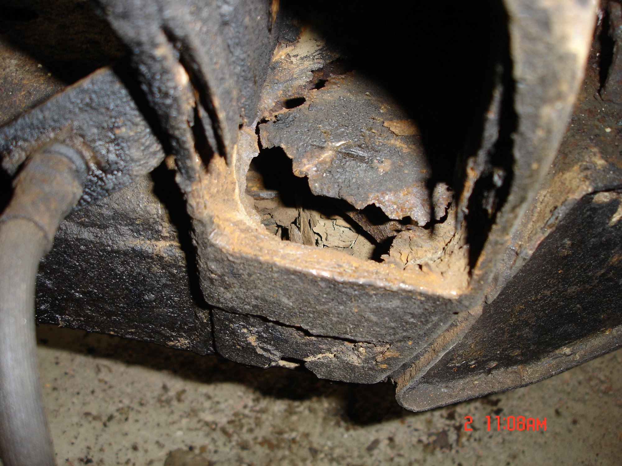

Rust is the thing that I am jaded over it's my kryptonite, my achilles heel if you will,
It can ruin a beautiful looking c3.
I knew I had basic surface rust on my 69, I knew from the way the mount for the front fender tops had scale peaking it had some rust.
When I busted that rear strut that had zero to due with rust it made me crawl in and find a hole in the rear kick up pass side.
Tina my wife is a wise lady and wanted new and while I said it could be repaired the best bang for my buck being I modify and don't care about stock, was to get a rebuilt donor frame,
I looked at the costly tube frames cool chest thumping bragging rights but beyond my pay rate.
I found a rebuilt as in like new with the vette brakes transverse stuff roller chassis,
It wasn't until body was off was some worse problems found.
Number 2 pass side hole rotted out bigger and 1/2 dollar size hole near it, that was all welded up,
BUT number 3 pass side, when the tech went to unbolt it and knock the mount out it basically fell apart, I got lucky Mr Wilcox got me a new Bird cage # 3 that was welded in, lucky again that the rot didn't go all the way down the bird cage rails.
All exposed birdcage rails were treated with a rust killer paint.
So this has cost about 3 years or more down time with my 69...
https://www.corvetteforum.com/forums...m-project.html
^^^ pictures

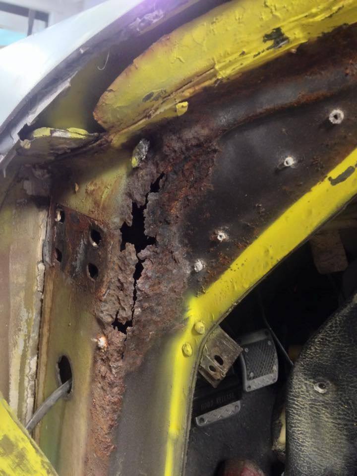

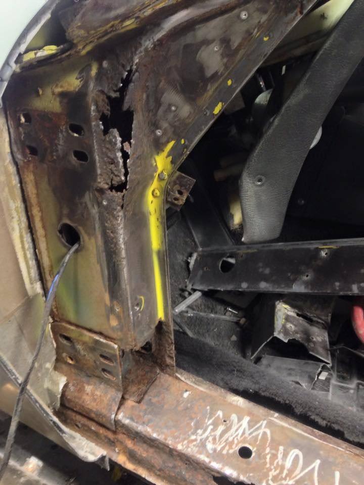

Looks like you have evidence of rust in the windshield frame of your bird cage on both sides. More on the right and it looks like part of the frame closest to the windshield is ate up pretty badly. That's where the water gets in and follows the channel down to your number 2 body mounts. How is the area around the trim tag and the same area on the passenger side? It's another area to look at for signs of rust in the bird cage. Before I found my 77, I looked at a lot of cars that had issues just like yours and passed them up. Hopefully, you can save yours and it won't cost you that much money.
