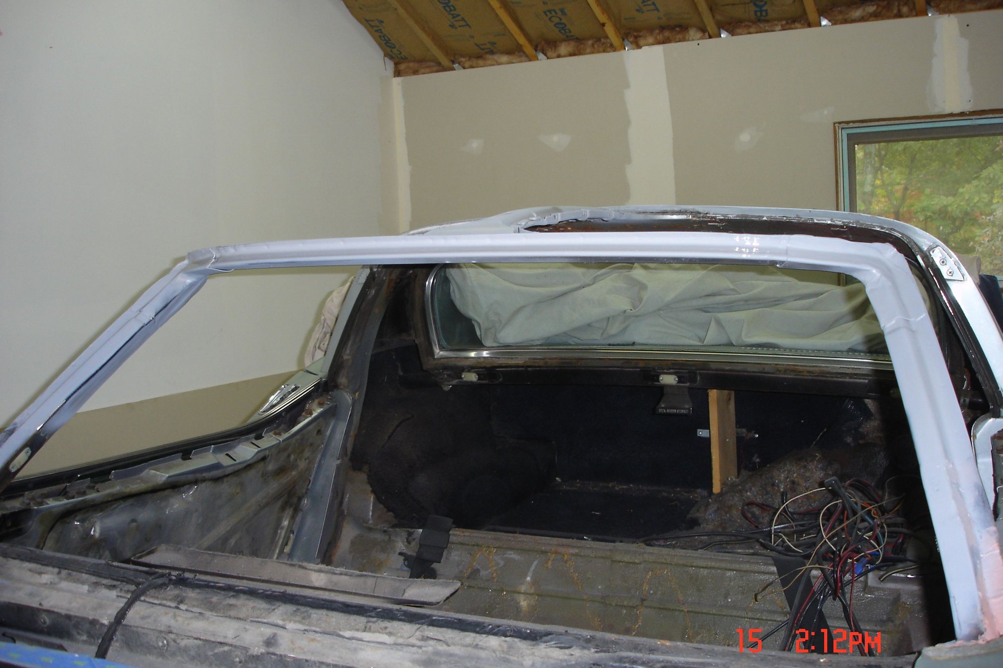

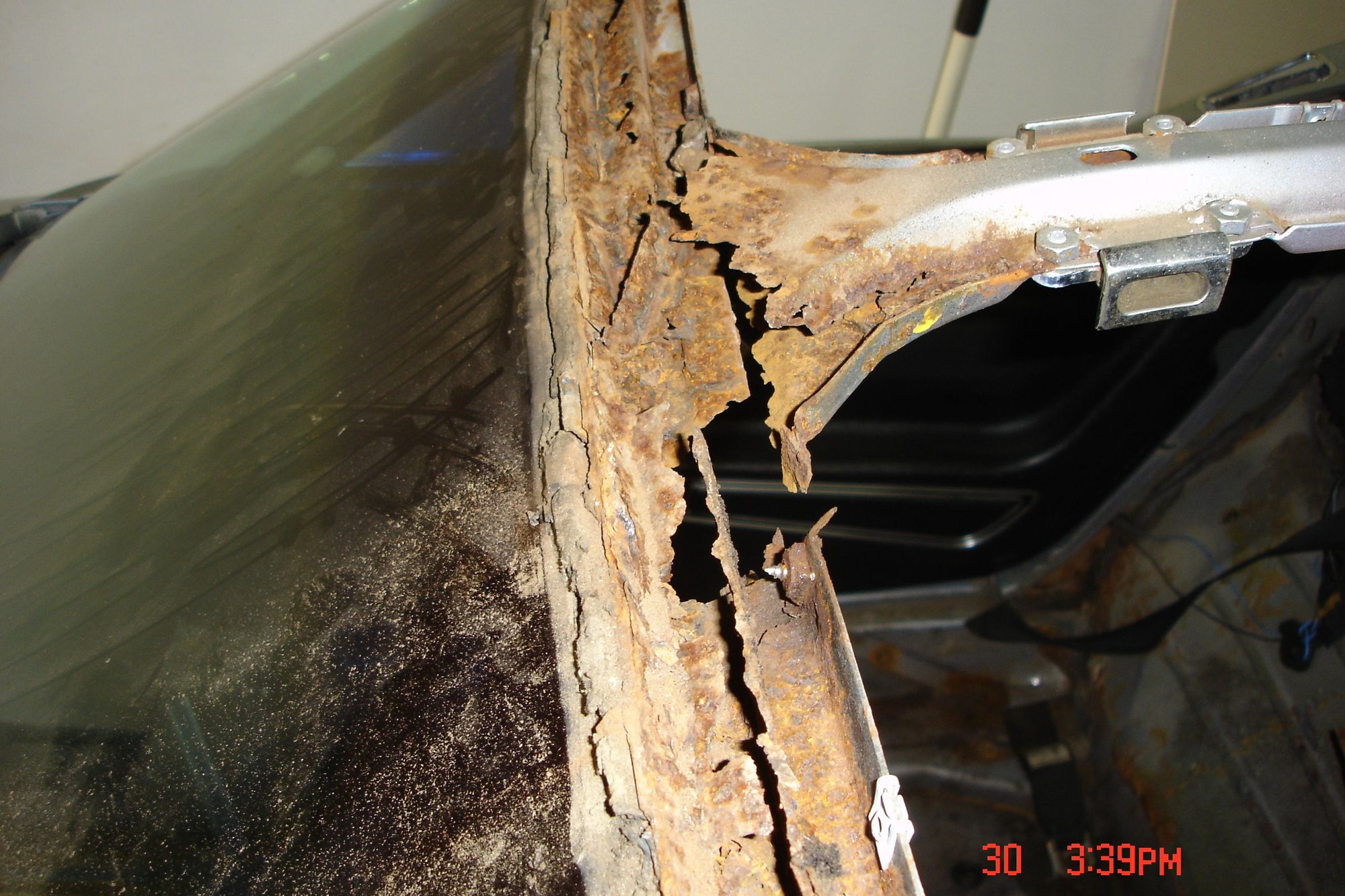

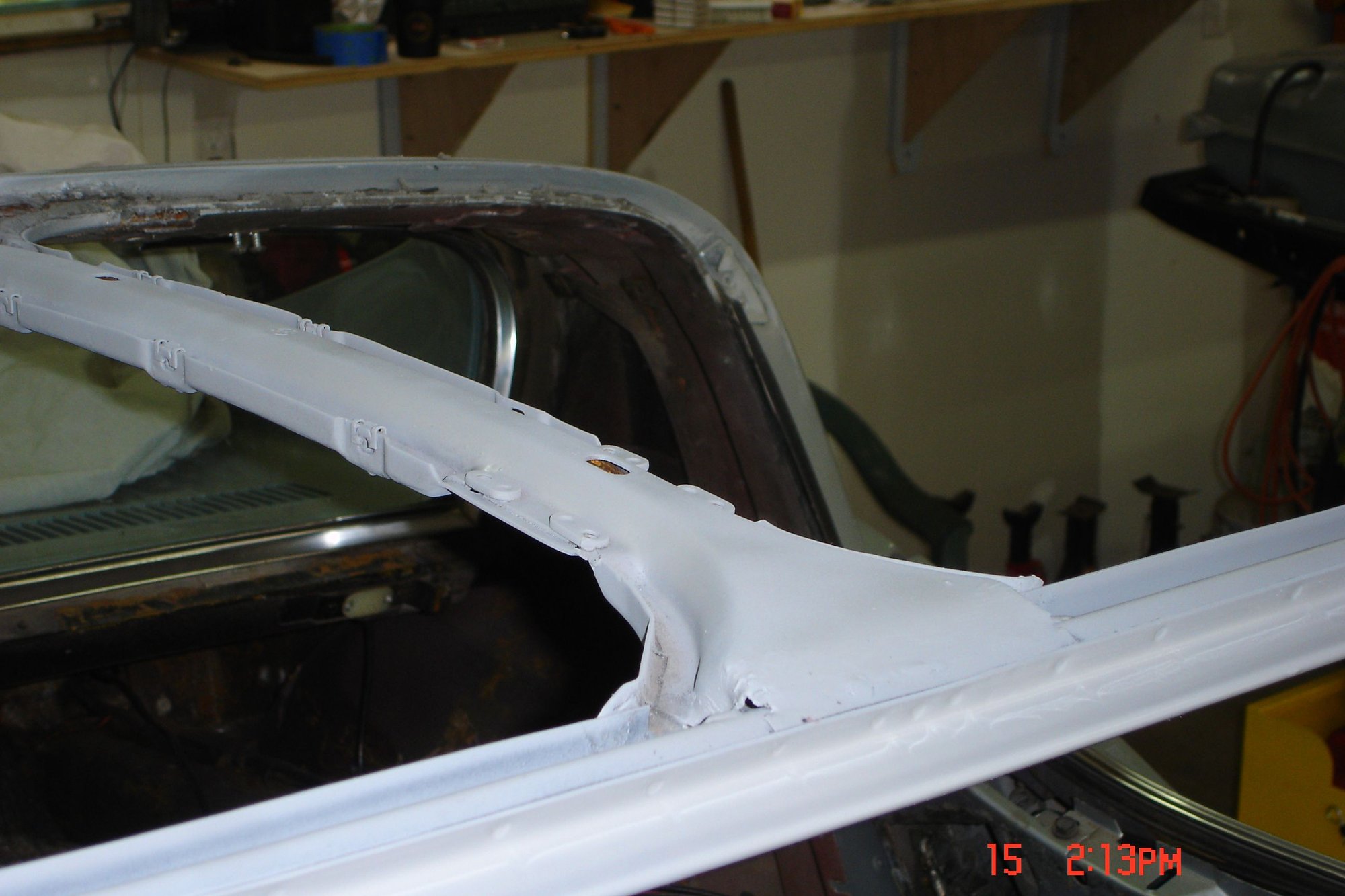

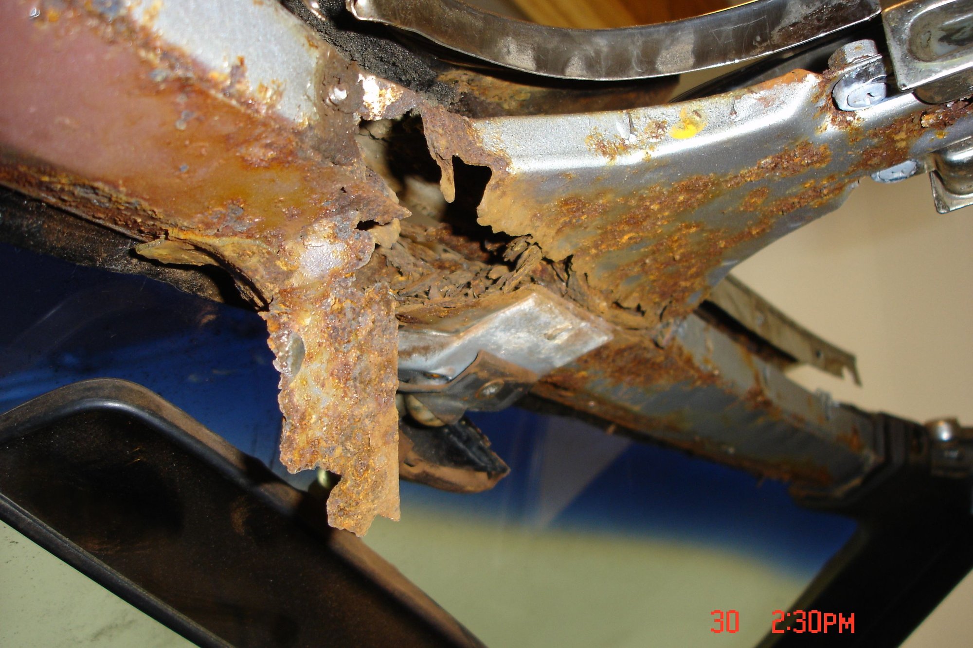

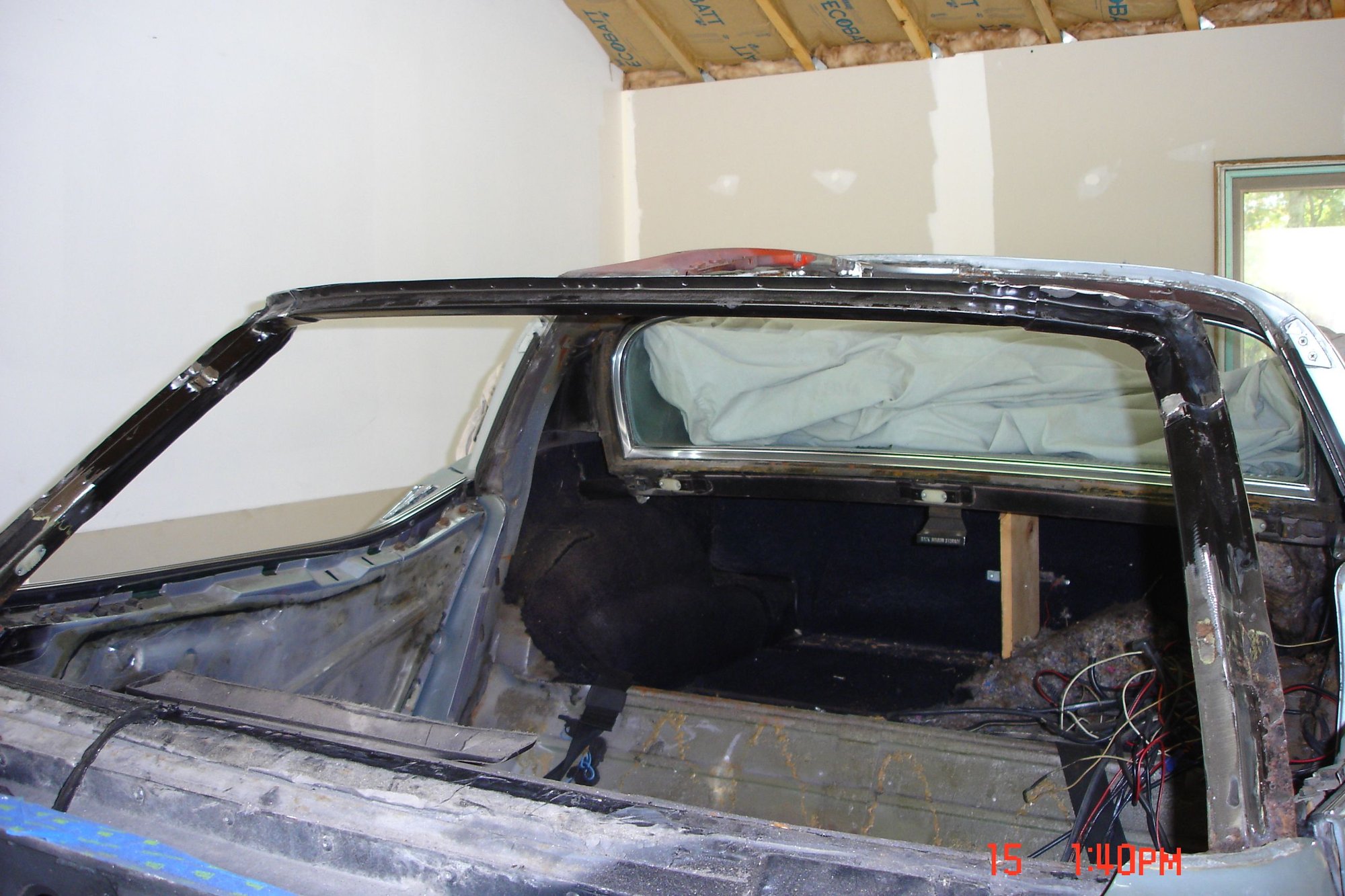

Hey Jim my car looked great until I started removing things. I had a real surprise when I removed the T top trim and windshield trim. It was a mess but I had no choice but to fix it all and move on.
r
I truly hope you have nothing like I had!

Man that looks like a pain to do. I'm glad mine wasn't that bad up top!

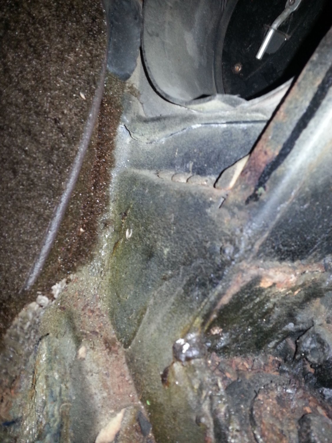

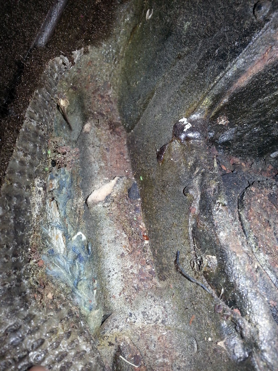

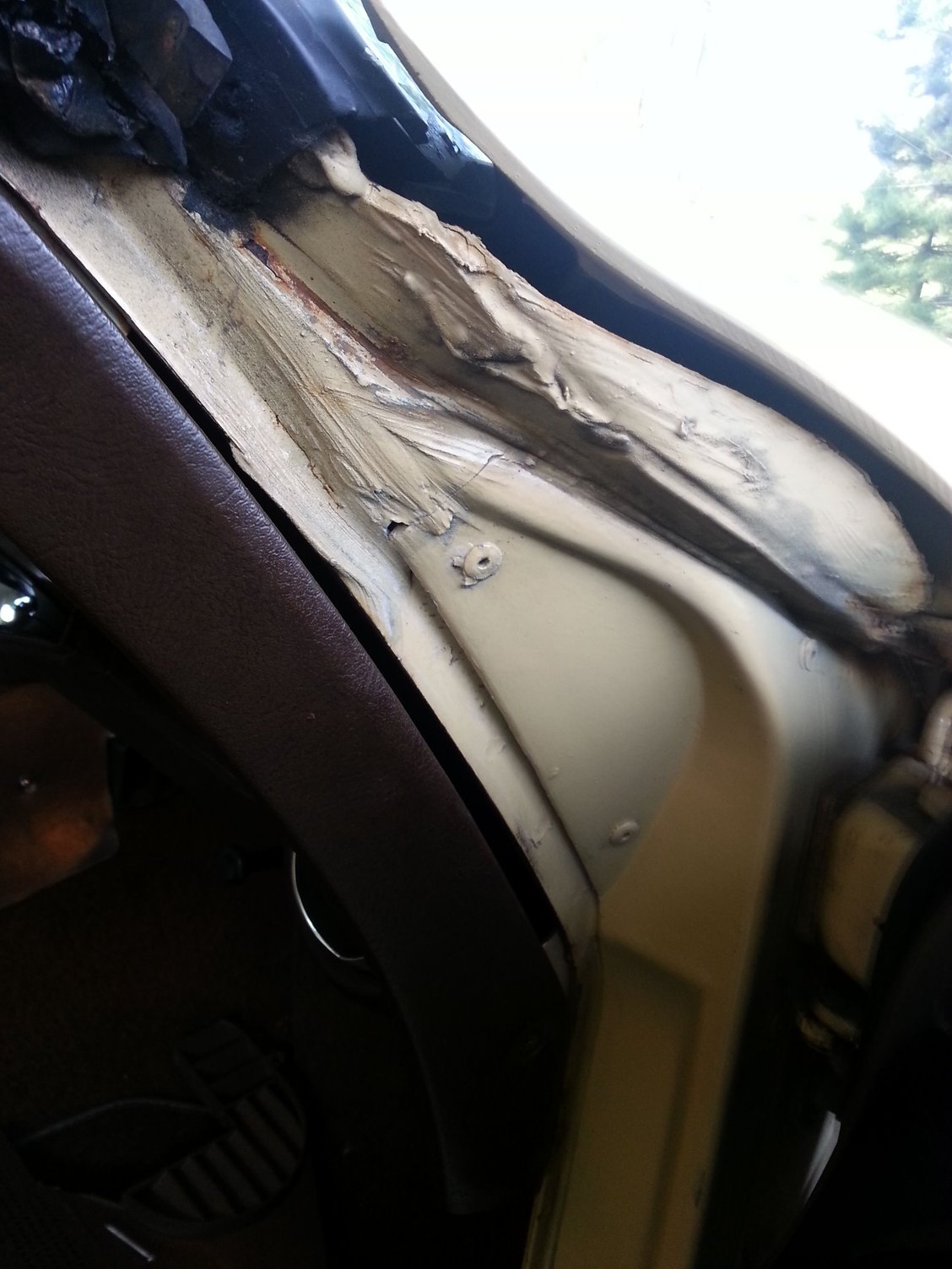

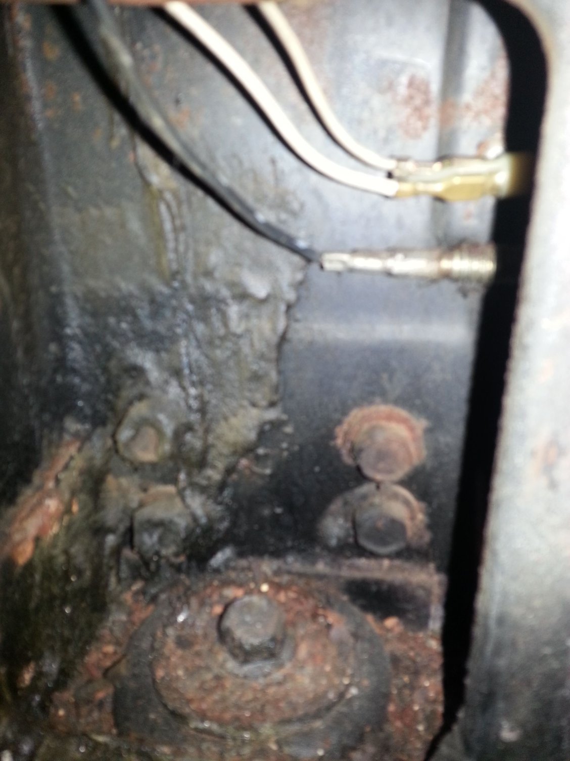

Thanks for all the info and comments. Below are some more pictures I took, but now I can't get the screw back in the passenger side kick panel. The screw goes in fine without the panel in place. Perhaps that is why there is no screw on the drivers side.
Some of the stuff that looks like rust I think is adhesive and padding material.
Passenger side
Only picture today from drivers side.

Yeah, they can be frustrating to get back in. I've used an awl to locate the hole, center the hole in the kick panel over the hole in the body. helped when reinstalling that screw.
Perfect! Only took a couple of minutes that way. I was too high from the actual screw location.

Wow, you really had some bad rust.

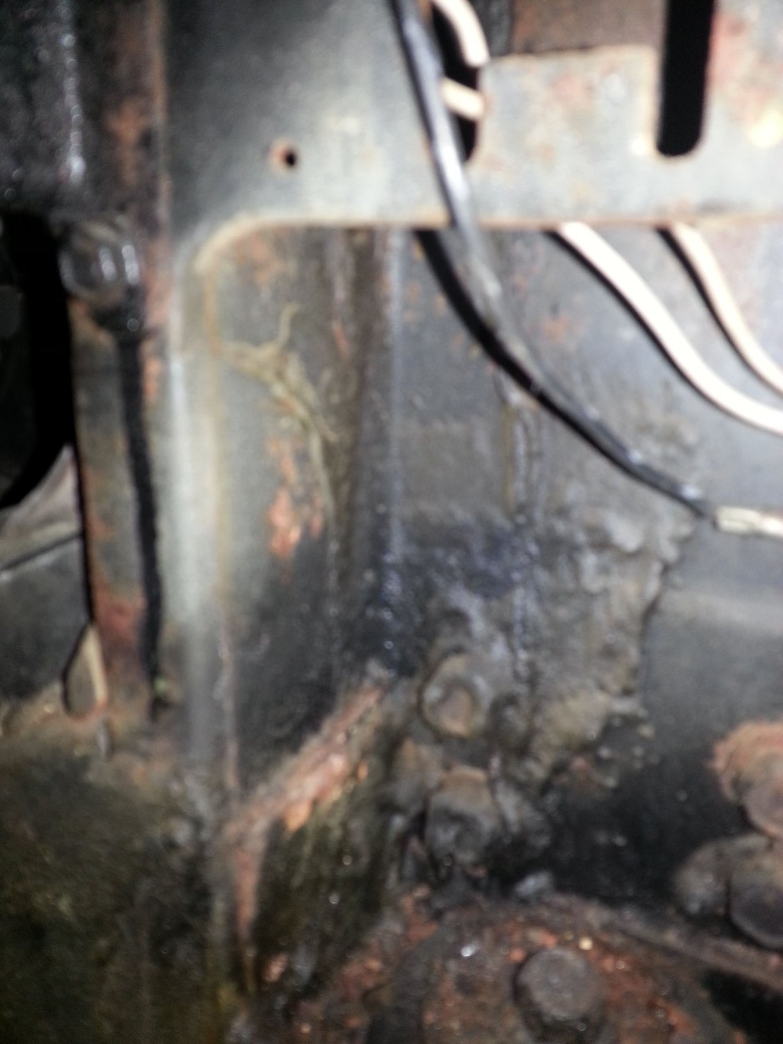

Jim, my car had more rust in the body mounts than yours did.
A wire wheel is going to be your friend. I went hard at the body mount areas and cleaned them up. Painted them with a rust paint and drowned them in oil. Same as the bird cage. Mine was similar. I wire wheeled all the surface rust off, coated them with rust paint and shot rust oil spray down any hole I could find.
Obviously the best way to fix this is a frame off. But I want to enjoy my car as I work on it. Maybe down the road...10 years or so, I may take the body off. But for now I will work on the mechanical issues.
Get your mechanics opinion but don't give up. A lot of elbow grease and a wire wheel will make the car look good.

Currently the biggest issue appears to be the kickup area of the frame on both sides. Thanks for the tips on cleaning things up.
I think if I don't find major rust in other parts of the frame I may have those repaired and then lift the body 1 side at a time to replace the body bushings and inspect for any hidden frame rust. If I find a number of bad sections there may be no other option other than a frame off.
