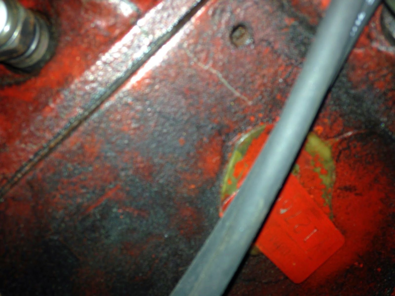

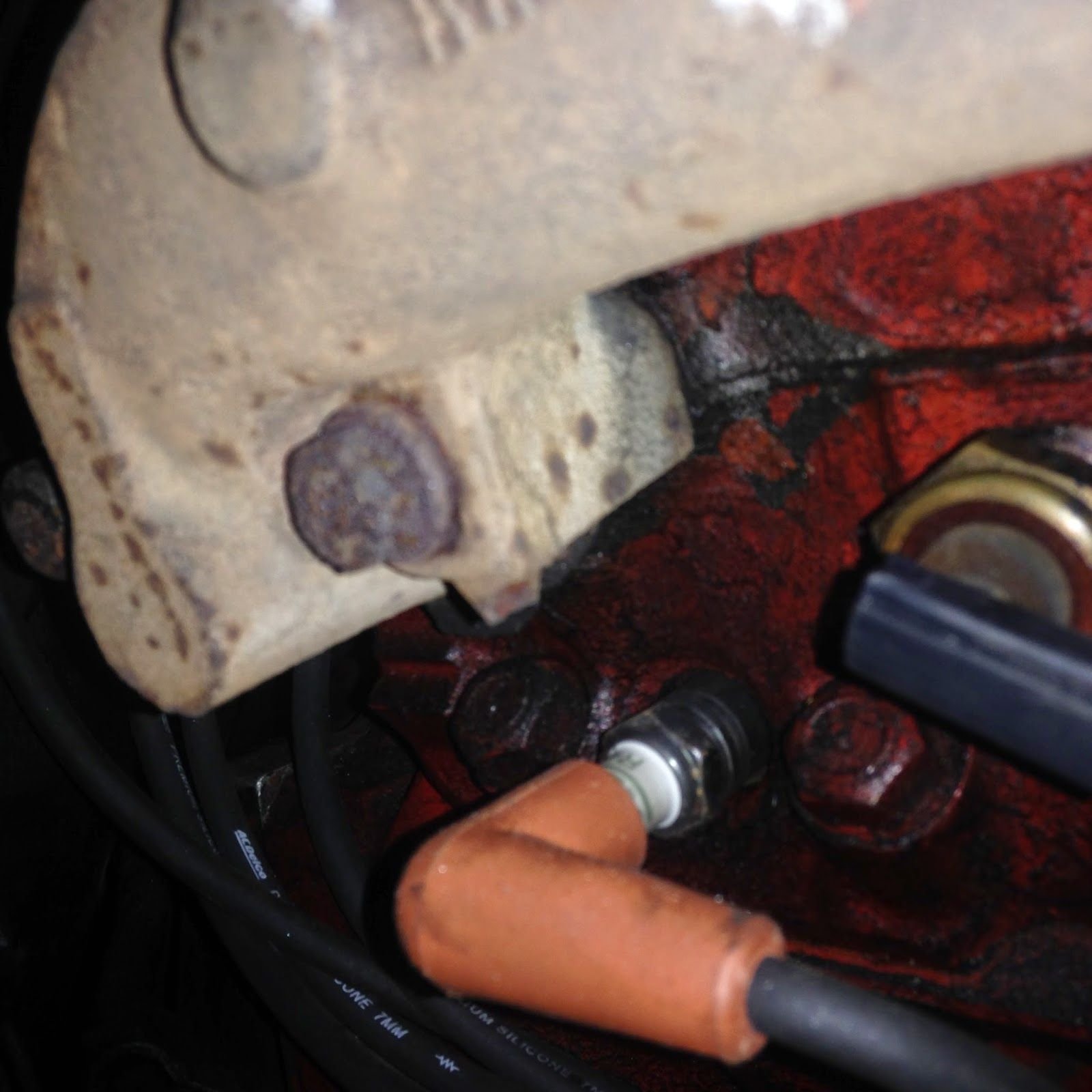

Here is a pic of what I think is the temp sender unit....It's on the passenger side of the block....It's not the original engine it has this remanufactured metal place siliconed to the block on the drivers side.
I think I'm losing coolant somewhere....I checked the oil and it's not milky looking....I don't see any puddles under the car either....It runs good.

That pic of your sender in the right bank is a sender but I believe that one was for the emission ignition system, I forget the name of it, I eliminated it anyway. There was originally 2 senders on my 72, one in the left head, guage. One in the rt head for that emission system.

the sender usually screws into the cylinder head not the block. If you have milky looking oil you may have a blown head gasket or cracked head do not continue driving the car or you may end up with bearing damage.

I checked the oil again and it is not milky.... The sending unit is on the passenger side head not the block.....I need to be more careful with what I type.
