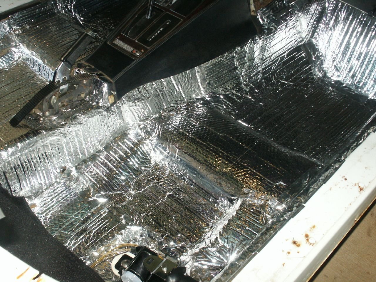

If any of you guys that have recently swapped carpet have any pictures of the area under the seats the area with the plastic where the lap belt comes out could you post them something appears missing on my car

From: West Monroe Louisiana
I have these when restoring my 73. Don't know if yours are the same.
Donnie
Old Jun 17, 2015 | 12:30 PM
danh77's Avatar
danh77
Joined: Jul 2014
Posts: 570
Likes: 65
From: Sebastian,FL
Not exactly the same but the next to last pic showed what I don't find. I guess it must be some type of seatbelt retainer. I know the pieces for the t top straps to hold were missing and another member helped me with that item, I guess there called footmans loops, so the missing piece on mine looks the same as those I guess just bigger. I really hate chasing behind someone else's handy work, who apparently felt it was easier to throw out items then just put it back how it was. I've got all the bolts out but the two holding the retractors which I can see now original carpet underneath as when whoever put the house carpet that's in there now must not have been able to get loose so they just cut large holes in there carpet and set it around the retractor. Oh well the joys of an older car, thanks for the help
