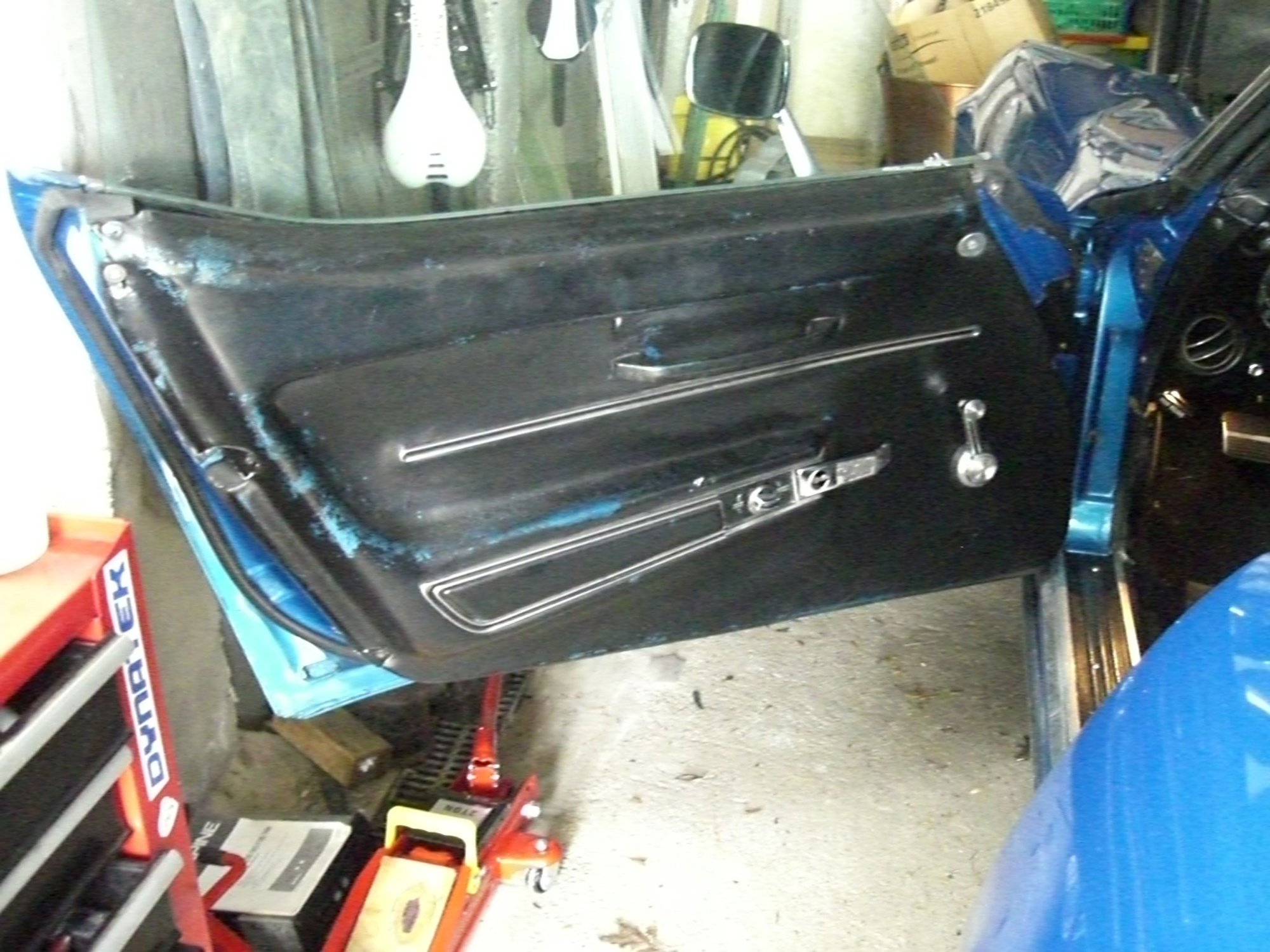

Worked for me.
Old door trim, '68 panel fitted to '70
New panel

Thanks that's what I was hoping for.
