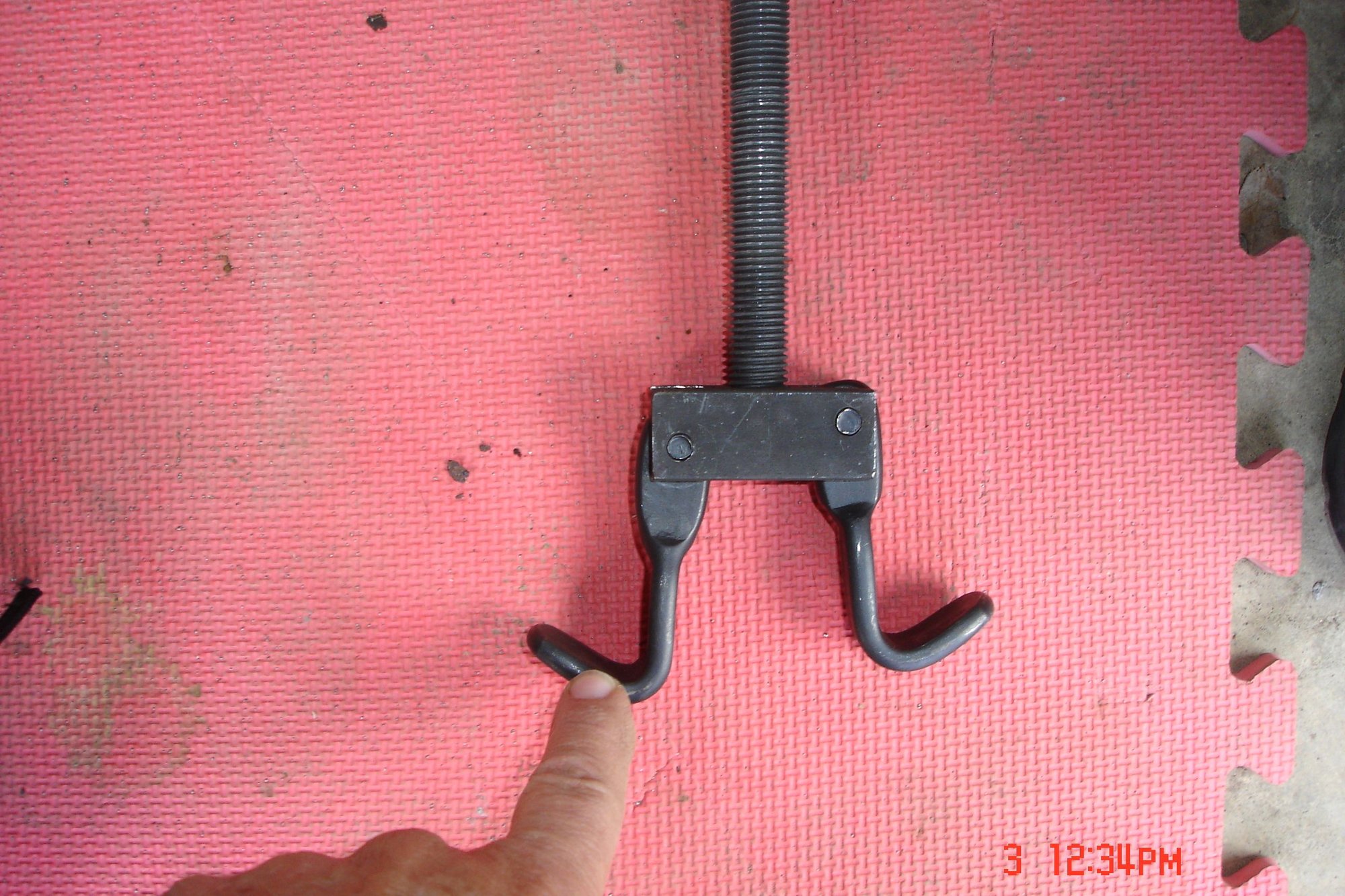

I bought a 5/8 20 rod from Ace ... mated it with the OEM spring compressor "grabbers" (rented from Autozone)....
I ran the threaded rod through the upper tower and through the spring.
I grabbed the spring 4 coils from the bottom and compressed the spring as much as I could until the "grabber" interfered with the tower cavity.
The spring still would not interface with the lower control arm..(angled and barely hit the outer edge of the pocket of the lower control arm. The lower arm is attached to the cross member .. in other words the lower arms are fully interfaced except to the ball joints.
What am I doing wrong?? Do I need to compress the spring even more. Is there an easier way .. other than hiring a professional to come over and do the job or buying a shorter spring.

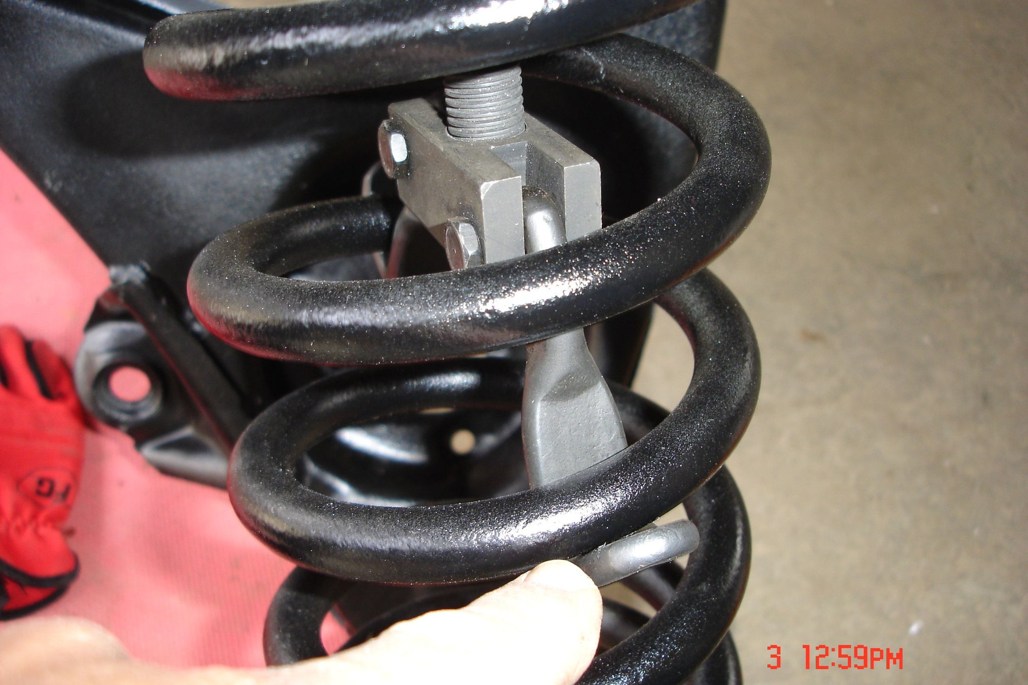

Default You're working too hard
You're working too hard.
I use a standard GM spring compressor.
Using only the threaded rod & washer and just one hook I pull the spring into the upper pocket. Drop the threaded rod down the shock tower and place the single hook midway down the spring and facing toward the A-arm. When compressed this causes the spring to arc toward the A-arm. Once the bottom of the spring is high enough you can swing the lower arm into position with no trouble at all. Place a jack under the A-arm and install your steering knuckle.
Using just one hook on the inside facing the A-arm
Rotate the spring so the lower tip will seat correctly in the bottom of the pocket then compress the spring from the top.
As you compress the spring it will arc toward the A-arm
Once you have it high enough the A-arm will EASILY raise up over the spring
This allows you to check the drain hole and lower spring placement
One hand - no kicking, pushing, hammering to get the spring into the pocket.
At this point simply slide a jack underneath and raise it up until you can mount your knuckle.

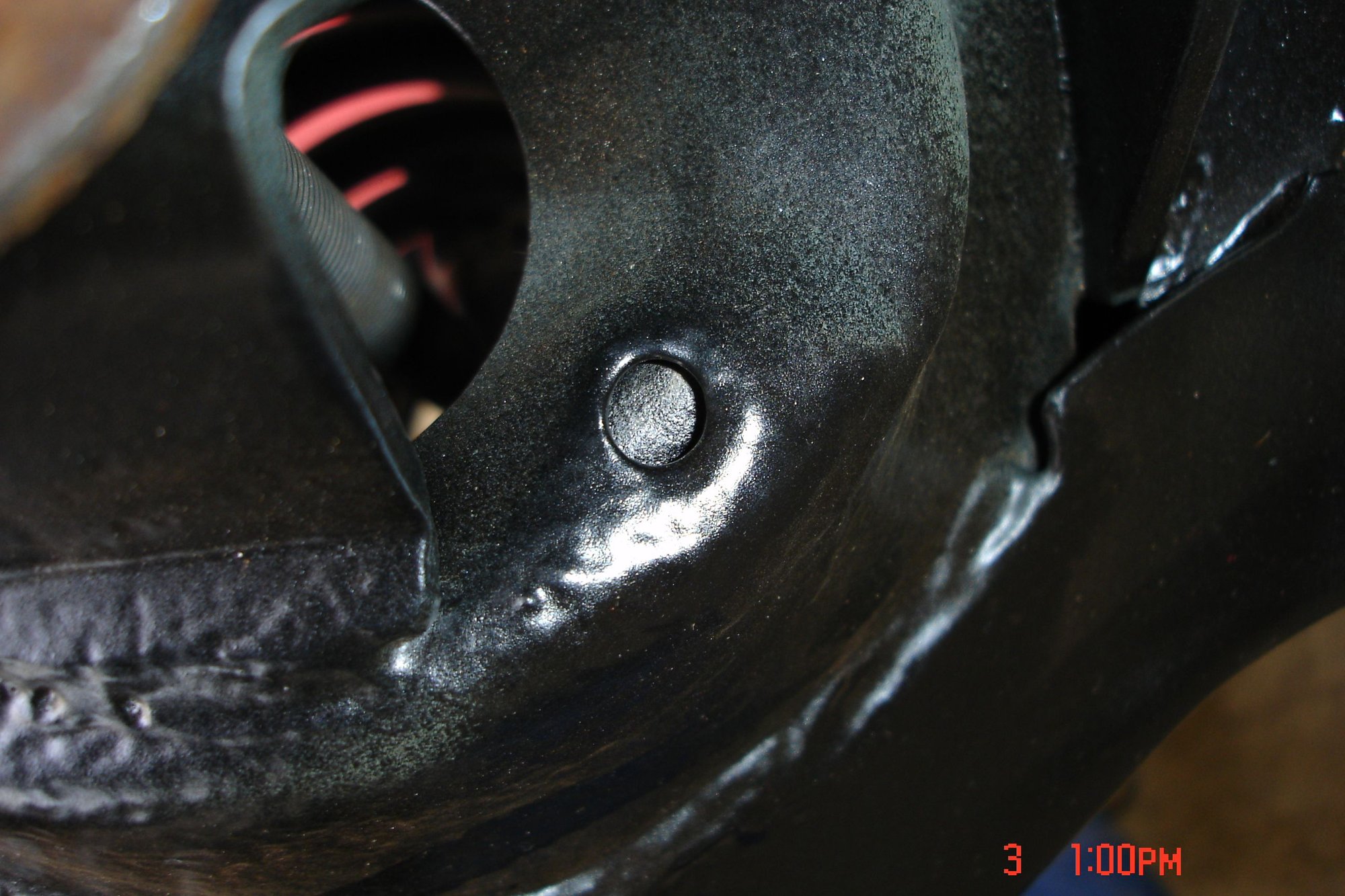

Let me add, when you are doing this make sure to align the spring using the hole in the frame pocket. The control arm hole is just a drain hole. The edge of the spring should be just into the alignment hole in the frame. I used a small screw driver and turned the spring till it hit it. The edge should cover about 1/3-1/2 of that hole.

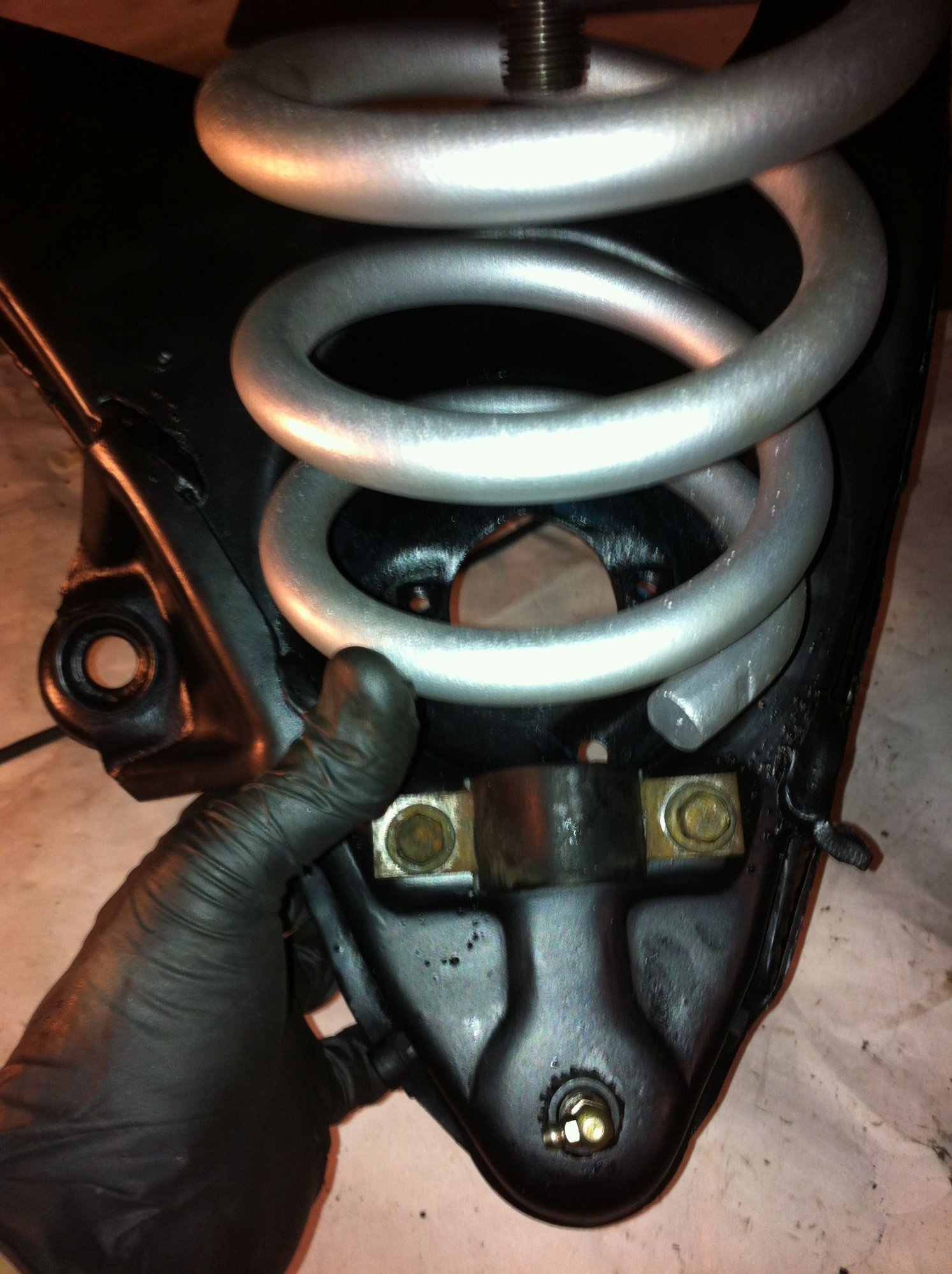

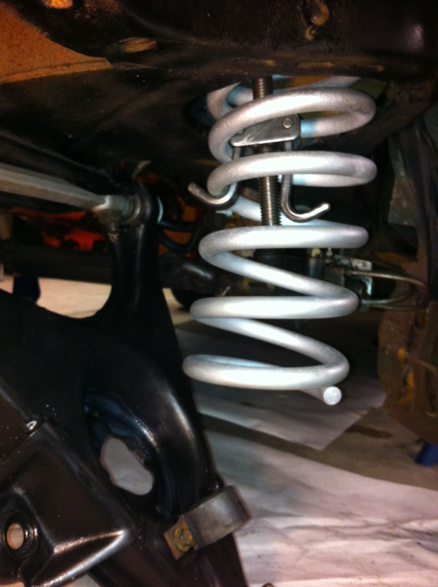

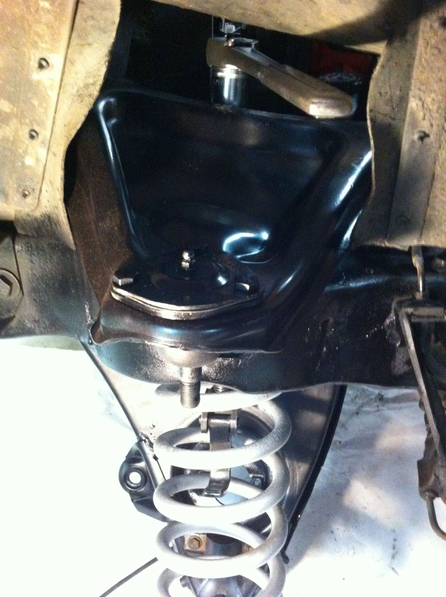

I have my method that has worked well. I use the same type of spring compressor as seen in the above photos. I place the threaded block and hooks as high on the coils as possible just before the frame pocket. I the place the slide block on the outside of the lower "A" arm with a pully between the the slide block and a arm with the screw shaft going through the shock hole the treading to the upper block. This clamps and compress the spring to the lower A arm. I remove the lower A arm and spring compressed together. Installing in the reverse. Compressing the spring to the lower A arm allows for easy setting into the lower A arm pocket. Reattach the a arm to the from first with spring in packet (strait up) then connect the lower ball joint to spindle. Upper is already attached before this. I have never had s problem with this method. I use an old pully with a large enough hole for the shaft. Any thing thick enough will work (large washers,steel plate) just any thing that will prevent the sliding block from pulling through and damaging the shock hole.
Thanks Hammerhead ... That's a neat trick .. grabbing the spring with just one hook. BRILLIANT!! seriously .. thank you very much.
Thanks for the input sigforty ...Good points ... Do you have stock springs?
Wow! Very cool Monkey Man..I understand what you did. There's more than one way to skin a turkey.
