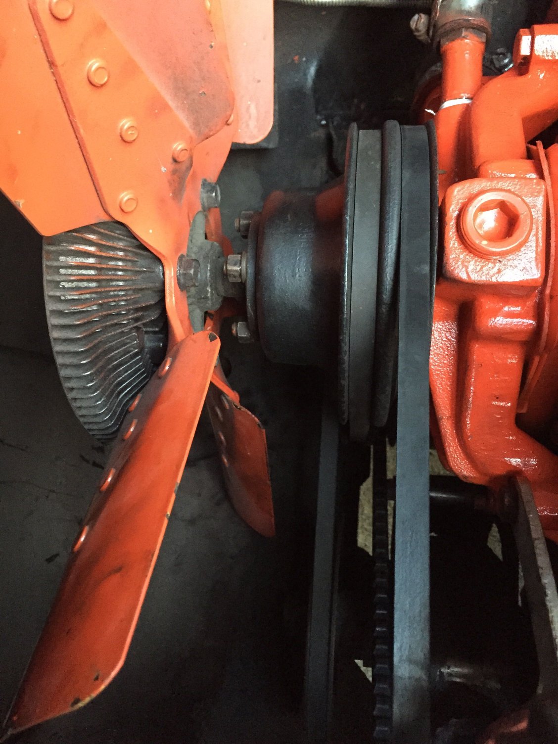

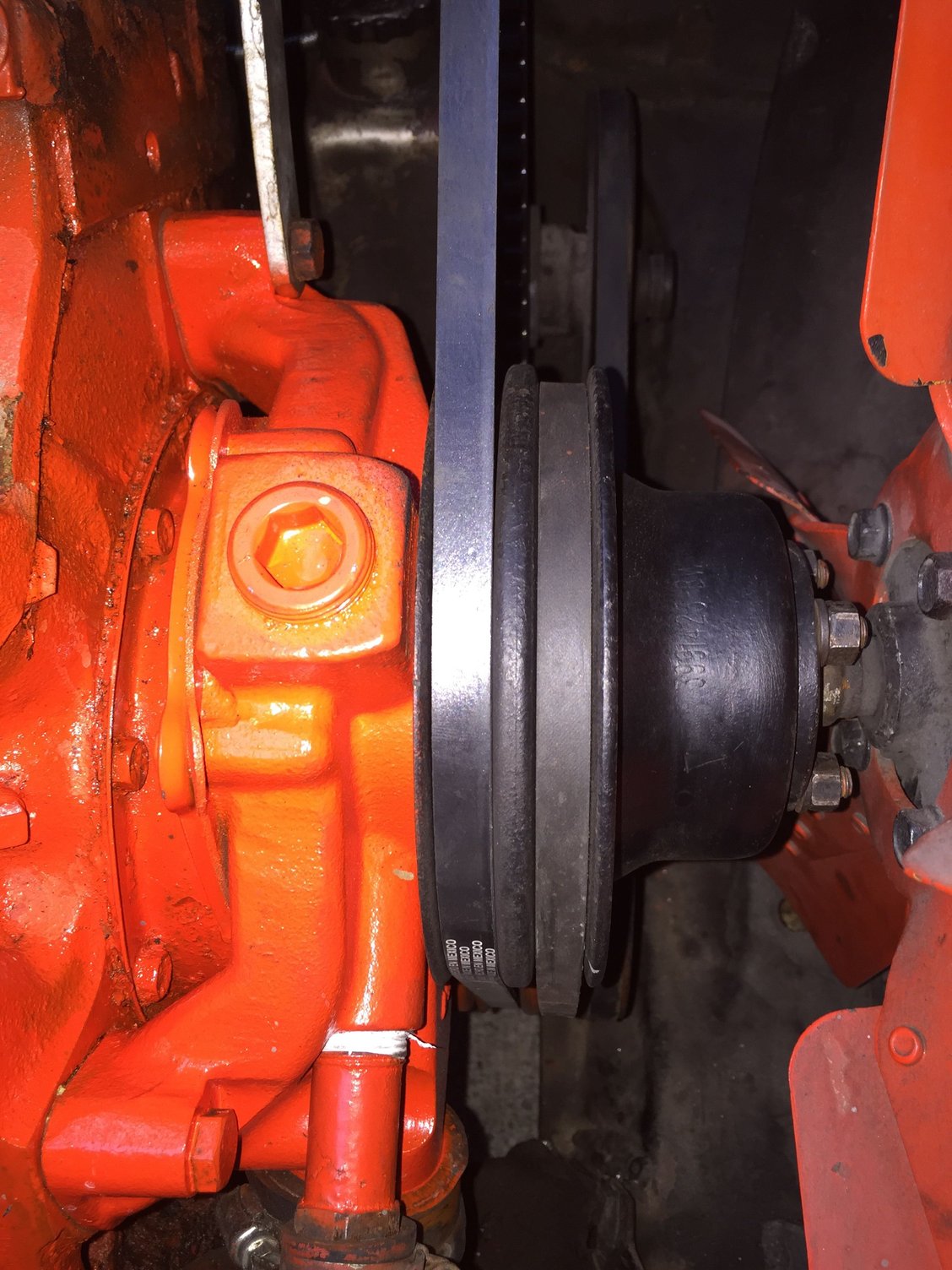

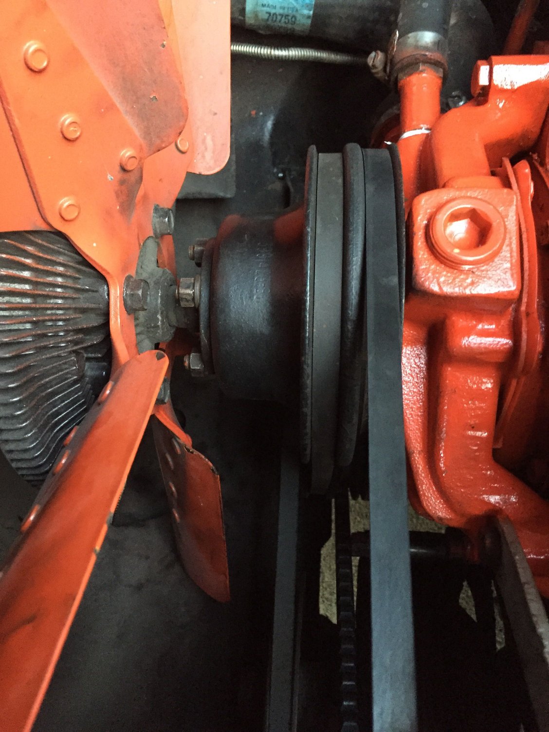

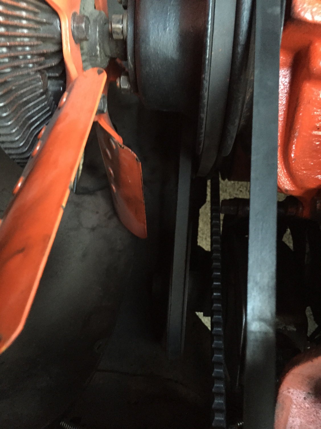

It's kind of hard to tell from the pictures, but it looks like the alternator belt is running to the rear off the water pump pulley.
IT also looks like the belt in the second groove is only going from the crank to the water pump. AFAIK, that short belt was usually in the rear groove.
This page from the AIM is from 1969-AND it's for the 427- it may or may not apply, but it's a good reference. Make sure the crank to water pump belt is not too short- it'll kill your new water pump if it is, and too long will squeal.

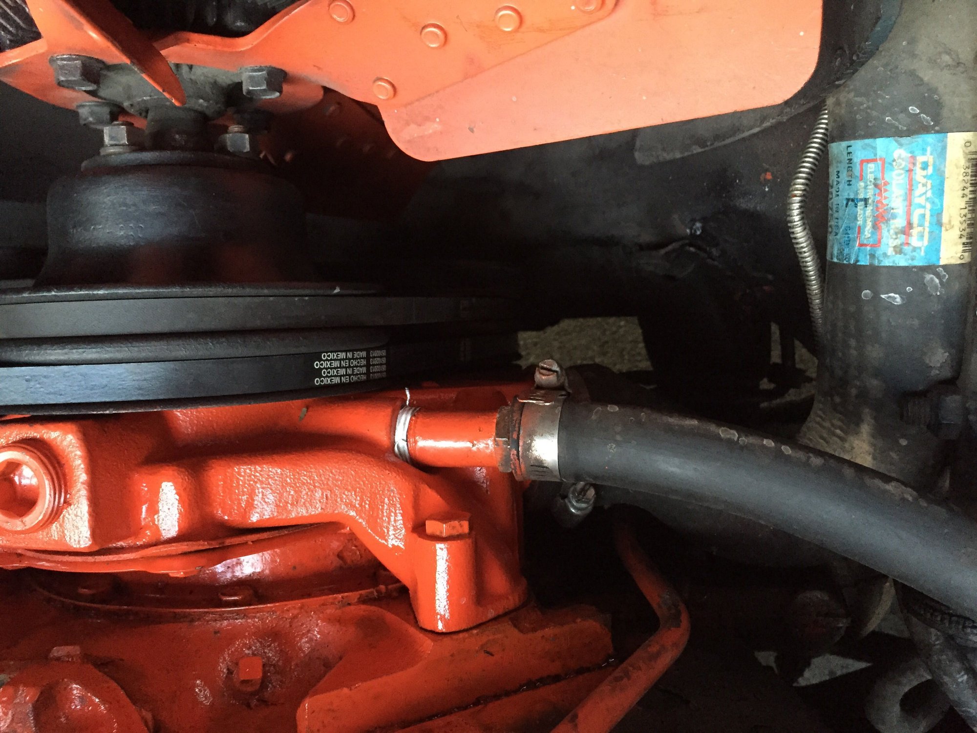

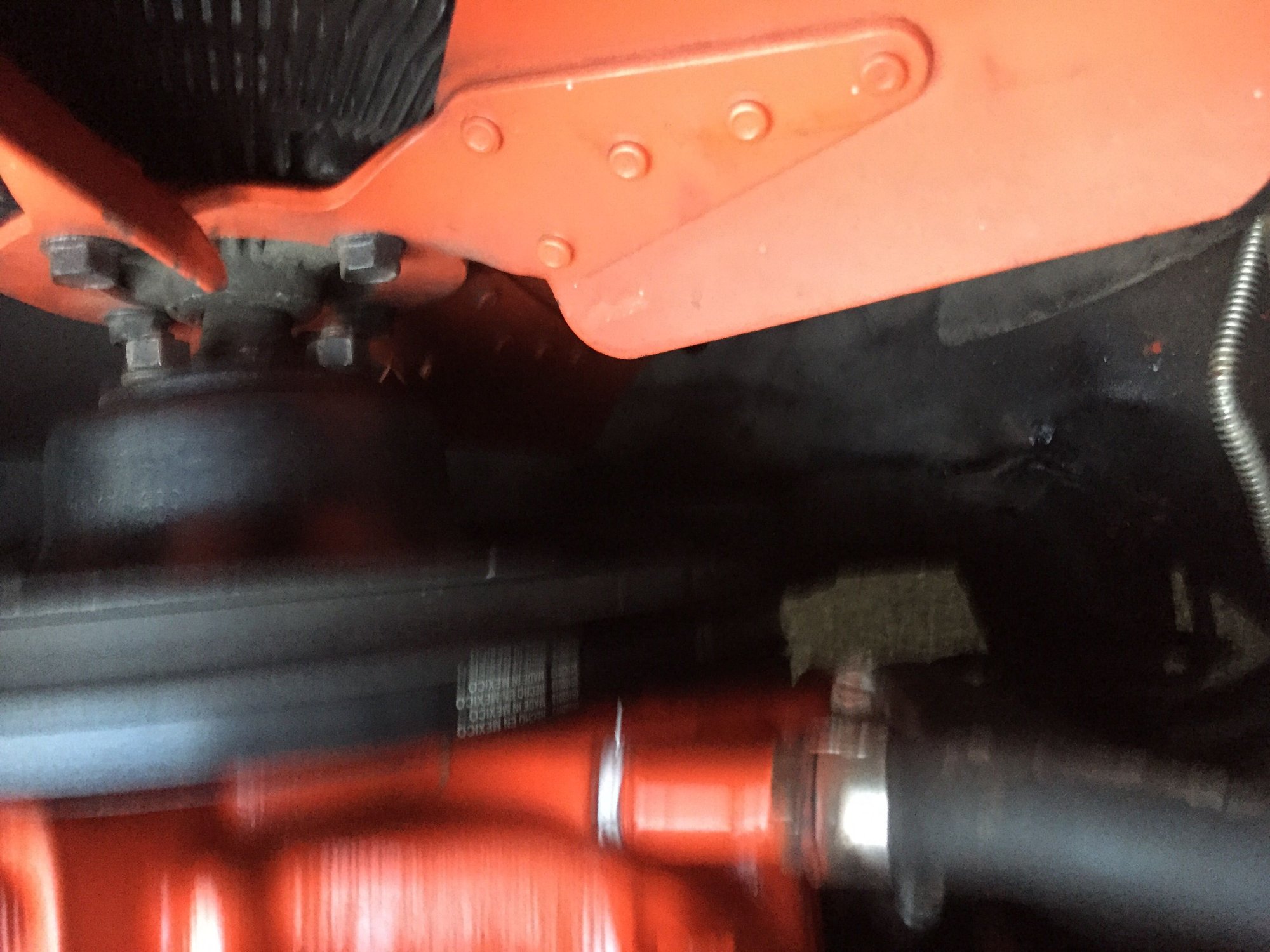

Looks to me like one of the radiator hoses is rubbing on one of the belts. If you turn the steering wheel while at an idle, the engine will 'load' and torque it over a bit...maybe to allow the hose to hit the belt. Turning the wheel either way would do exactly the same thing.
If that proves to be the problem, you likely have some badly worn (or failed) motor mounts.

Thank you. The belts were replaced following the assembly manual's diagram. Also a friend that is a mechanic gave me the approval on the routing as well...
