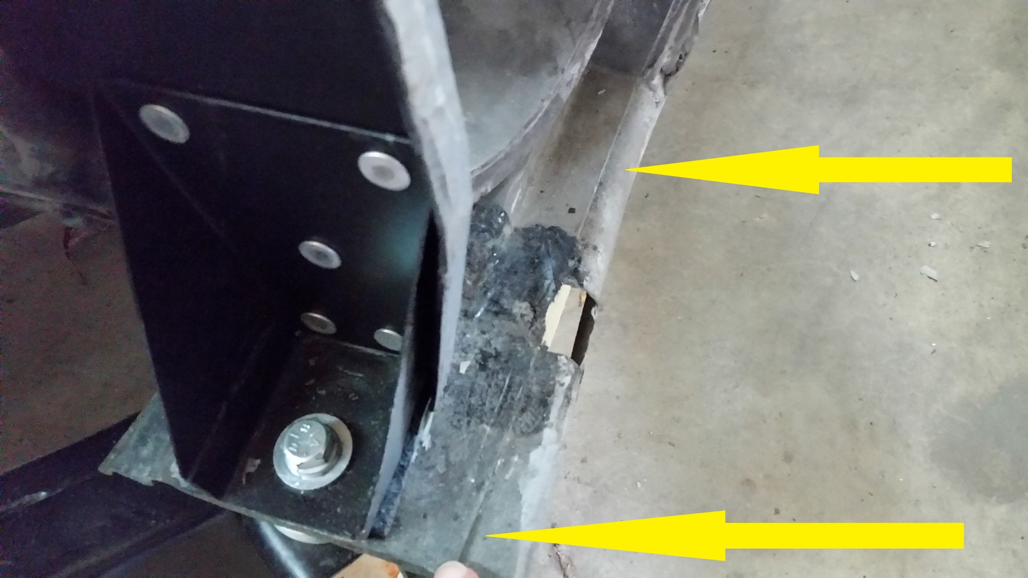

Last night, I was scraping the old filler and adhesive off the car and clip and came across a couple questions.
First, on the driver's side, should there be a flange for bonding on the lower front and bottom edge of this box?
Second, on the passenger's side, the clip didn't contact the front flange, so there was just some fiberglass cloth connecting the box to the clip. How should it be?

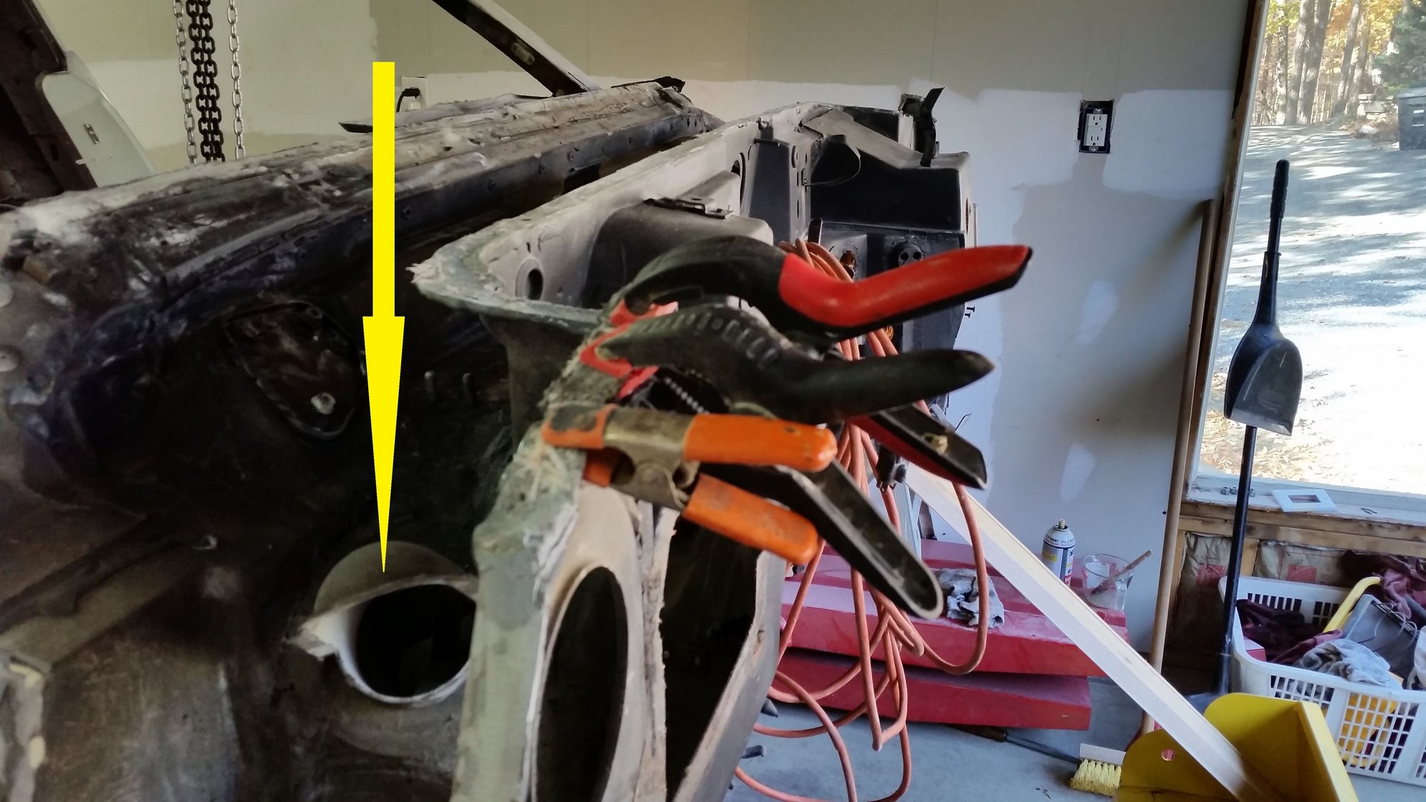

YES
That cloth needs to come off. And when you set-up the front clip...you will be able to look inside the wheel housing and see that lower bond area.
I can say that on the left side....the aluminum tubing that has been rigged up to put air in the cabin is WRONG and DANGEROUS. That aluminum duct tubing should NOT be drawing air from the engine compartment.....it should be like the RIGHT SIDE..and drawing air in from the COWL.....which is sealed off from the engine compartment VIA the hood weatherstrip. Because...allowing engine air to go into the cabin can also allow exhaust gases to go into the cabin also....which is NOT GOOD. Just 'saying'.

DUB,
Thanks for the tip. They had the inlet pulling air from under the car, but I pulled the whole thing and glassed in the big hole they'd cut.

Here's a picture of the air supply that would replace the metal tubing. They are screwed and sealed to the firewall cowl. Not sure what you are going for stock or resto.
ZIO
I have 2 from my donor if you want them. Another picture of the lower plenum bonding pieces that you need to bond the bottom of the clip.
on the driver's side, should there be a flange for bonding on the lower front and bottom edge of this box?..... How should it be?
I hope I`m not too late to this party.... and I hope this helps. At the bottom, there is a sort of ledge, then it turns down to form the bonding area. There is also a notch in it to drain water from the cowl area...(see the hole just below the air vent flap). You can see that I still have to finish grinding off the remnants of the old fender in the bottom left. Both sides are the same in this area.

Originally Posted by oldgto
I hope I`m not too late to this party.... and I hope this helps. At the bottom, there is a sort of ledge, then it turns down to form the bonding area. There is also a notch in it to drain water from the cowl area. You can see that I still have to finish grinding off the remnants of the old fender in the bottom left. Both sides are the same in this area.
Never to late oldgto, the more the merrier! Hey do you still have the positive battery cable in the car and is the car like in the picture. I need a picture of how that cable runs and how sharp the bend is by the shifter.
ZIO
I have the little inlet you showed. That's extremely cool to offer, though!
Did you build up that lip? It looks like the front edge is different. That's one (of about a hundred...) things I need to figure out how to do.
That's exactly the picture I've been looking for. Thanks!

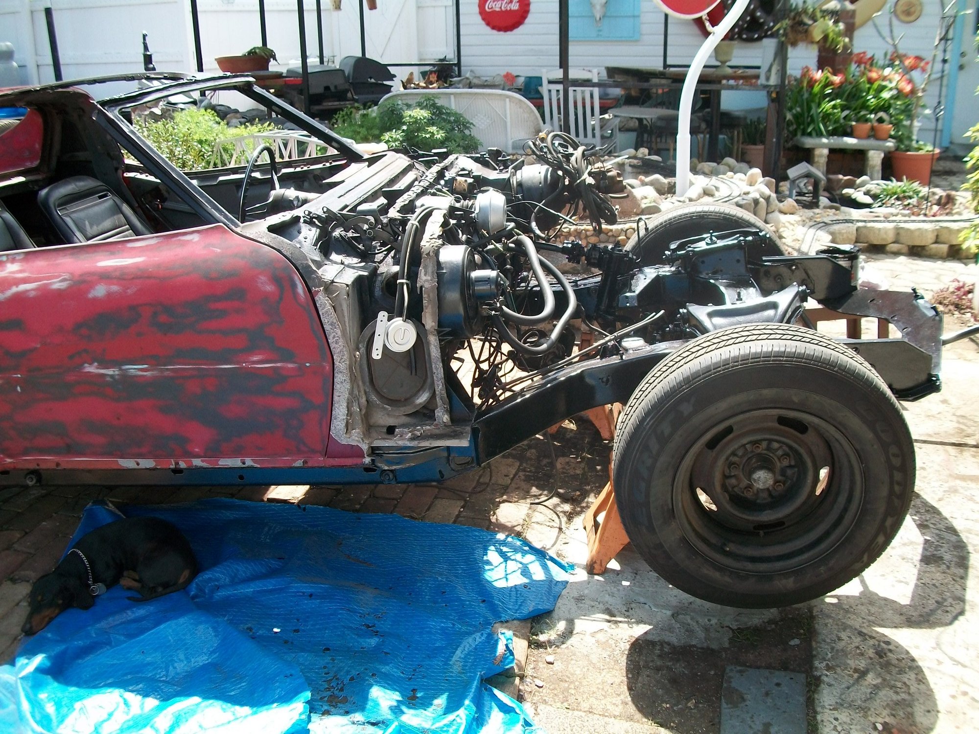

Just for fun, here's a few C1, C2 I ran across today. There were 3 absolutely gorgeous C3's there, too, but I missed the photo ops.
Hi E.Murray, yes the car had an Eckler front clip. I wanted to try and make the car as original as possible so I purchased a 69 donor car where I removed the front clip and installed it on my car. There were a few spots where I had to rebuild the bonding strip along the top and sides. Tedious but doable. Good luck with your project!
