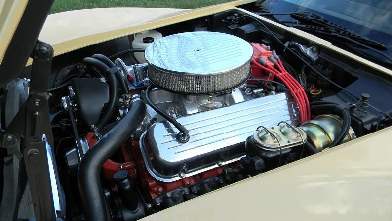

When I did the swap in my 77 a few years ago, to cut down on the cost of the brackets and pulleys I went a different route. Used a long pump and put the alt on the other side. It works well.
