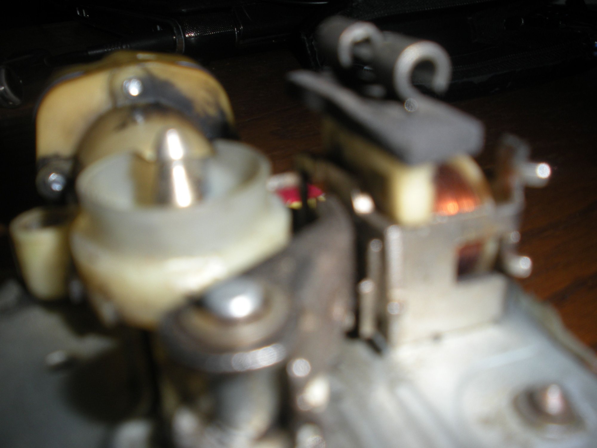

I have a 1970 L46 corvette,replaced wiper washer pump with a new one ,it has these weird connectors protruding from the plastic cover ,i cant find any wires to connect to it.Can somebody help with this.
washer pump ,old one

Those are barrel (sometimes called bullet) connectors

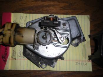

Check out Willcox's site and you will more than likely find the test procedure to check your wiper motor. I know it well...but I can not type it all out for you.
You have to make sure that yoru motor is GROUNDED...This is MUST.
THEN....the red wire coming out of the side of your wiper motor that goes to the switch on the cowl so when the wiper door is raised...it closed the contacts and allows 12 volt to go to this wire is also REQUIRED....but do not forget that the large switch under your steering column that looks like a radio **** is a switch that will stop this 12 volts from getting to the wiper motor.....then....on the 3 wire straight connector at your wiper motor will have 12 volts on the center YELLOW WIRE when you key is ON.....then all it is... is making sure that the outer two terminals switch from ground to no ground in a specific series...which is what the wiper motor needs to operate. Quite simple once you know how it works. Also...you have to have good functioning relay that is located under your shift console to make it work.
