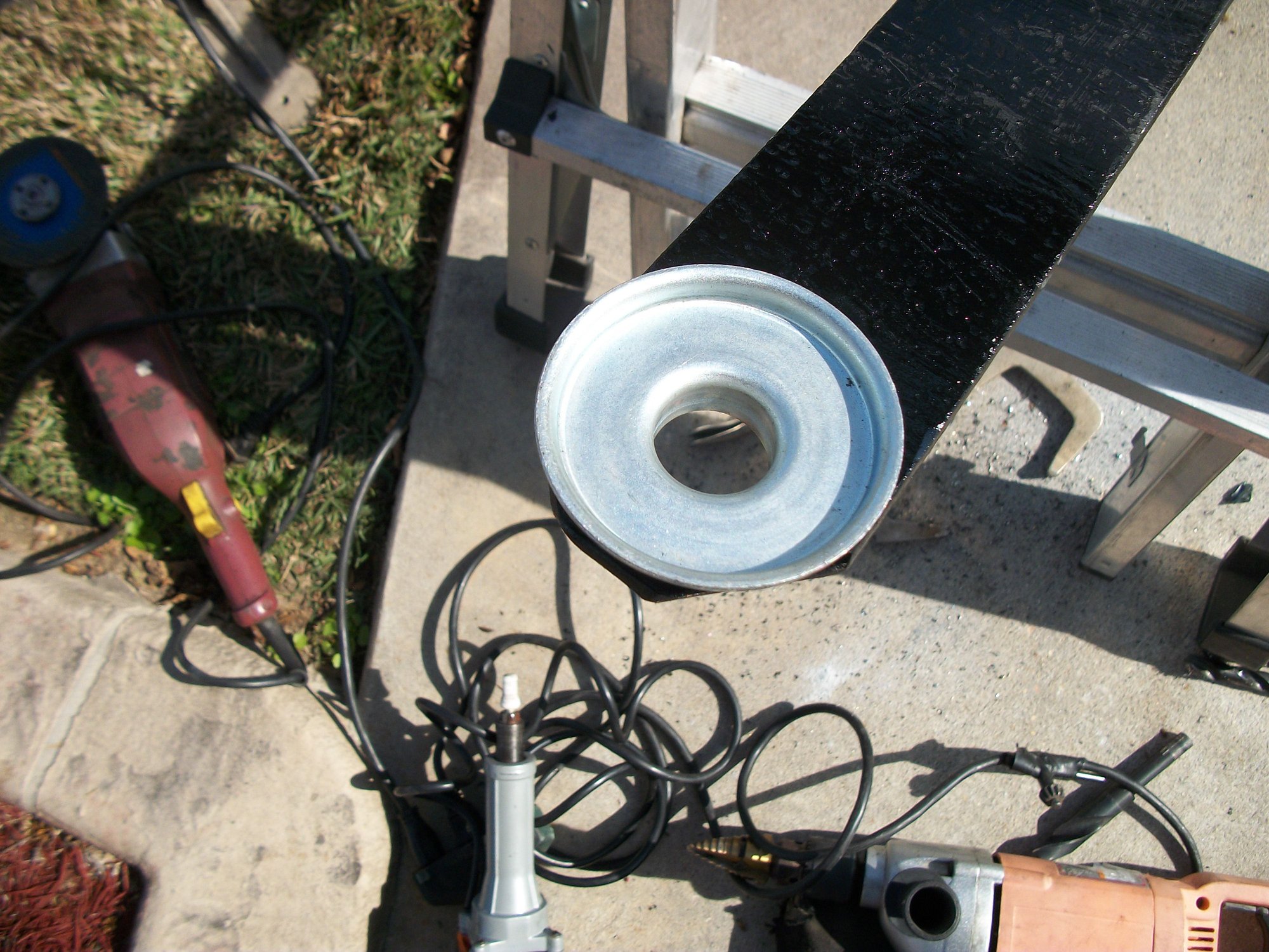

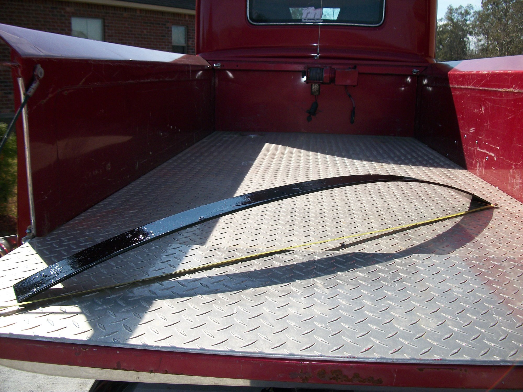

Re-arching is good, but if the main leaf is too fatigued it will droop within a year because of the large holes on the ends of the leaf (unlike other cars with no large holes on the main leaf where re-arching lasts much longer).
I cleaned/painted/re-installed the springpack on my project.......it lasted a year......then the main leaf began to bend upwards at the large holes where the spring bolts went through. I bought a length of spring stee, angled the ends,l and drilled the correct size holes in it/installed it and the suspension is great again...it sits about an inch higher, but I will install longer spring-bolts to lower the body an inch....

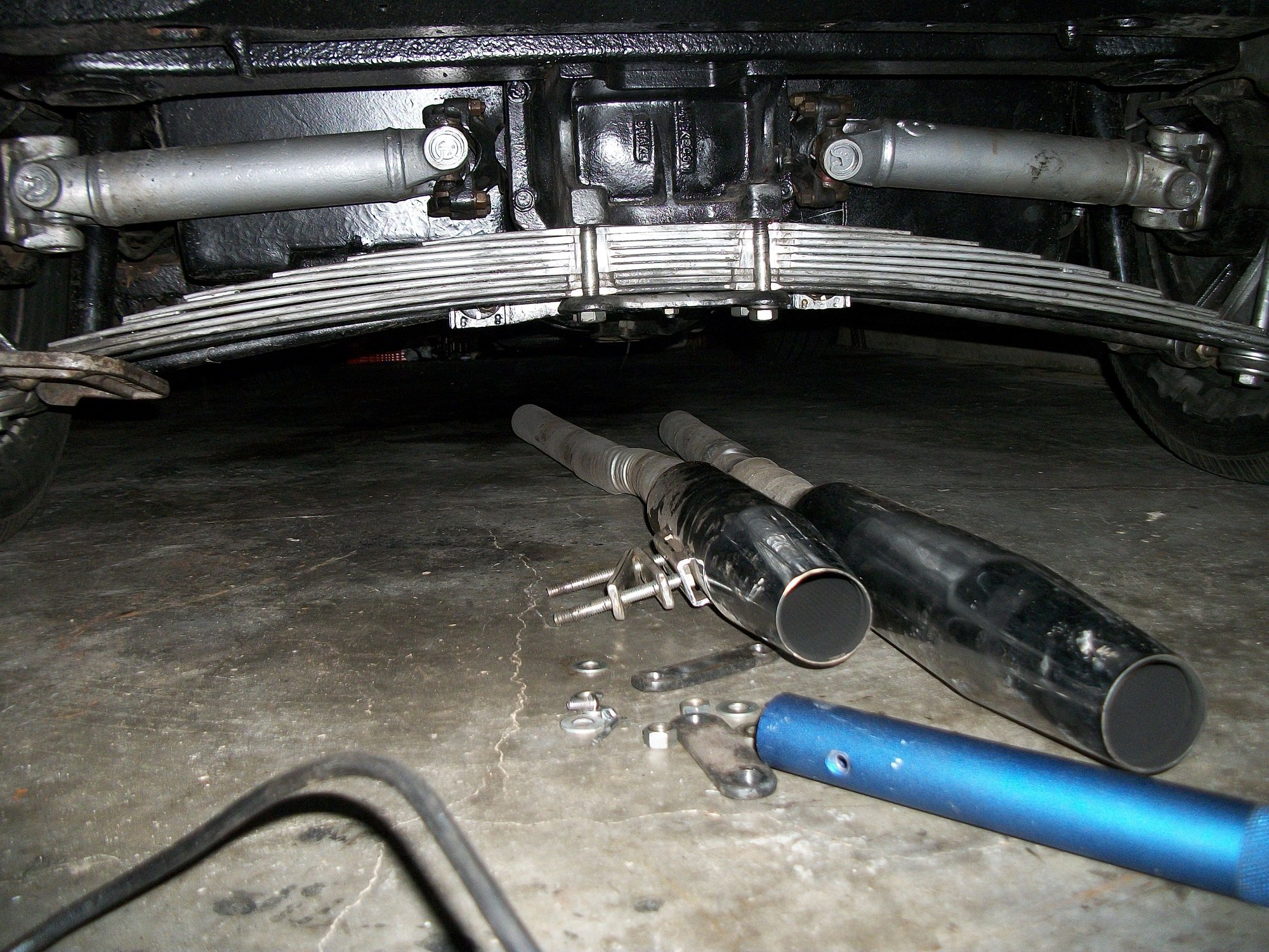

Steel spring installation only!!! AND...whatever you do.....DO NOT....repeat...DO NOT tighten the four bolts for your rear leaf spring to TORQUE SPECS when the rear is UP in the air. YOU MUST torque these four bolts when the weight of the car is flattening out the arc of the spring.....BECAUSE if you don't...you can...and more then likely will break the ear(s) off your rear end cover...and you don't want to do that.
These four bolts can be tightened a bit when you are installing the spring...but do not go crazy on them. This is so you can install the outer spring bolts and cushions.
