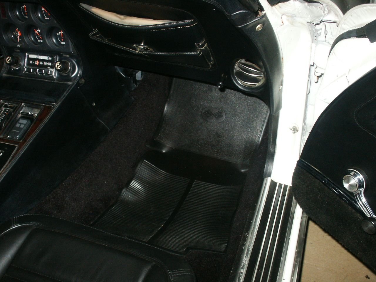

Mooser,
If it will help you to compare, this is the the dash on my 73.
Donnie
