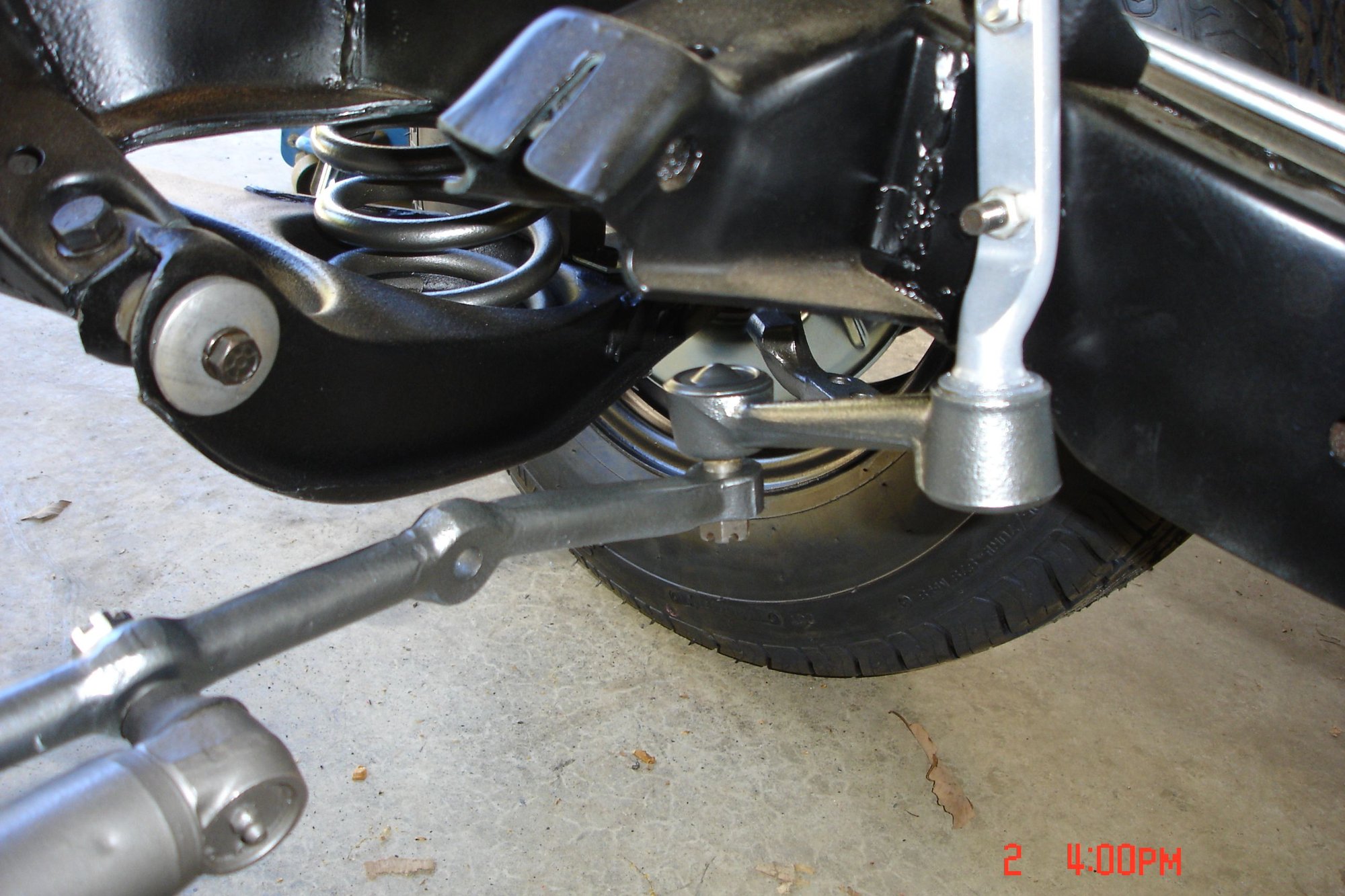

I have a 1969 that I am trying to restoring to NCRS standards. My car has manual steering , the judging manual said that the tie rods are natural finish (bare steel) but from what I read does not say what the relay rod colour is ( connects the steering arm to the idler arm) ? does any one know if this is also bare steel or Black or what ? a picture would be great!
Thanks Peter

That is great thanks for the pic's so have you just wire brushed the steel and that s it ? Is there any difference between power and manual steering
thanks again
Peter

Your pic's popped up just after I posted to the previous one
The finish that you are showing in your pic's looks like it could be done with a paint build up but that can't be right
It will be interesting to get some other opinions
thanks Peter

That was to simulate a natural finish. I think both the Idler arm and relay rod were forged and tended to have a bluish gray finish, hence the paint to appear that way.

most metal suspention parts were unpainted steel or cast. those parts rust
right away, rvzio parts look real nice.
What paint brand and color did you use. Looks great!
