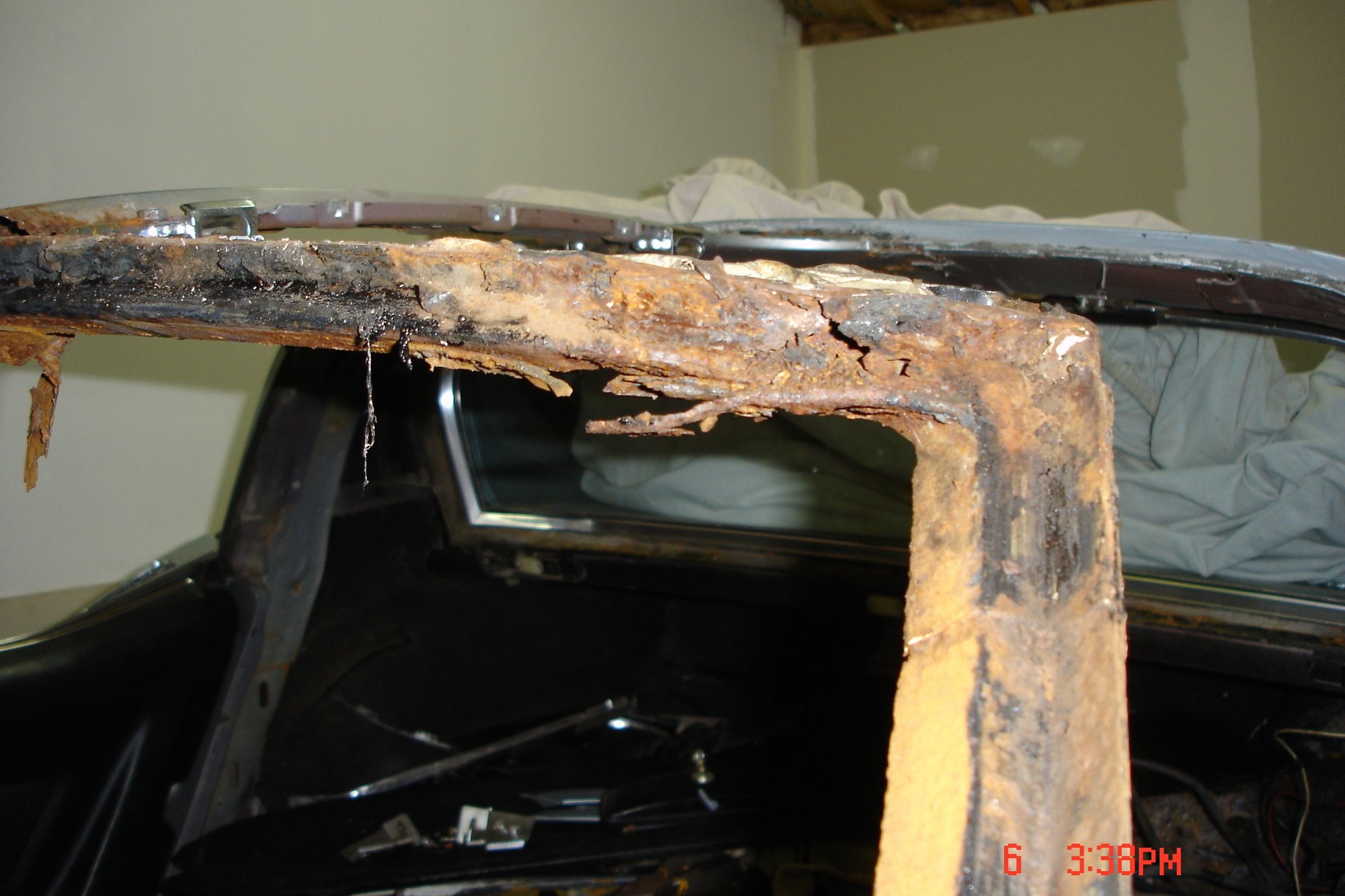

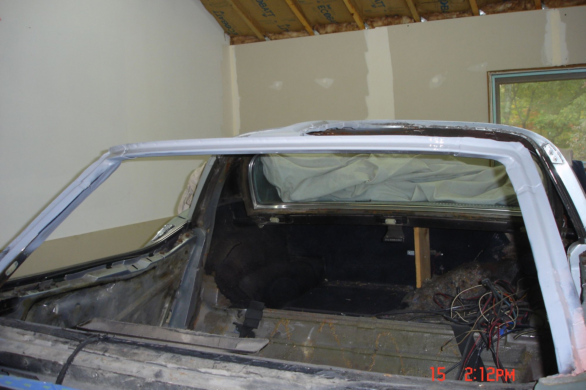

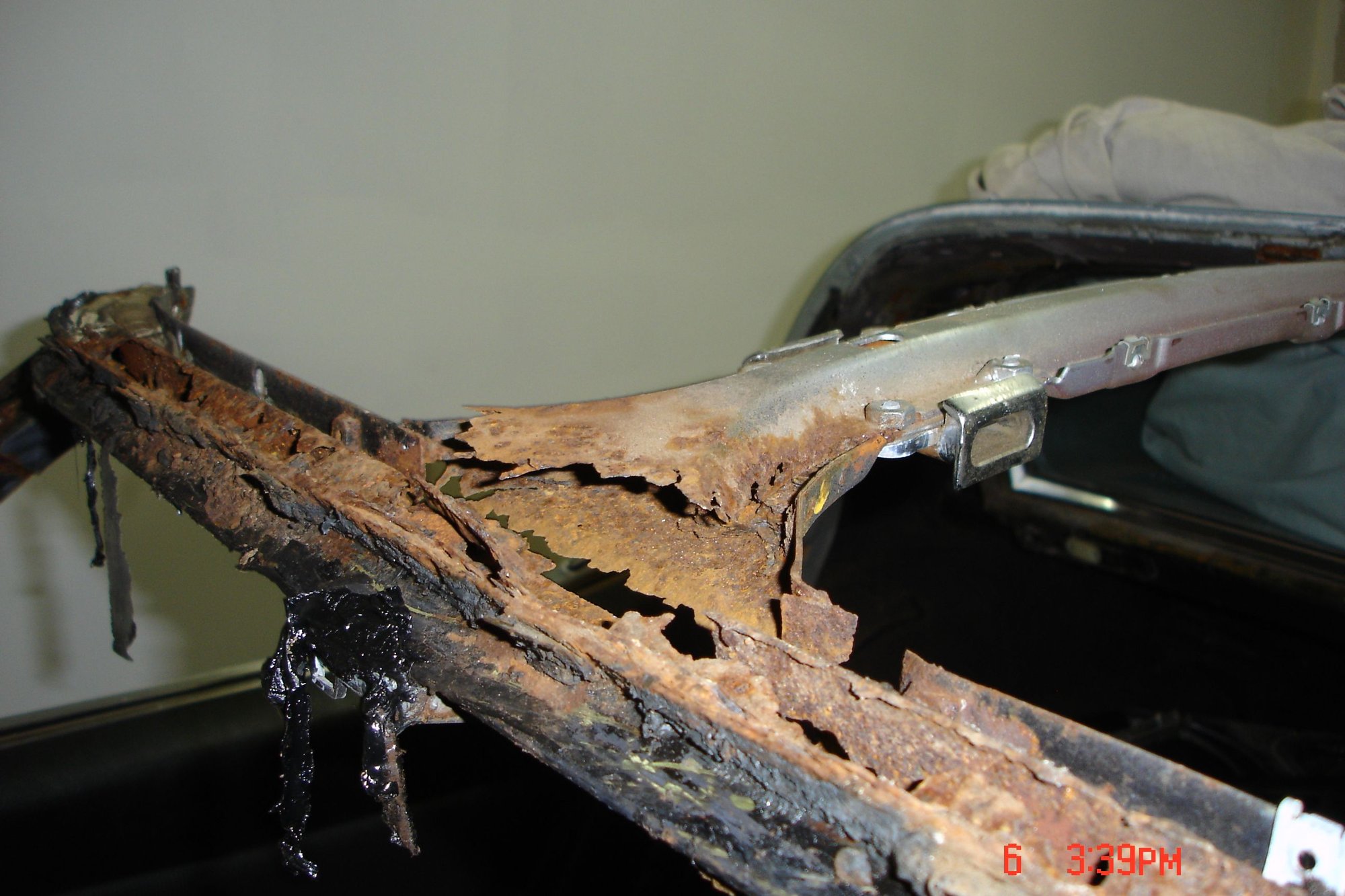

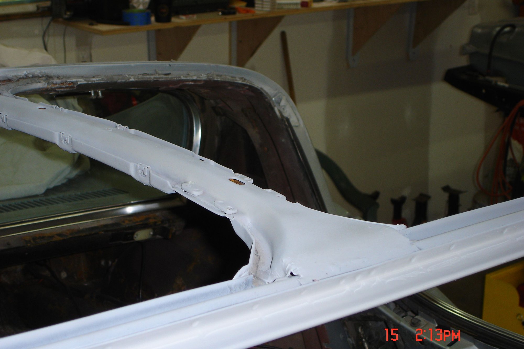

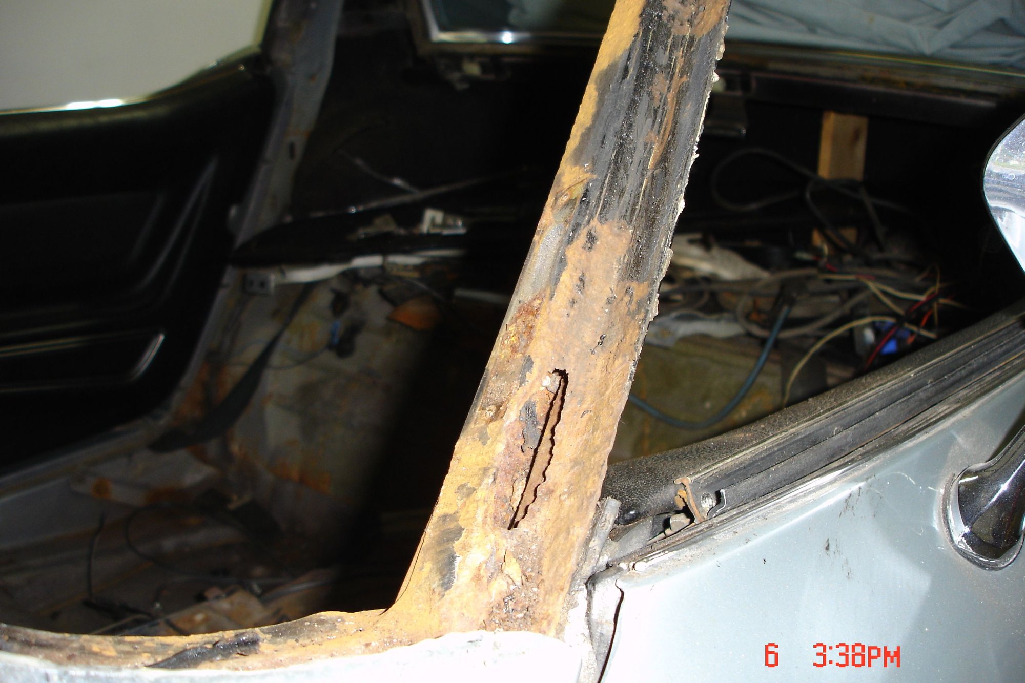

Hi Lars, I had to replace my windshield frame do to excessive rot hidden underneath the trim. I purchased my frame from Paragon who is a forum supporting vender also. I also had to replace the center T top support. You will need to take some measurements so that you are assured of your angles. This is important for the windshield as well as your door glass. Not sure is any of this will help your situation.
