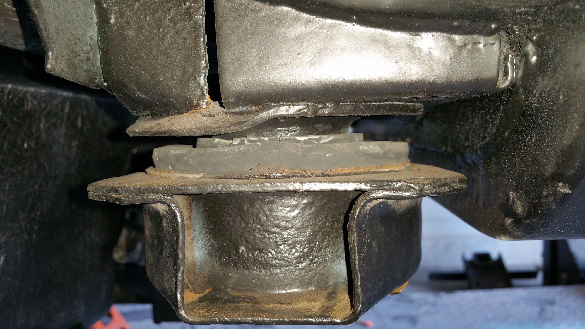

I have reinstalled the differential and have a question regarding the crossmember that holds the differential to the frame. I have torqued the bolts to the specified 70 foot pounds. There seem to be quite a gap between the frame and the crossmember. I have included a photo. Is this gap acceptable? I did not use new bushings. The old ones seemed to be in good shape.

Looks normal to me. Here is a picture of mine.

Here's a view of my carrier cross member bushing.
It's the original bushing and it looks like the crossmember might be seated SLIGHTLY deeper than yours…??
