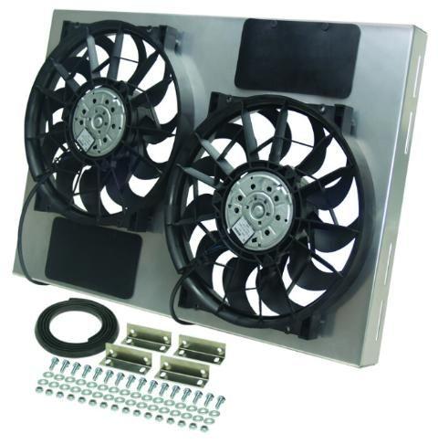

I went with these, the cover the full radiator and move 2000 each fan....
They are not the biggest or baddest just what I wanted,

That's a good looking set up bats. What kind of price and amperage draw are we talking about? As far as the no-name spals, yeah you're paying less so expect you may get less. Depends on your mechanical prowess as to how it comes out.

on mine amp draw is 24, 2000 cfm per fan, I paid just under 300 and it hurt, but the time it saves over modding a cheaper fan helps,
But like I said I saved your link, I would mind to do a side by side test,
