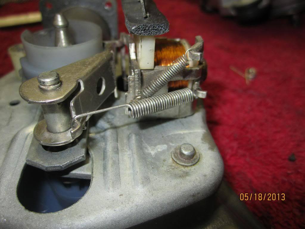

Pop the plastic cover off and you can see the solenoid that pulls the engagement for the pump
If it's not pulling that lever, take a meter or test light and check the two leads that plug in on the front of the washer pump and see if they get a pulse when you press the button.
The solenoid is replaceable if you can find another one to scavenge off, careful early cars had barrel connectors, mid 72 seems they switched to spade connectors like shown)

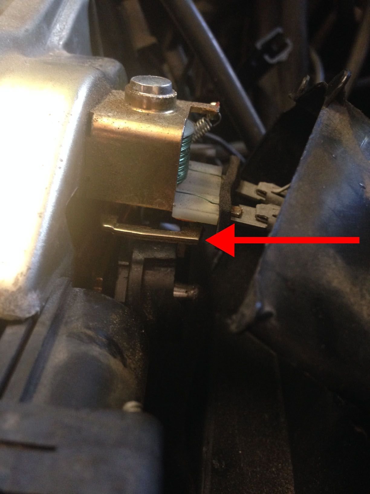

So after jiggling the wires and making sure those two tiny solenoid wires were touching the connections, I got a clicking sound when pushing the button. On further inspection the clicking is coming from the piece of metal popping upward toward the solenoid when the button is pushed (see photo with red arrow pointing to metal part). I still get no lever action and can't figure out how this mechanism is supposed to turn the pump. Are there any good diagrams out there that show how this works/connects?

Ahhh the wonders of the washer pump
Here's my attempt to explain from another post, the two arms are the ones just under that solenoid your looking at. the one closest to the solenoid I refer to as the magnet arm, the lower one is the ratchet arm.
When the wiper motor is turning, the ratchet arm is always moving back and forth with the cam wheel but it's not ratcheting the gear ahead, when the washer button is pressed, the electromagnet moves the second arm (magnet arm) up and allows the ratchet arm (lower one) to engage the ratchet gear to start turning it, the ratchet arm then pulls it around one tooth at a time and pumps the pump.
When it makes one full turn the magnet arm drops back into the off spot and it stops the ratchet arm from engaging the gear again.
Here's the thread I made in all it's bloated glory
https://www.corvetteforum.com/forums...-assembly.html
Skip down to about 2/3 the way of the first post for the pump bits
M
