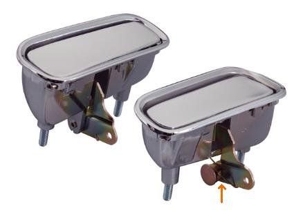

Look at the picture posted, take a long skinny screwdriver and push the square lever at the tip of the arrow down toward the bottom of the door. The door should pop open so you can get the panel off and check the connecting rods. One likely thing is the outside handle has a rod that goes down to a lever. IF the spring breaks on that outside handle part, the rod drops down a little and the door won't open with either handle, nor will it lock or unlock. You will need to lift that rod up to put tension on it to open the door with a handle. Simply lifting the top chrome finger plate won't do it. It's the spring on the lever that the chrome piece pushes down. You can take the outside handle off and replace that spring if that's the case, or replace the handle ***'y.

Here's a picture of the spring that breaks. It allows the inside mechanism to drop slightly and prevents both handles from opening the door and if you slide the inside lock button, it feel wrong, doesn't move correctly in both directions. The handle nuts aren't easy to get to to remove it, but it can be done.

Check that spring I told you about. It has to spring all the way up or the mechanism won't work.
PS The same symptom will occur if the clip falls off the rod connecting to the hole in the lever where the spring is. If the rod becomes disconnected, neither handle will open the door.

I have re-bent the spring so that it hooks over the lever and it worked. (the end of the spring breaks off). But I was never able to find just the spring for sale. If the clip is off and the rod disconnected, you can buy connecting clips and stick the rod back in and replace the clip.
