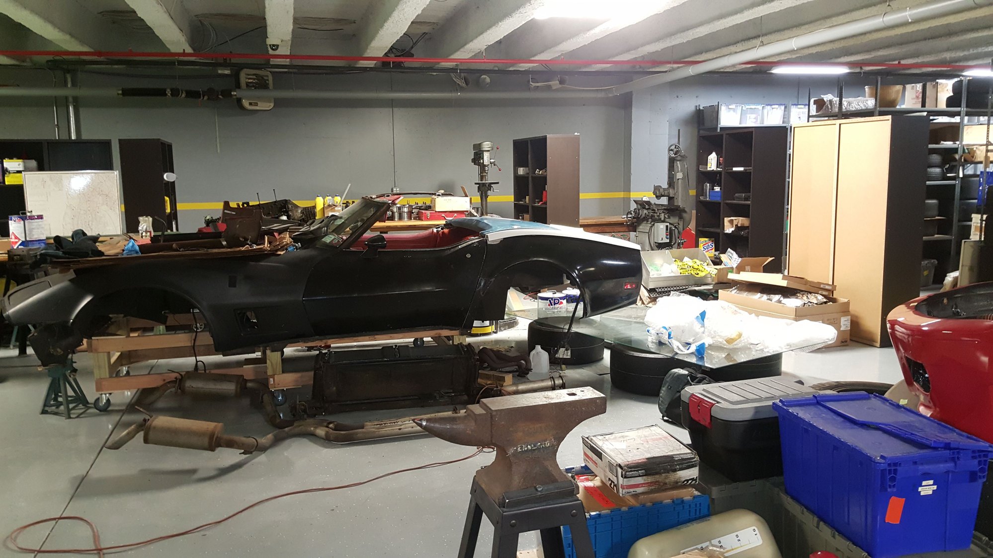

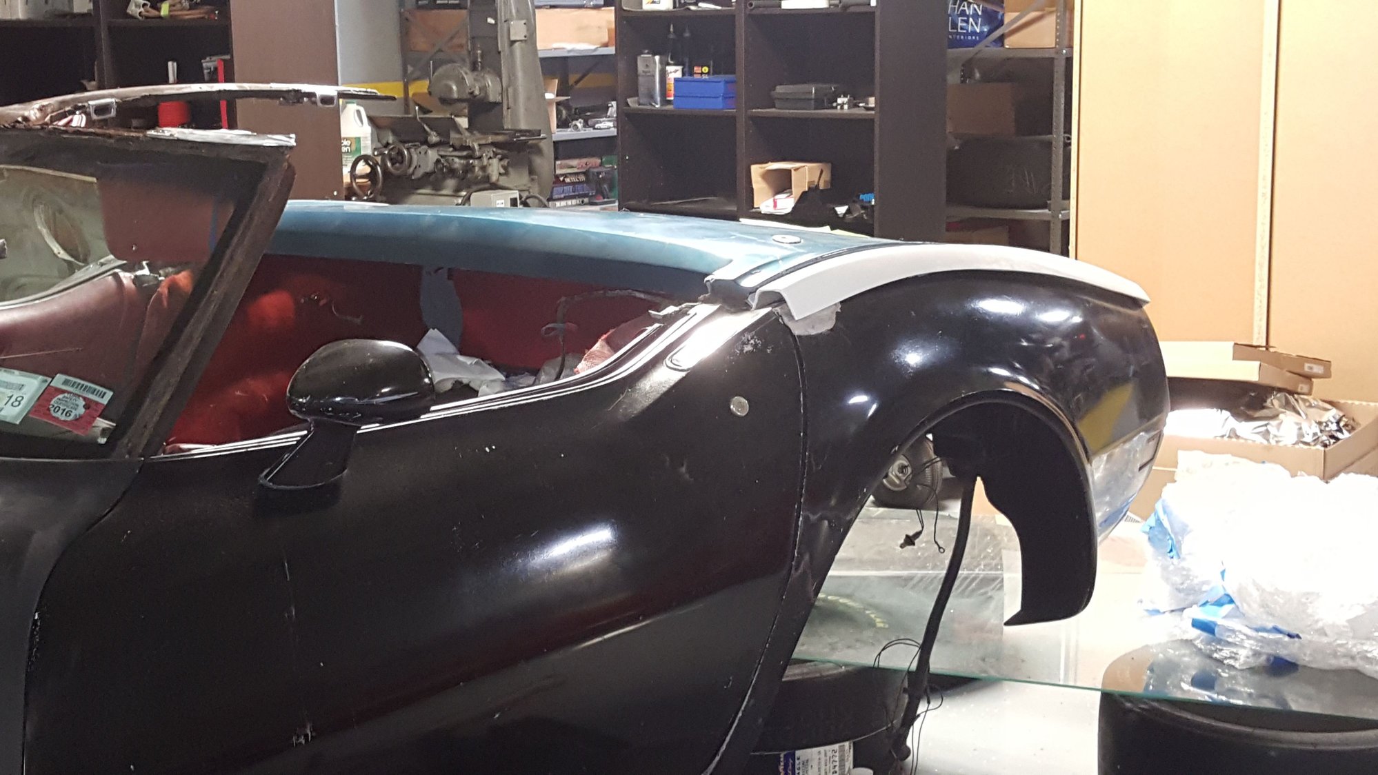

Default oh..I'm fully into it now
... a rough cut on the birdcage just tosee how it will look..
