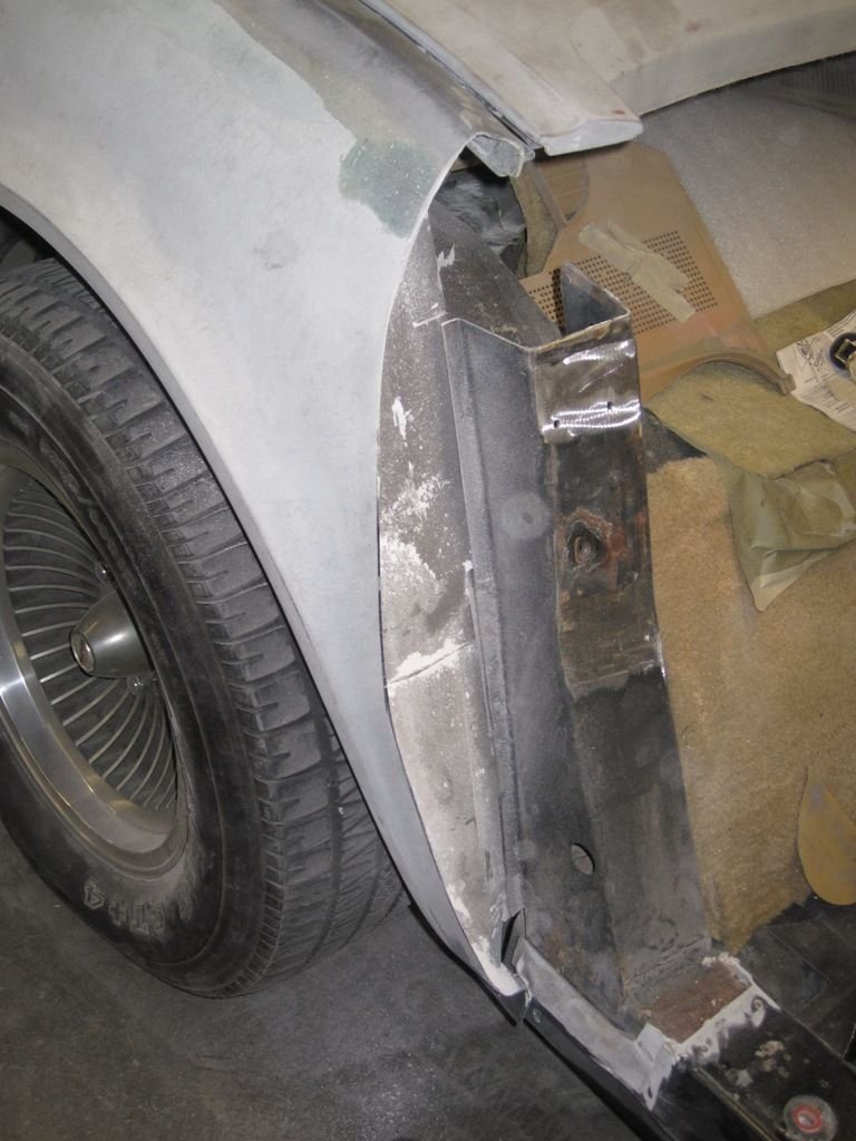

That is right. You will need make sure the rear deck lid lines up with the rear deck lid with the gas tank opening. i used sheet metal screws for lining up all the parts. I could not get the filler strip to bond the rear deck lid with the gas tank opening to the rear storage rear wall. So i had to create a bracket to tie the deck lid hinges. These pictures will help understand what I had to create.
I also had to build up the rear deck lid with the gas tank opening to the rear storage rear wall. This is a good picture of what had to do build it up to match the rear deck lid.
With filler strip added. it came off the old rear deck lid. And grinding and bonding material to match the 2 deck lid to match there heights.
Another thing are the rear door jams. Removed the old and
replace the with the new.
I do not have a good picture of the windshield center hardtop guide since i am not using a hardtop.
More questions ask away.
