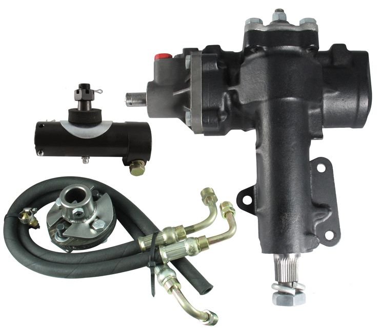

Originally Posted by Bigeddie
hey before you decide on rack and pinion take a look at the burgeon steering!
I have hated the cantankerous stock c3 power steering for over 30 years, leak and slop prone floaty feeling, I planned rack and pinion but at the moment the hurdle is I have VBP transverse front spring and hooker headers and according to VBP no R&P will fit without mods,
the borgeson is a winner for me, while it's not as nice as a rack would be it's cheaper and far less work to install...I am still in research mode but on my steering something has to happen.

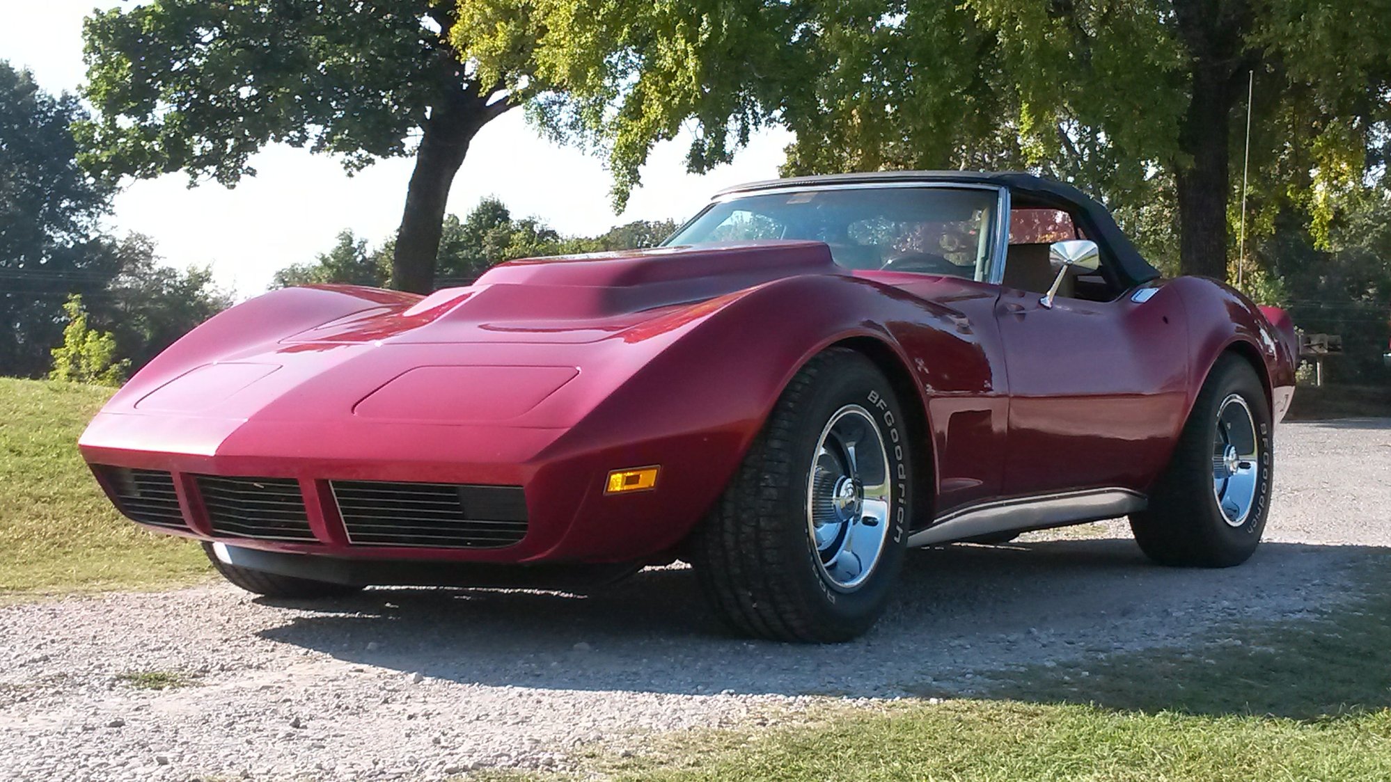

I'll never forget the week I brought my 74 "barn find" home. The PO had let the car sit in his garage for 13 years due to a misdiagnosis from his mechanic. After replacing a plug wire and draining the old fuel she fired up.
Never forget the very first ride down my private gravel road, as I lamented on how she rode and sounded like an old bucket of bolts. The power steering had a turn radius similar to a 50's model Ford 8-AN tractor and I didn't know where to begin to isolate the rattles, as they sounded like they came from everywhere. I remember saying I was ready to check a C3 Corvette off my bucket list. More like erase it from the list.
Fast forward right at two years. After replacing the factory power steering with a Steeroids unit, replacing bushing and ball joints (BorgWarner...don't skimp here), and to top it off, I went with the Sharkbite rear suspension.
It took a spell getting used to, as the steering is unbelievably responsive. Also, paying for a QUALIFIED front end guy to do a CORRECT 4 wheel aligment, involving setting up the trailing arms and front end end alignment will result in handling unlike any stock C3 could get remotely close to in the past. Also, the thunks and clunks are now gone.
Bigeddie- not familiar with the Burgeon steering gear. 13bats has a photo- looks similar to the stock unit, on which I tightened the lash as much as possible. Over-tightening makes it squirrely also. What is different with the Burgeon unit? If it works, it would be ideal- not a lot of extra room for the steering rack with my BB and headers. (Note for other commenters- ball joints, TR ends, idler arm, shocks, front wheel bearings are replaced. Alignment probably is off. Feels like there is toe out- will have it checked) RA
