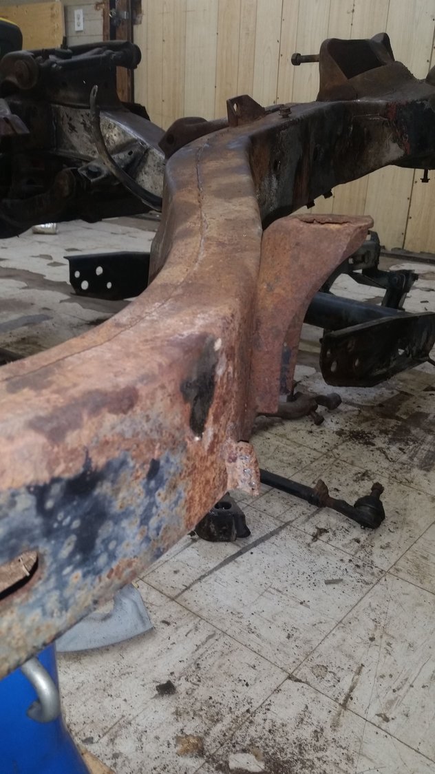

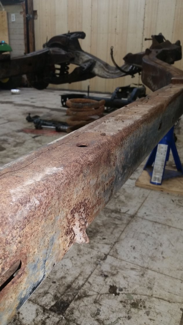

Hi im doing a frame off on my 74 and im wondering if anybody else has seen these pieces of steel welded onto the frame. This is not a bubba thing i know the history of car it looks like something from factory.Any thoughts

I do not remember them on my 1977 frame.

Didn't see them on my 74 frame off either..

Could they be side pipe mounts?

I think that Homestead is right, not factory and in the right location for side exhaust. Lou.

Since my car has never had side pipes it never crossed my mind. Good thought.
Grind smooth and you are back to stock.

Thanks you gotta be right it makes sense. I'll zip disk them off and grind smooth

Definitely Bubba.
