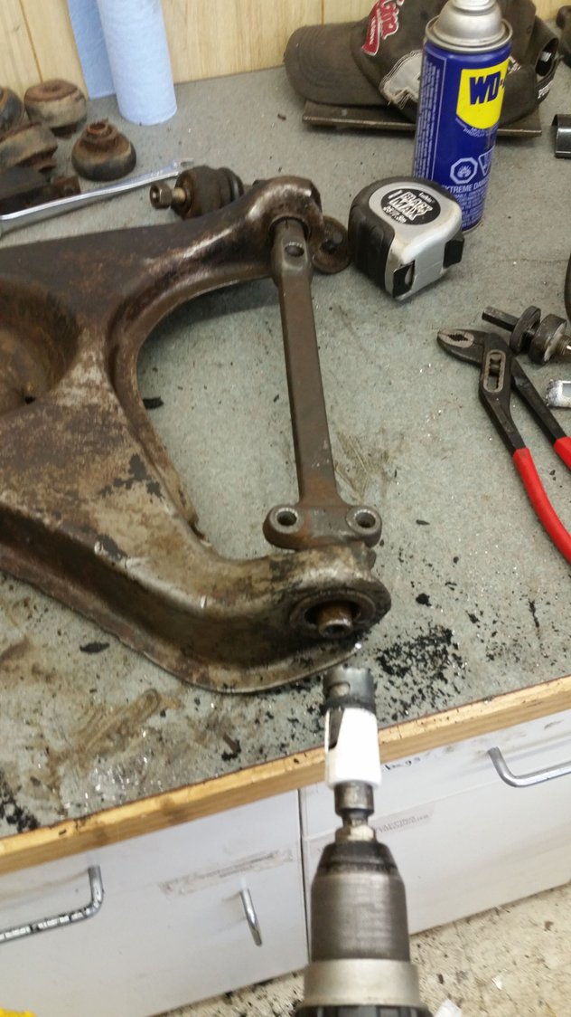

Heating the bushing with a hand-held propane torch until the bushing melts/crumbles when jabbed with a screwdriver is one way to remove it BUT this method is very smoky/stinky/messy......and should be done outside/wearing gloves with a fire extinguisher within reach.
The other method is to use a long metal-cutting hole saw to cut out the rubber from the bushing......then the shaft can be removed....

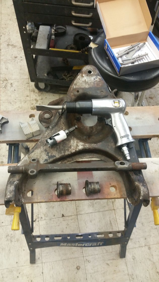

Use a air chisel or bring it to a shop. I use a air chisel after burning out the rubber. The rubber will ooze out then I grab the inner metal sleeve with Channel locks then work the chisel under outer lip of bushing. Be carefull using a press you can bend the ears pretty easy.

There should be some sort of a "lip" on the side of the bushing that faces outward. Use an air chisel with a dull point, against this lip, and "walk" the bushing forward, out of the arm. Do this on both bushings.

Thanks alot this is exactly the information I'm looking for. I just bought a hole saw to drill out rubber I'll give this a try tommorow

If you spend a minute with a hacksaw (once the rubber is cut out) and slit the outer sleeve you can collapse it and it will push out easy. I use an air-chisel with a flat end to pop it out but I don't like hammering the sleeves out of the vette arms without collapsing them first, they just don't seem as robust as a the other GM arms. LOTS of people have just taken them out with the air-chisel without issue but I'm not usually that lucky

Well after two days of fighting I went and bought a 1 1/16" hole saw and a air chisel. 20 minutes later all bushings were out next time I'll read the forum for 2 days thanks for the advice everyone

Mastercraft workmate and powerfist air-chisel.....Must be Canadian, you should add your local to your profile, may have neighbors close by
