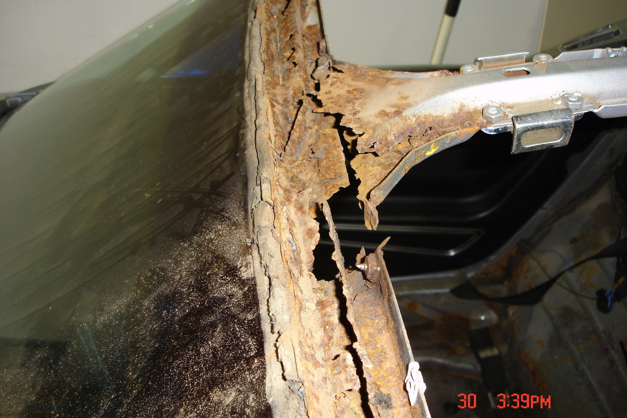

You can sand that down with a 2" wheel right down to metal. That does not appear bad at all. Upol #2 primer or Moellors Zinc Chromate green which is what was used originally.
I'll show you bad and the paints:
ZIO
ZIO
Yeah those pics are a might scary. Thanks for info on the paint, I wondered what it was, I'll have to pick up a can.
