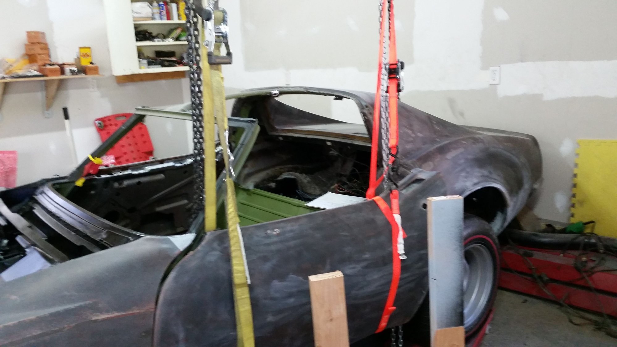

Old Nov 1, 2015 | 08:24 PM
SB64's Avatar
SB64
Joined: Jun 2013
Posts: 4,399
Likes: 793
Default Body Lift
I tried to simulate GM's method by locating my pulleys centered on the car. The 2x16 triple header with a steel 1/4 x16" plate bolted in the middle for support. Doors were on the car with padding on the straps as to not but a lot of side pressure on the doors.
ZIO
Also a picture without doors.

Hahahaha....thanks Bats. At this point, my biggest concern (if I decide to do it), isn't the bolts, or disconnecting stuff, its the lift itself.....Obviously, a 2 post lift is ideal, although clearly numerous people have done it with an engine hoist....which is the route I would have to go....I can't wait for the HOA complaint as Im blocking the back alley way lifting a corvette body off a rusty frame with an engine hoist and a bunch of straps......actually, add a case of beer and that sounds like a pretty enjoyable afternoon.....

I was surprised how the center of gravity of the lifted body was near the firewall and not in the center of the door, so be aware of that when you first start the lift. Good luck!
