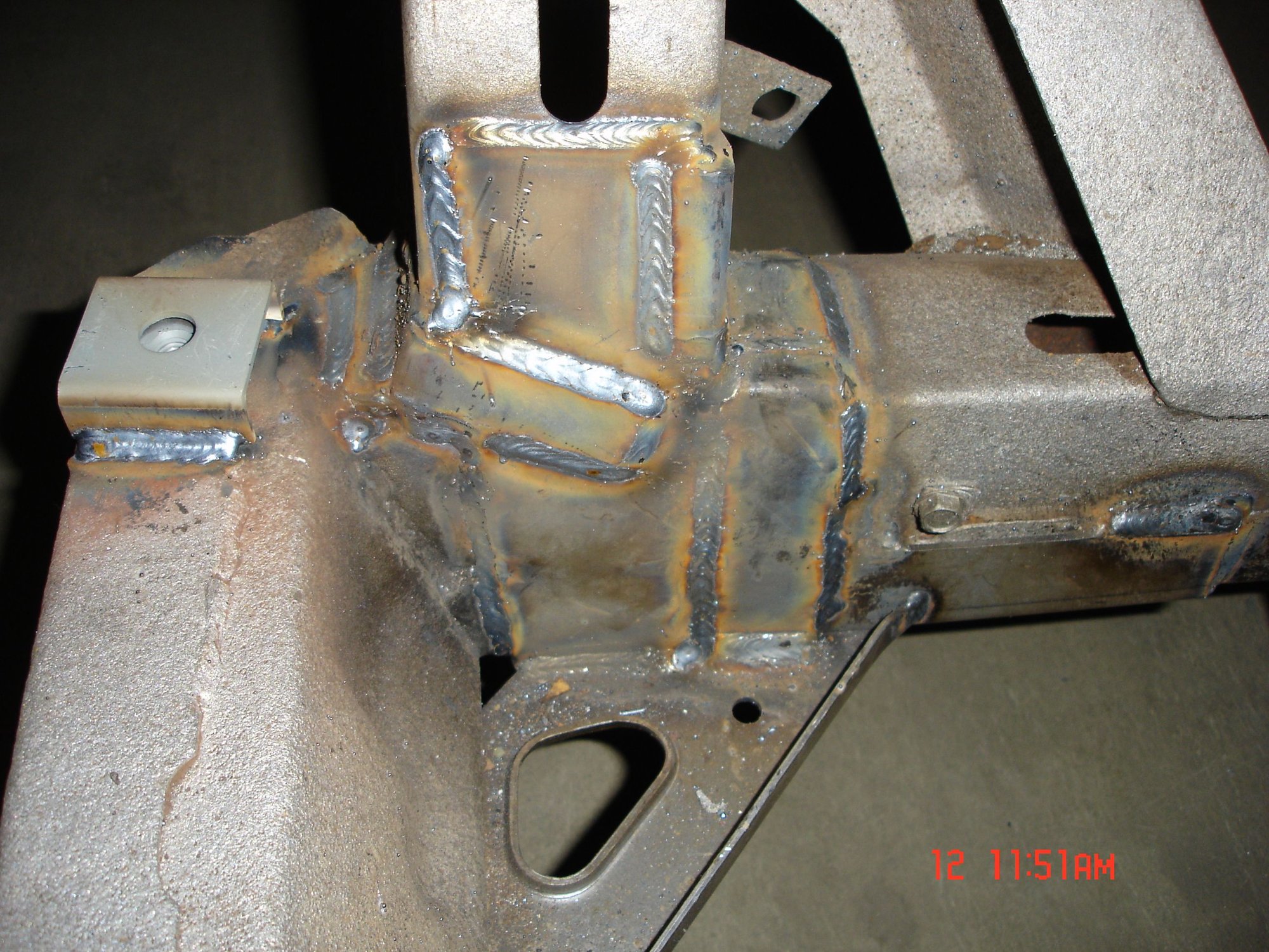

I TIG weld almost every day in my line of work. I love it. Sooo much nicer welds UNLESS I'm in a hurry, then I break out the MIG and even then not on customer stuff. MIG is easier , it doesn't put as much heat in the metal and if you aren't careful you can have a decent looking weld and not have good penetration. With TIG you have time to see exactly whats happening. BTW, I restore old Harley frames and my customers lives are literally riding on my work. It HAS to be good. I am just finishing up a 1937 Knucklehead frame.
Both of my machines were made by Lincoln, My 255 square wave Tig is 20 yrs old now ! It's been trouble free.
