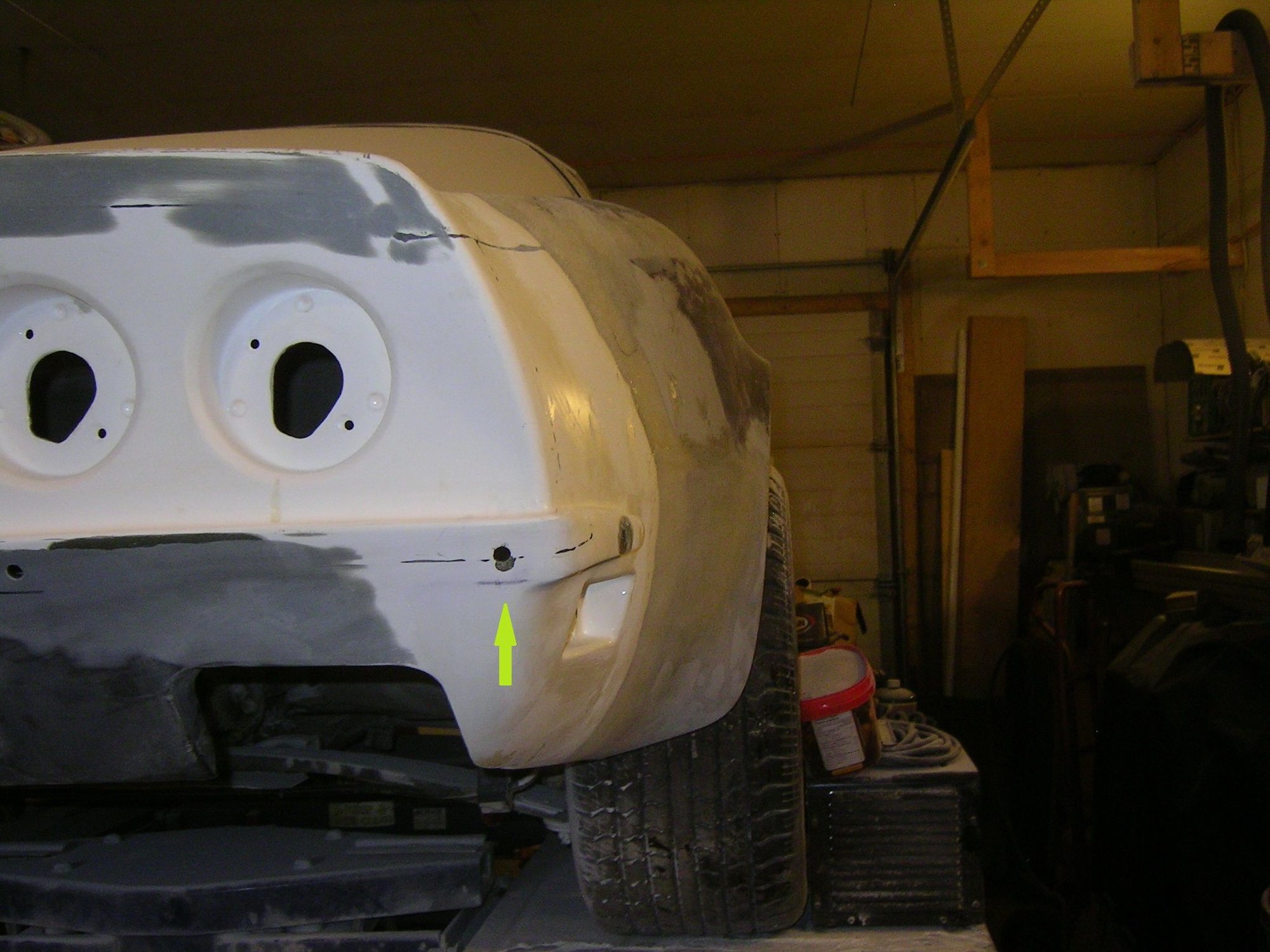

This is what I've been working on all this time:
From this:
The area between the two green arrows is roughly where the side of the bumper bolt goes through. I wanted that mounting area to be a little wider at that point so the bumper bracket could sit on a little flatter surface than was orignially there. The darker fiberglass is the stuff I've added and the whiter stuff is where the original body line was. I'm shaved a little of the inside of the quarter panel at this point to get the flatter interior surface I was after for the mounting bracket/bumper attachment.
You can see in the above picture the blue masking tape on the inside of the quarter panel showing through - that's how thin it is). I broke through the original fiberglass in a couple of small areas and so reluctantly decided I needed to thicken the original fiberglass on the inside of the bumper mounts as well, so I've done that too:
The modified bumper mounting areas are very close to ideal now. I have a pile of pictures showing incremental steps of how I got from the original aftermarket fiberglass mounting points to where I am now. At some point I'll put that together in several posts (perhaps in a separate thread) for any novice contemplating such a project that wants to see whats involved (if you're no expert, lol!)

All this because I thought 1/2 a millimetre of gap between one bumper mounting area and the bumper was too much,
Now I'm stuck doing the driver's side too, although I'm sure I can do it a great deal faster than I did with the passenger side.
