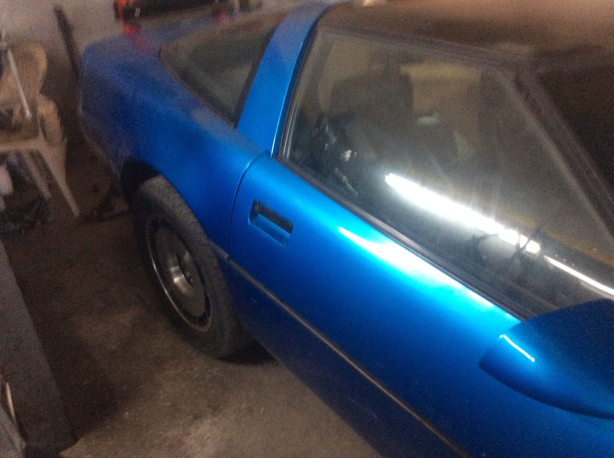

Hi Pryia ! Here's some pics of the color on my brothers corvette! The first one is inside with fluorescent lights !
The next two are outside in the sun !
As soon as he sends the code to me as pass it along !

Thanks SPCL FX.
I think I've seen that colour before on C4s (not in person) and it is very nice. That one seems to change colour a bit depending on the light, doesn't it?

That actually is not a c-4 color ! I'll have to ask again ( I have crs syndrome) lol
if I'm correct it's a 2003 corvette blue ! Here's the code !
And yes you are correct it does tend to change depending on the light !
Any automotive paint store can mix this but his was done with PPG Basecoat /Clearcoat !
