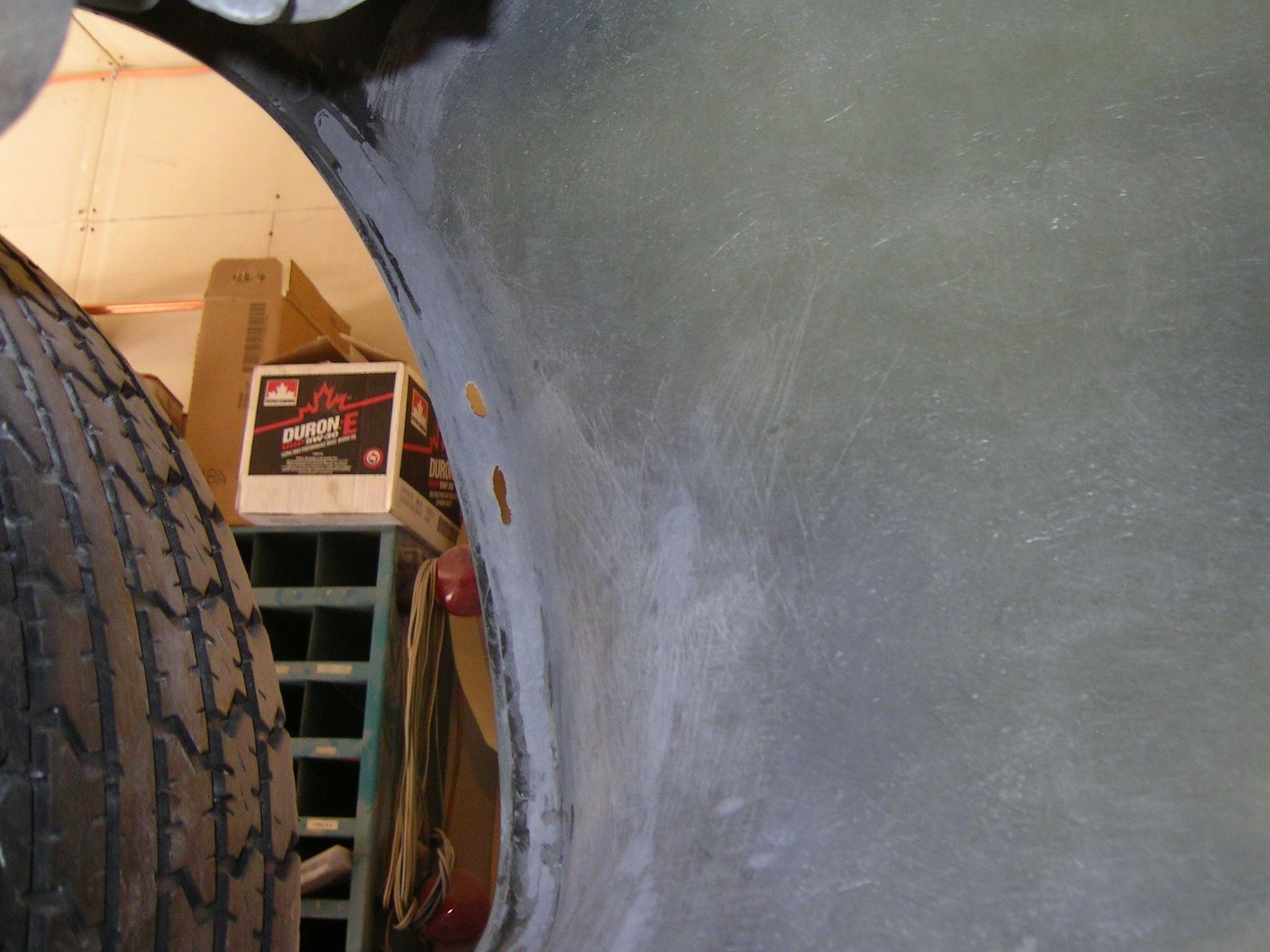

I would have had all the nasty work inside of the car in the gas tank area leveled and feathered out today but then the above happened. So, a bit more laminating on the inside of both quarters at the wheel lip opening and hopefully no other place is too thin and needs more.

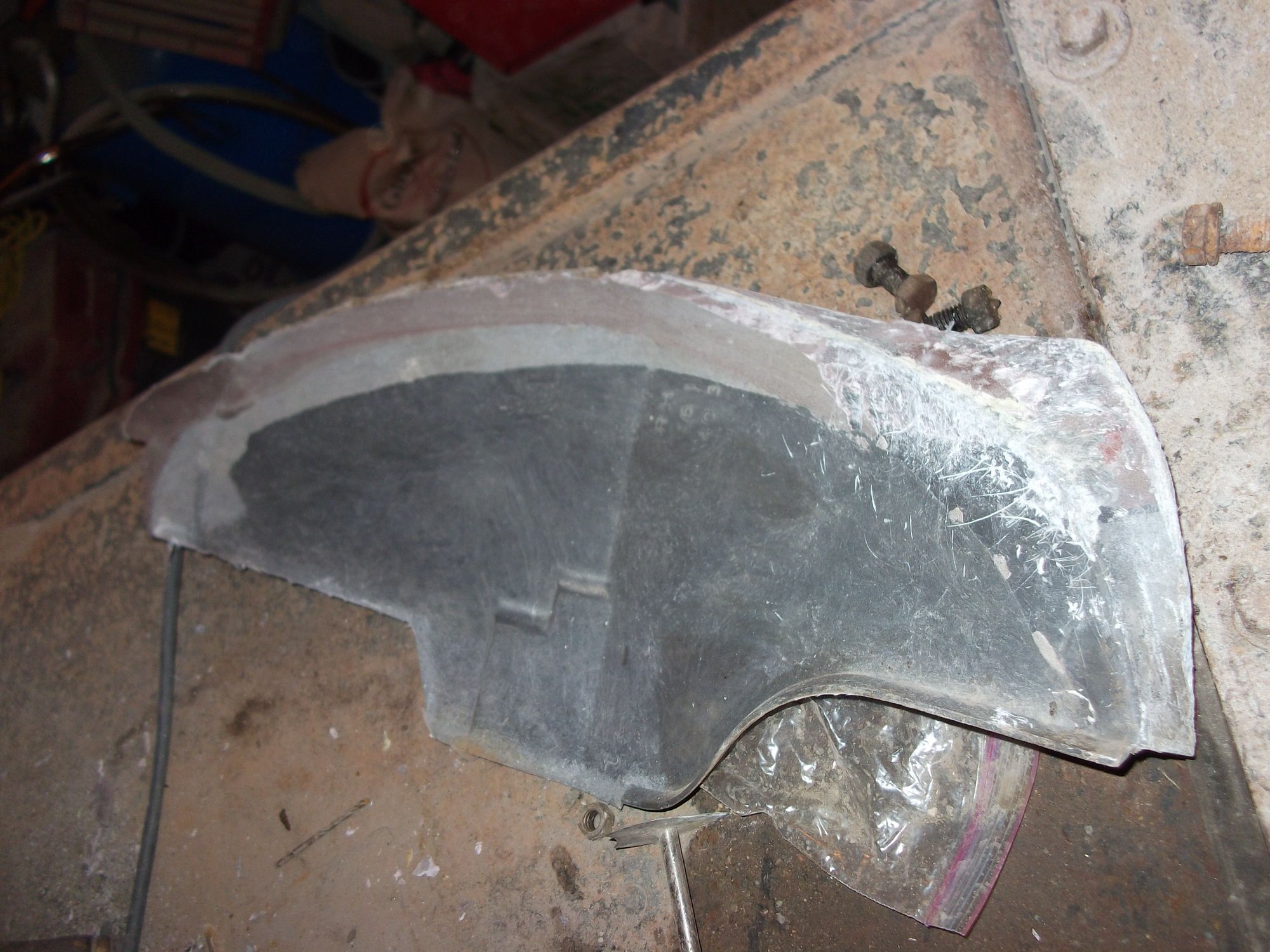

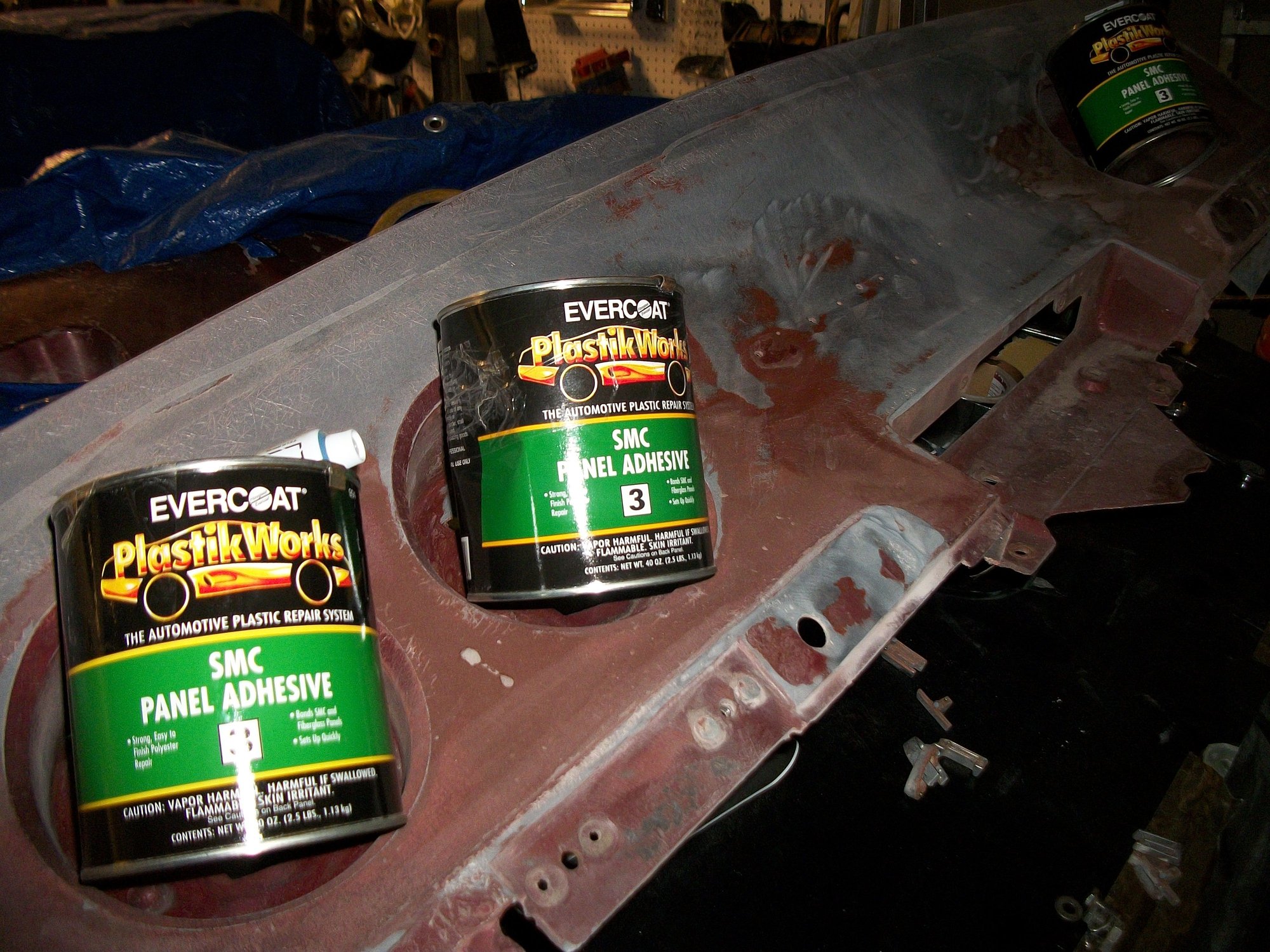

I'm going to want to put in the wheel well shields shown below soon. Can I just use the vette panel adhesive/filler to glue them in or does anyone recommend something else?

I forgot the name of the adhesive that holds the body panels in place (the names are so similar to me, being a rookie). The filler/leveler that you and I use to smooth out our fiberglass work will crack when used to bond stuff..........been there
