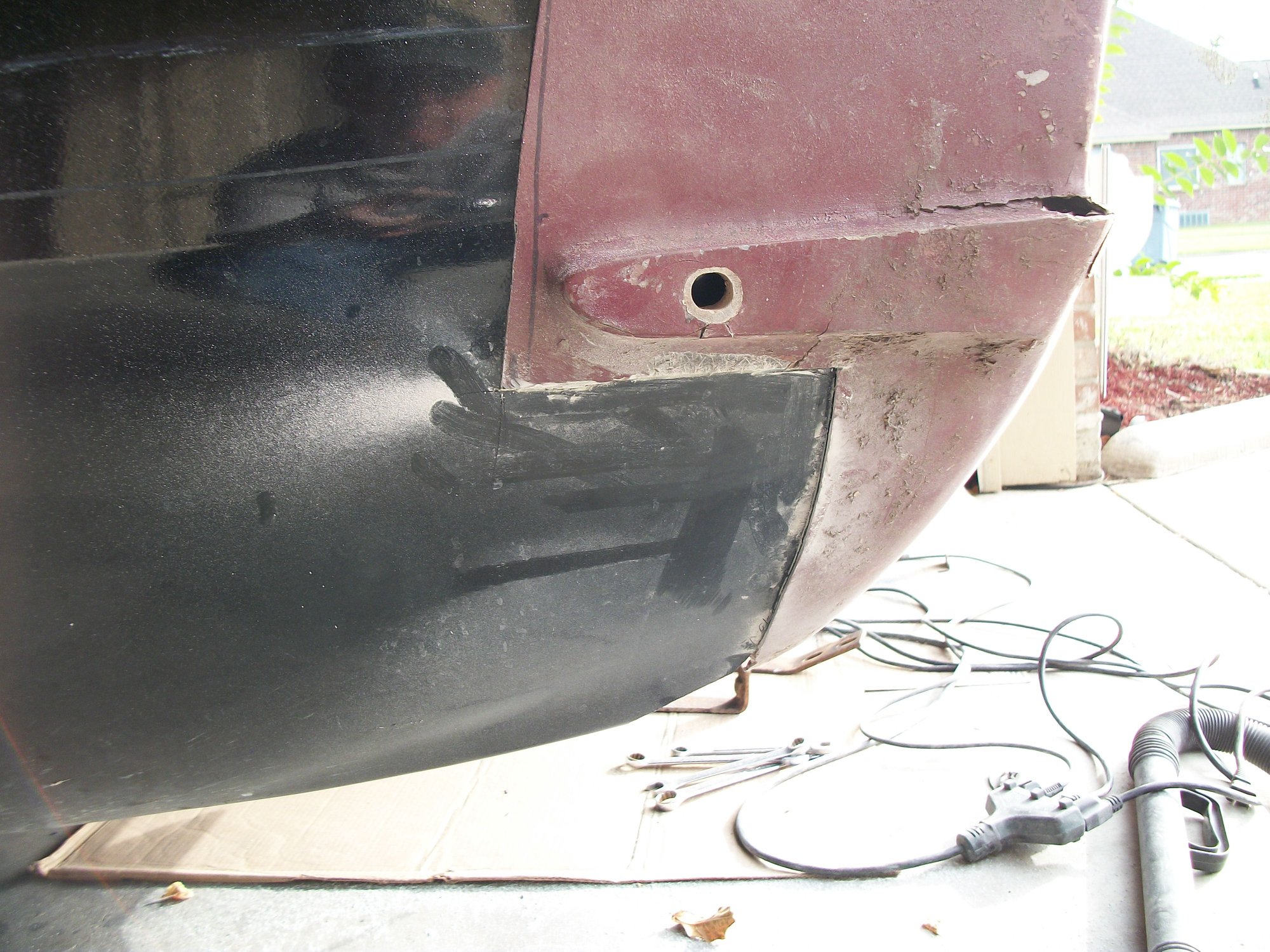

ok, the very bottom of the quarter.

shows good on my white 75. it looks like that whole piece that tapers all the way to the fender flare is flat out added to the bottom of the earlier quarter. so one could probably cut it right off instead of figuring how to blend it into the add-on early model piece.
I haven't decided how I'm going to address that yet. Probably just cut it off as you suggest.

If I were concerned about the taper at the bottom of the original quarters....I would take into consideration the rear inner splash shield of the original first....and then make my cuts so I do not loose the bond at his area of the original quarter panel....BUT...yet still have the cut be rearward of the splash shield so I can do my lamination of the two panels as needed. That difference in the two panels ...for me is not that big of a concern. BUT...I DO AGREE...if this area can be reduced to the smallest area that would need to be modified...then I would do that....but THAT would not be my primary concern.

Take your time and mock it up in different ways to see which will work out best/NO Rush......I only had a short "clip" to graft on, so I will have to "deal" with the small inverted contour at the bottom of the quarter panel/no big deal--I need to learn how to work with fiberglass anyway (now If the PTSD will slack off )

Tony, your's is a 68 body that has had plastic bumpers added. You don't have to deal,with the wrong shaped later model quarter. My pic post 90.
