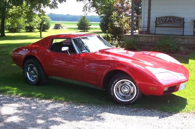

Priya.. I mean this in a constructive way, not trying to discourage you at all, but maybe you should buy a project Vette that needs a rear clip like Doorgunner did and sell your `79? It appears to be all original and in pretty nice condition. Seems like a shame to modify it like that. I'd be willing to do a bolt on conversion but I don't think I could work up the courage to cut up my `76. I wouldn't want to mess up the collector value ()
That tail piece dtamustang posted is exactly what I've been envisioning for my car. For the front I want a FG bumper like the one I doodled up in photoshop (sorry, not my best `chop job). I'm not looking for chrome bumpers just a shorter side profile and a duck tail spoiler on the back like the 68-73's. I'd also like a 1970 small block style hood too.

Also ..in my fantasy.. the bumpers are shortened enough that the same overall length as a chrome bumper car tip to tip is achieved, but the car still has the period 'correct' fiberglass tail and nose. It's the kind of modification hardly anybody that sees the car would even notice but it really appeals to me personally. I just can't justify spending big bucks to do it. I'm retired now so to me that's anything over fifty smackers.
Originally Posted by VETFEVER
It's not a conversion - it's a chrome rear end with the bumpers removed and the "bumper shapes" shaved off...
There was a guy some where on the Forum who was attempting to do just exactly what you're describing...
