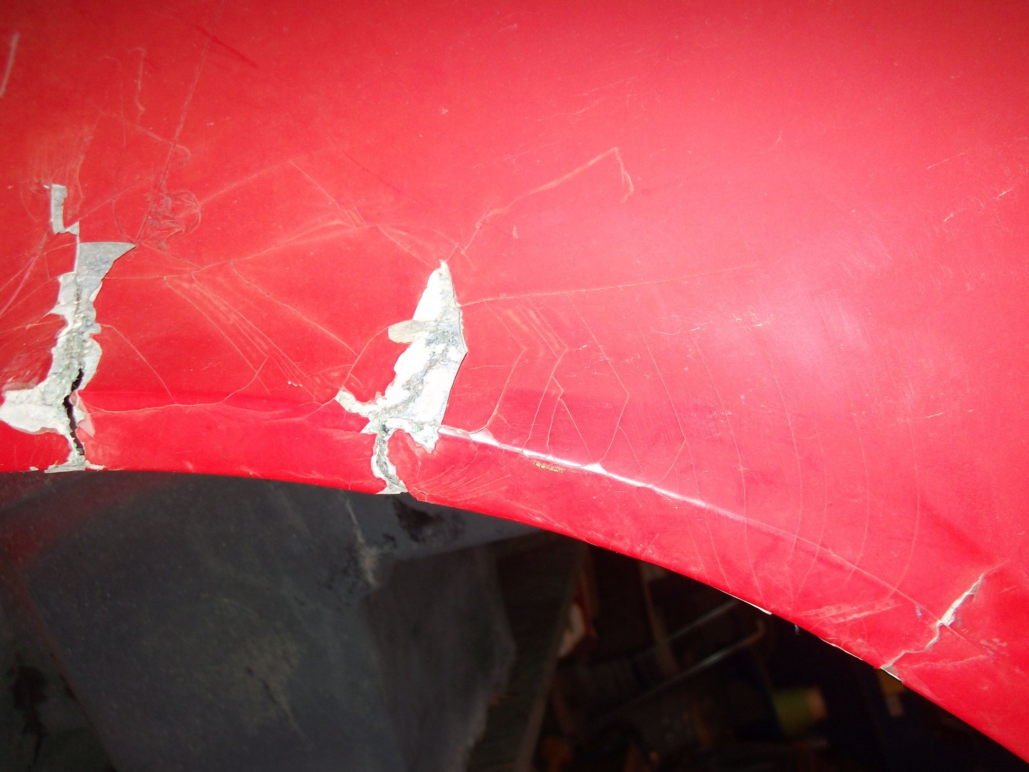

I finally got started on this project today. I started looking for a chrome bumper rear clip back in the spring. A forum member had a new 70-73 ACI rear clip he was willing to cut the back several inches off just behind the rear wheel wells for me for $700 U.S. I was getting ready to proceed with that when I decided to contact some people in Canada to see if I could get one here and avoid the cost of duty, "brokerage fees", canadian dollar exchange, shipping from Texas and so on. I contacted Western Corvette in Calgary and they said they had a 69 convertible rear clip for $600 Cdn and would ship it to me for an additional charge of $400 cdn. They said they'd send the whole thing from the "B" pillars back and then I could remove the 69 rear quarters at the bonding seams and replace my 79 rear quarters completely rather than joining the 69 to 79 from just behind the rear wheel wells. They sent me the picture below and I thought it looked like a really good deal as I figured the partial rear clip in Texas would cost me about $1500 Cdn to get here and this 69 rear clip came with the exhaust filler panel and the 70-73 ACI clip in Texas didn't.
Well, that purchase turned out to be a mistake. The 69 rear clip was in much worse shape than that one picture would have lead one to believe. Here's the worst of the damage visible without removing any paint:
Picture below is driver's side
Passenger side wheel well below doesn't look as bad as the driver's side wheel well, but after looking inside the passenger wheel well it looks like it might be pretty scary under that paint.
Below picture, passenger side wheel well from the inside. Looks like this quarter was bonded on with bondo.
Over the last couple of months I looked repeatedly at that 69 rear clip and had a lot of misgivings about it. All that damage and I wanted the square exhaust cutouts of the 70-73 rather than the oval ones of the 69 so that was another pile of fiberglass work the 70-73 ACI partial rear clip in Texas wouldn't have needed. My main concerns were the cracks at the center of the wheel wells on each side. The clip is currently sitting with the tailight panel facing upwards and the the "B" pillars facing the ground. The quarter panels on either side of the cracks are no longer in the same plane and if I can't get them to line up before I do the fiberglass repairs that'll be a real problem in getting the quarters straight. I'm hoping that when I lay the clip down in its normal position and place stands under the places where the suspension would go the quarter panels on either side of the cracks will fall into alignment with each other. If not, I'm not sure what I'm going to do at that point.
Both sides have damage at the bulges where the bumpers go and I've been nervous about how I'm going to get the correct shape once I taper out the damage in those areas for the new fiberglass and the original shape is mostly gone. At one point I really wanted to throw it away and buy the 70-73 ACI partial rear clip from the forum member in Texas, but my husband kept encouraging me that I could do it, I could repair the 69 rear clip and get it straight, plus he said we don't have a lot of money and what I do have is time so we decided I'd fix this rear clip and graft it to my 79.
We finally got the 69 rear clip in the garage yesterday so I started trying to remove paint today. I initially tried the razor blade method. There was one layer of red paint over the factory finish and that first layer came off relatively easily but the factory red paint underneath was much more reluctant. I tried heating the panel but got what I felt was an unacceptable amount of gouging as the heat gun seemed to make the underlying fiberglass much softer than the original paint.
I next tried some 80 grit on a jitterbug sander just above where I'd tried the razor blade and it was pretty slow going but no gouges
I next tried an inline sander with 120 grit on it on the driver's side quarter panel and it didn't work too bad but was still on the slow side. I also had a featheredger using 6 inch round velcro pads. I only had 400 grit paper for it so I knew that wouldn't do the job. There happened to be a used 240 grit on it so I thought I'd try for a laugh and see how that worked. To my surprise it worked the best of all
although obviously a somewhat courser grit would be better.
So, tomorrow I'm going to see if I can find a place that sells 6 inch round velcro sand paper in 120, 150, and 180 grit to see which works the best and then buy a box of that. It looks like sanding will be a much better paint removal method for me than the razor blade method.
The white stuff under the paint appears to be bondo. Between that and the passenger side rear quarter looking like its been repaired badly and bonded on with bondo it looks like I've got my work cut out for me. Wish me luck!

I tried the heat gun. While it made the paint come off a little better it made the fiberglass softer than the paint and resulted in what I consider excessive gouging. Sanding even with a used 240 grit paper went much quicker than the razor method was and will go even faster with a coarser grit of paper. I'm going to keep going with that.
I'll check out your post on extreme bodywork, thanks Rvzio

Have you tried or considered chemical strippers? There are several that are approved for use on fiberglass. They can be cleaned off so there is no residue possibly causing problems under fresh paint. Using a chemical stripper the paint will literally scrape off with a putty knife.

I wanted to do that but was concerned with all the cracks in the 69 clip that it would need a great deal of washing to ensure there was no residue in the cracks to interfere with the fiberglass patch's adhesion. The clip was in our backyard for the first few months and I didn't work on it as I had serious misgivings about using it. Then by the time my husband convinced me to use it the weather got below freezing and chemical strippers weren't an option as I am now unable to wash it off afterwards.
