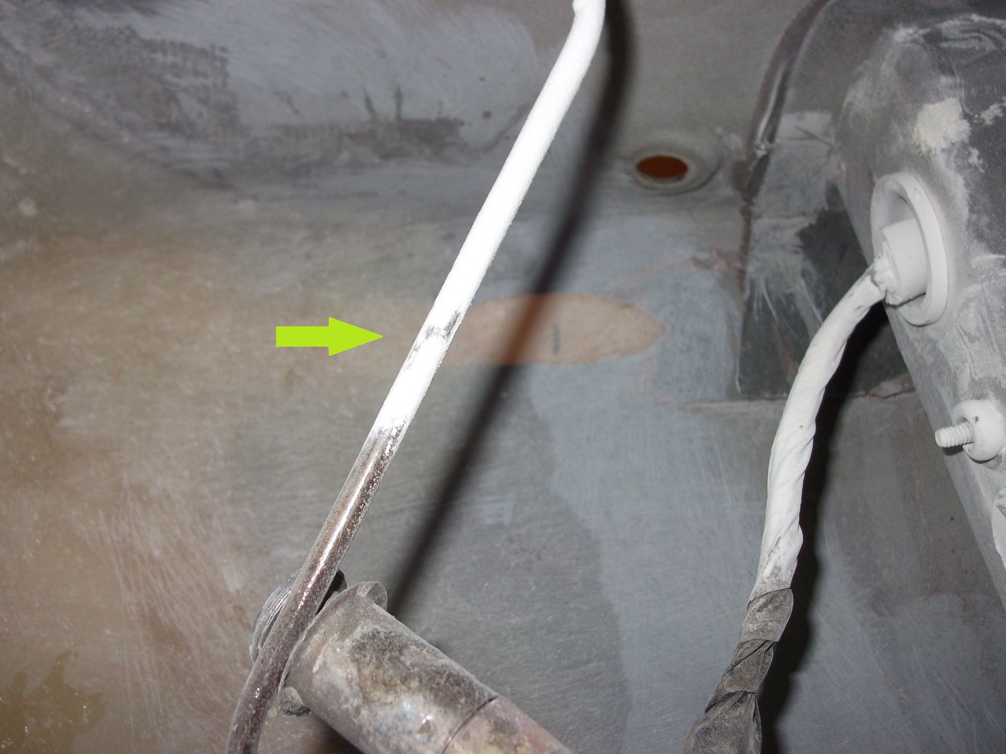

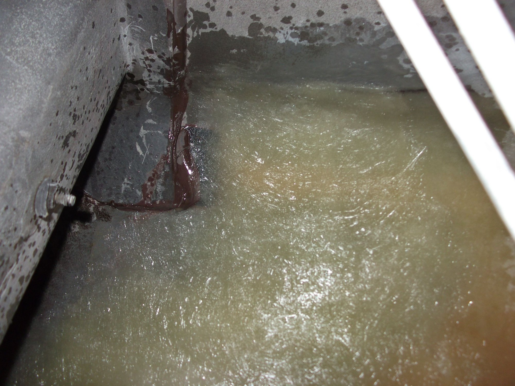

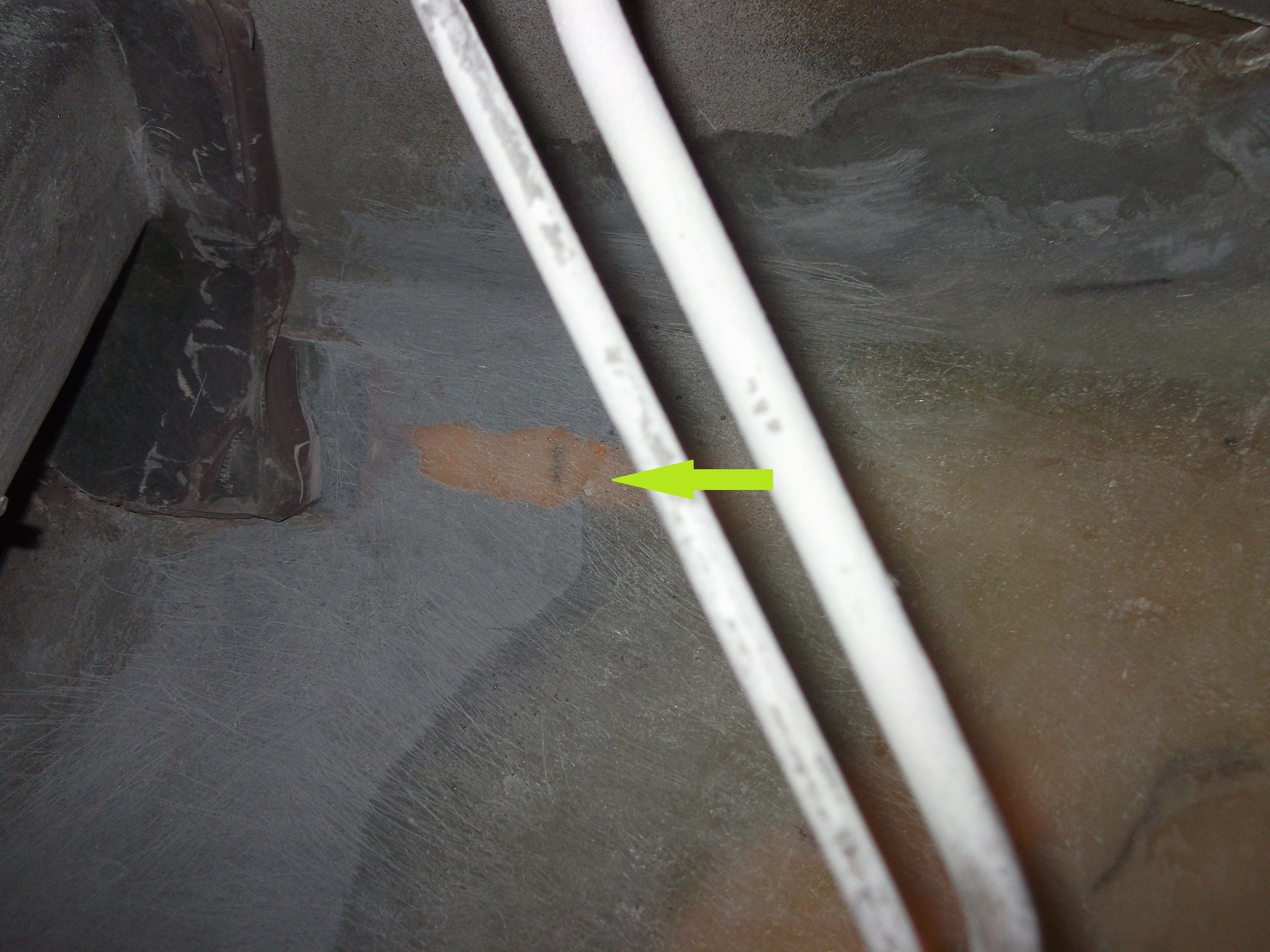

So, I've finished up (hopefully) thickening the insides of the 79's quarter panels so I can shave down the outside of the 79's quarters to lower its mid quarter panel horizontal character lines to match those on the ACI 70-73 rear and to blend (mostly the passenger side) upper quarter to the upper quarter on the ACI 70-73 rear clip. My shoulder is bothering me since I did that so hopefully I'll start that tomorrow.
The top of the factory quarter panel at the bonding seam bulges outwards more on the 79 (green arrows in the pictures below) than it does on the ACI-70-73 rear clip. As I'll need to shave down the outside of the 79's upper quarters at that point I sanded away as much of the bonding strip on the inside of the quarters as I could and added enough mat and resin there so I won't sand through the outside surface before I get a nice blend to the ACI rear clip.
Driver's side before:
Driver's side after:
Passenger side before:
Passenger side after:
The match on the passenger side quarter isn't as close as the driver's side so there's quite a bit more mat and resin on the inside of that quarter than the driver's side.
If I've added enough thickness to the insides of the 79's quarter panels in theory I've done all the laminating that I need to now other than a small area on the driver's door. I might have enough in the gallon of resin I'm currently using to finish that. If so I'll have wasted $250 on a gallon of resin and hardener I won't need.

It looks stout. It's better to have applied too much on the inside, than NOT enough.......don't ask how I know......
A spare gallon left? Why......that's enough to do the chrome bumper conversion on the front at a later date!

Thanks Doorgunner. I'm planning on using an aftermarket 68/69 front clip so as far as I know there will be no fiberglassing to be done on it.
