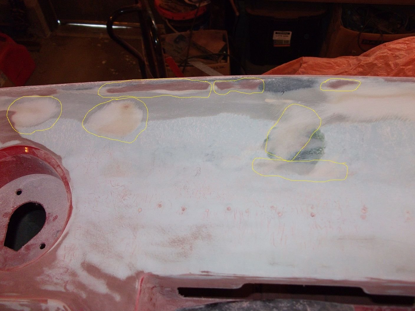

Questions for you fiberglass bodywork experts:
I'm very uspset about this. I started my paint removal with a featheredger and 120 grit. Once I got all the topcoat off and nothing but primer was showing I figured I'd hand sand with 120 the remaining red primer so as to keep things flat and from going too far. I removed the top coat with the featheredger on the tailight panel and then around where the "CORVETTE" letters are I thought I'd give a try some advice I'd read to remove the primer and used lacquer thinner and a steel wool pad. After a LOT of rubbing I had the primer off around the letters and to my great dismay it had removed some of the resin from the fiberglass and now fiberglass strands are showing through and the surface is pretty rough as you can see in the picture below. What do I do with this now? I'm thinking rough it up with 80 grit, put vette panel adhesive/filler over the letter area and block back down.
I've been using a sanding block and 120 grit on the areas outside of the "CORVETTE" letters and I've gotten down to the fiberglass in a large area but I see various low spots (outlined in yellow) where there's still filler or primer. Do I keep blocking with 120 until the filler and primer is gone, or do I use my thumb and sand down the filler and primer in the low areas until its gone and then apply vette panel adhesive/filler over the whole area and block it flat?

You are CORRECT in both of your thoughts.
Get the panel prepped and apply the Vette Panel Adhesive around the "CORVETTE" letter area...and I would grab a grinder and grind out the body filler and fill back over it with the VPA.
FREE ADVICE:
When I had a crew of guys...some of them were being taught. And when I would tell them what I wanted done....I would let them get started and 'see' if they had a problem they would know how to handle it. Some would literally do EXACTLY what I said...even though 'things' changed in the process they were doing. And in doing so...damage occurred. SO.... If you run into an issue where you see you are having a problem in an area is giving you a fit and damage is occurring....STOP and re-evaluate.
I know it is all about the 'learning curve'...TRUST ME----I KNOW!.....so DO NOT beat yourself up about this. NO major problem has occurred that can not be handled somewhat easily.
IF you have NOT used VPA...PLEASE let me know...or read previous posts about the VPA...because it can go EASY...or really beat you up and make you work to death on it.
When I do work like this....I remove ANYTHING that is NOT factory applied....and sometimes that gets ground down also due to the specific circumstances.

So, if I understand what you're saying, you're saying do NOT continue blocking with 120 until the areas outlined in yellow are gone, but rather sand out only the areas outlined in yellow and then apply VPA over the entire area and block until flat.
CORRECT...anything I come across a filler or 'whatever' that has been applied.....I stop can will take my grinder and grind it out and then fill it in or at least take the time to try to figure out WHY they filled in that area with 'whatever'.
BUT make sure that when you apply the VPA...the panel that you are applying it is has been prepped so NO VPA gets on a part of the panel that might still have primer or paint on it. That is BAD HABIT to get into to.

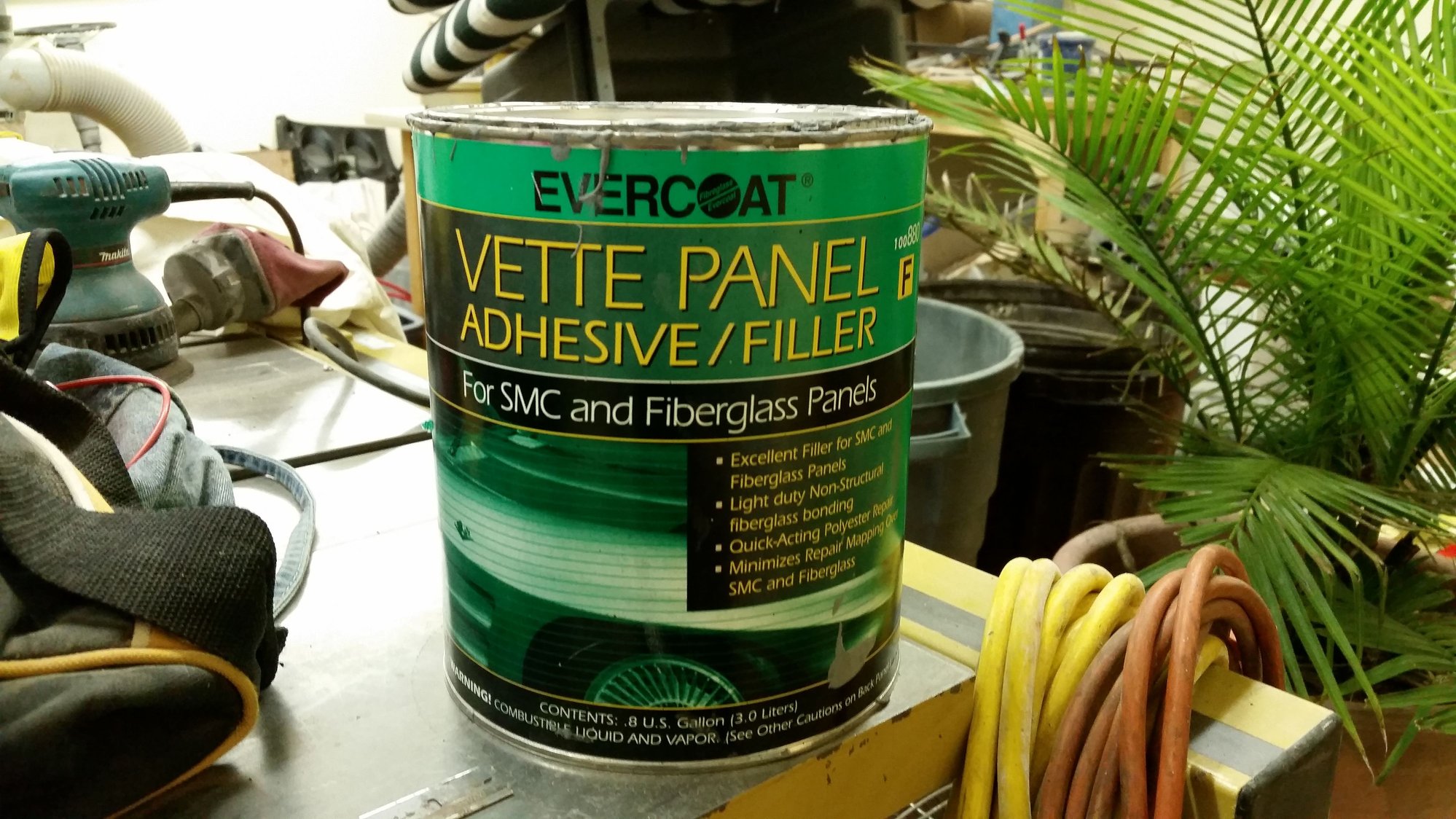

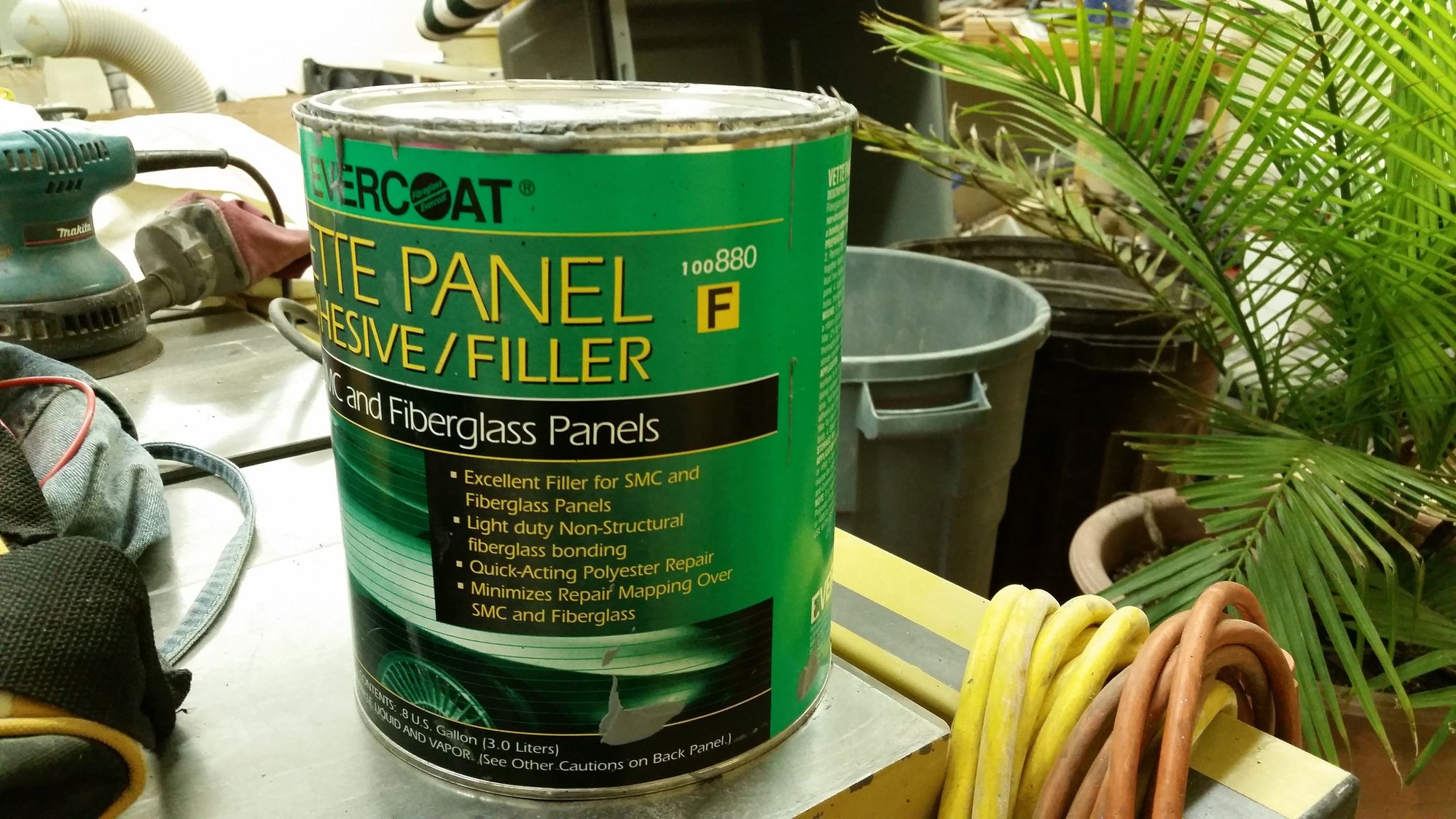

Here's the VPA that Dub recommended for me to use. Once you get a feel for it , it really does a good job. You can start sanding with 80grit soon after it is applied. Once this stuff cures like 24hrs later it is like a rock and very tuff to sand.
ZIO
Before and after on a door seam. Good Luck!

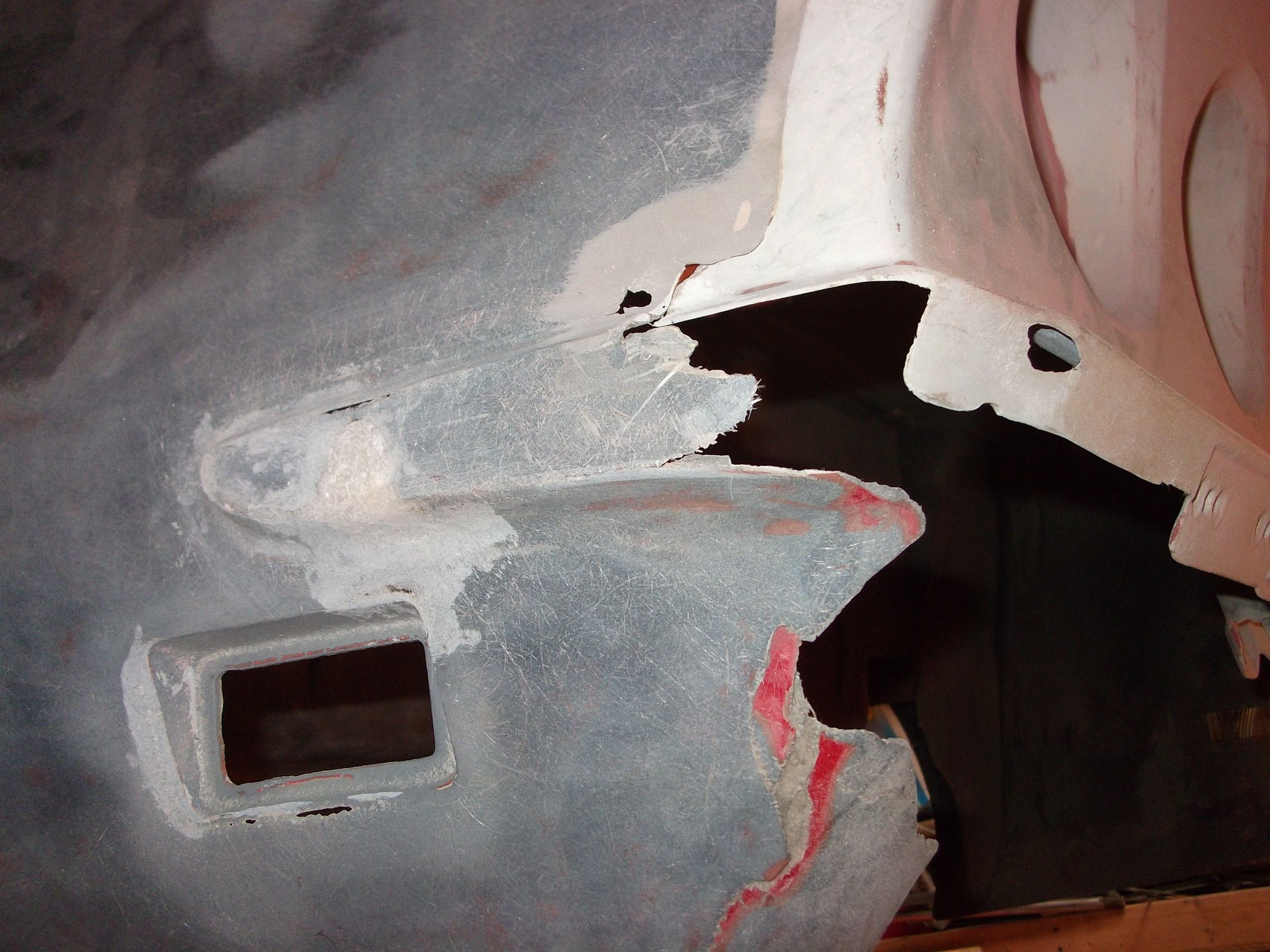

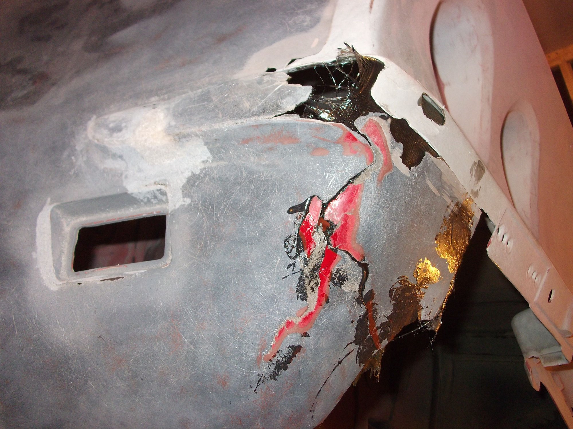

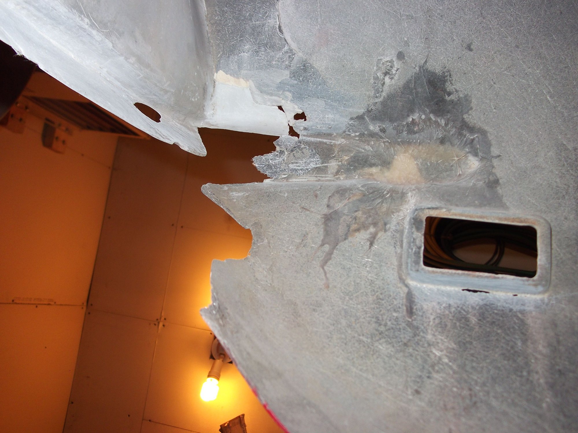

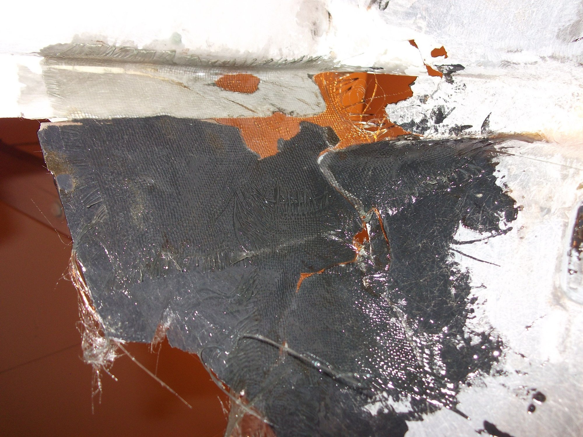

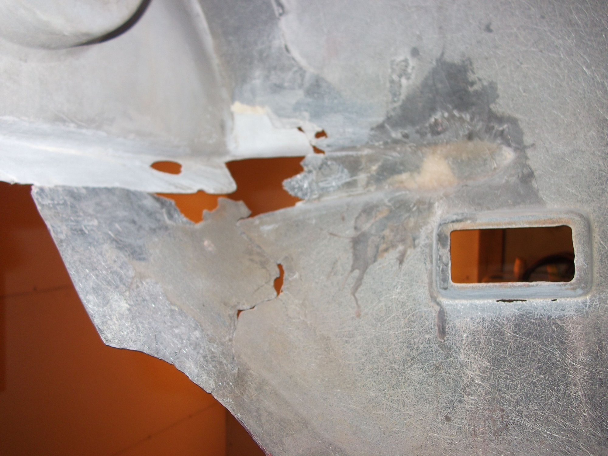

Slowly moving along. Got the rest of the paint and primer off the tailight panel, it was slow going and I was extra careful not to sand off the edges of the body lines. I finally got started on some fiberglass repairs, got the lower left corner where the tailight panel and the driver's quarter ready for fiberglass. I didn't realize, but the flange for the exhaust bezel is a separate piece that is glued onto the rear quarter. I decided to remove that as I'll be making a square opening for the 70-73 style exhaust bezel. Wow, was that ever glued together! I tried the heat gun and couldn't make much progress so I sanded off the flange and the bonded area most of the way down to the bonding adhesive. I was then able to get part of it off with the heat gun and the rest I sanded off. In removing the flange I broke off a piece of the quarter panel fiberglass where it was already damaged.
Fortunately I was able to wedge the broken piece into place and get some fiberglass cloth on the back of it without knocking it out of place.
It'll be fun trying to get the fiberglass mat to lay flat against the raised area that goes underneath the bumper. I'm surprised by how thin the factory fiberglass is. I thought on my 79 it was close to 1/8 inch thick but its only about 1/16 inch thick on the 69 rear clip.

Thanks Doorgunner. I'm building up the backside with fiberglass cloth for string, then I'll "V" out the cracks on the out side and put fiberglass mat on the outside.

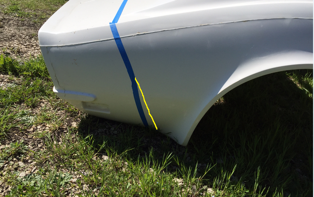

I had some concerns about splicing the 69 rear onto my 79 regarding the character line that goes horizontally down the front fender, the middle of the door, and the middle of the rear quarter. Seems the line on the rear quarter of the 79 rises towards the back whereas on a 68-73 it does not.
https://www.corvetteforum.com/forums...onversion.html
I was unsure if I should attempt the splice in the middle of the rear quarter behind the rear wheel, or if I should be looking at replacing the entire 79 rear quarter panel with the 69 quarter panel. After much thought I decided the 69 rear clip I've been working on is just too beat up and so I bought the rear portion of a new ACI 70-73 rear clip of Forum member Bighead:
I would have liked to have had the entire rear quarters on this but Bighead was unable to ship the entire piece and I didn't really want to pay to ship the whole thing either. As per the aforementioned thread, I'll graft this onto my 79 and shape the mid-quarter panel character line to match 79 to 70-73. The inner splash shield can be removed so I can take that off and build up the inside of the 79 quarter panel up to the rear wheel to account for the shaving I'll have to do to make the horizontal character line blend in. It doesn't appear the holes have been drilled for the C O R V E T T E letters so I'm feeling uneasy about having to do this myself and get them straight.
