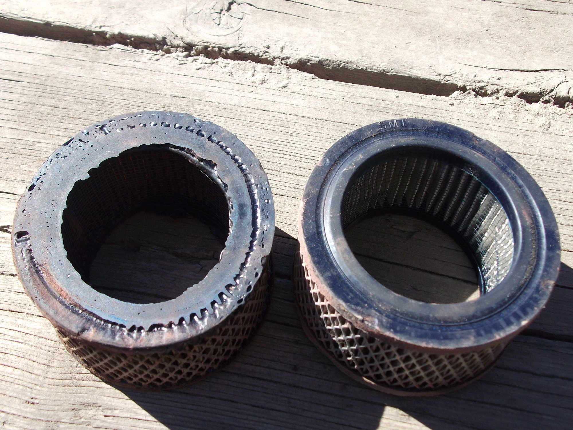

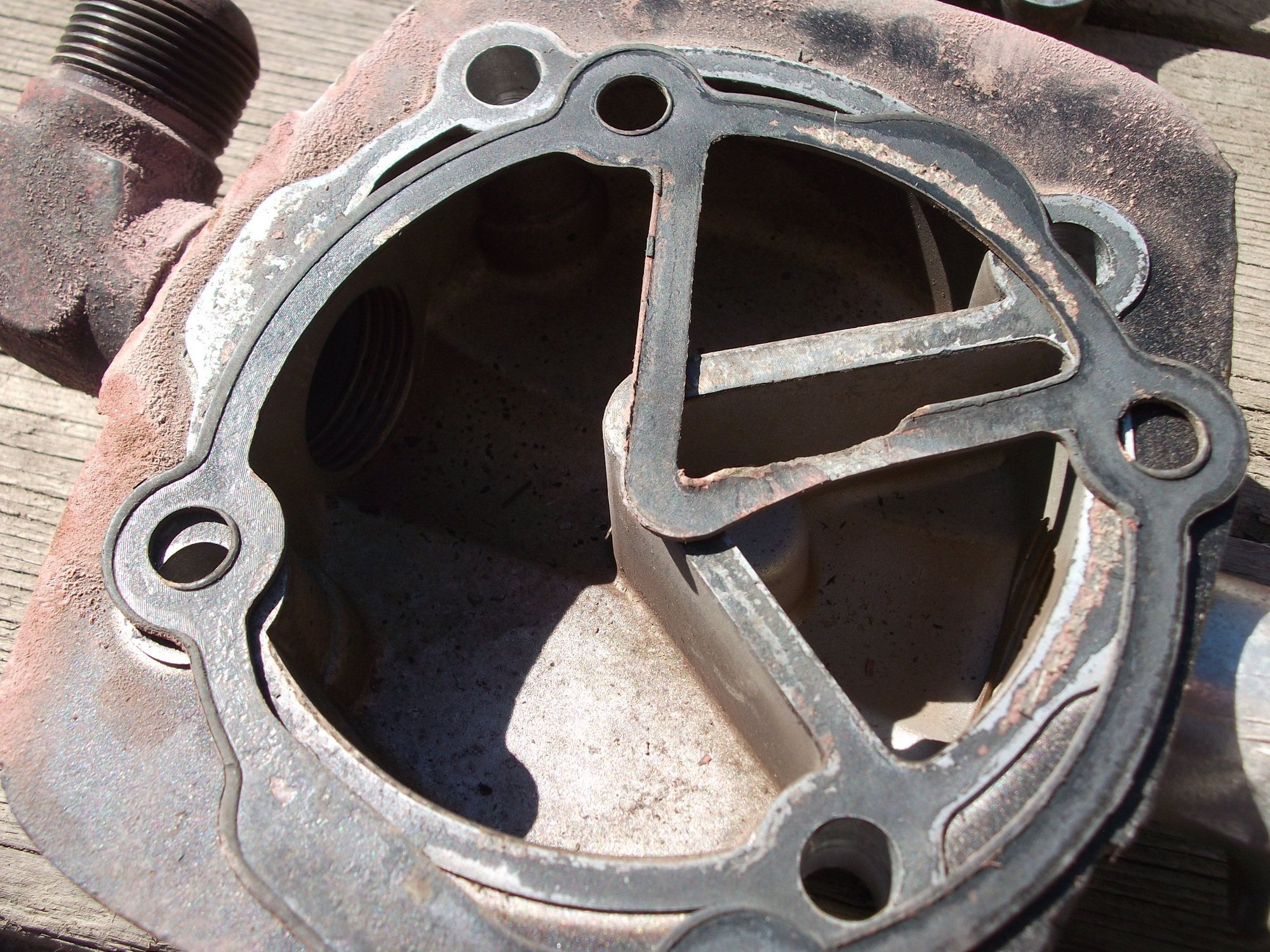

Hubby pulled the heads off of the compressor today and here's what we found. One cylinder got so hot it actually melted the air filter:
The filters were so dirty that one of them actually tore as the compressor was trying to suck air in. It appears the major performance problem was merely a gasket that had failed and let air leak from output side of the head to the intake side:
All the valves looked fine and no scoring of the cylinders or obvious problems with them or the pistons. I suggest replacing the rings but hubby said if we're going to do that we may as well find and repair the source of the knock and if we are going to do that we may as well replace the pump. So, new air filters and new gaskets and that should double or better the recent performance of the pump which was pretty bad. At least the (partial) fix is cheap and it won't be down for long.

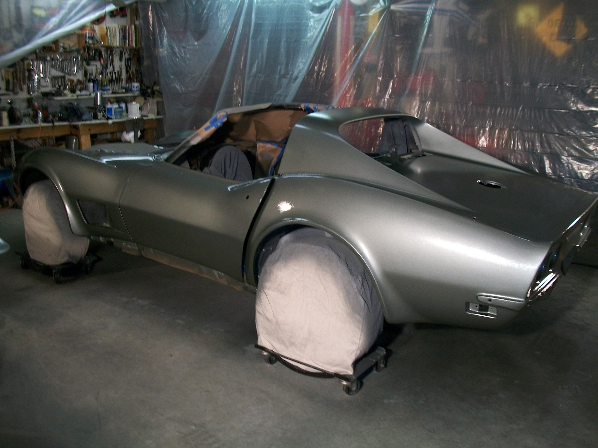

I will tell you a fun perhaps to some pointless story, just for the fun of it,
Close to 20 years ago, damnnit time flies I would spend my weekends with some good old boys into trucks, airboats rods choppers you get the idea,
So my buddy Wayne picks up some insane bright caution yellow paint on discount and decided it would be perfect for his stretched mini truck, and sets up a 1/2 *** plastic tarp paint booth in his back yard,
it's getting later in the day but the truck is prepped and taped off and I was really badgering Wayne to get a person with more time on a spray gun to shoot it,
But "Wayne wanted the honor of saying he did it, and man oh man, there was thrash ranging from bugs to dirt in the finish when he was done runs all over, then a couple days later he has had the "crue" wet sanding it and then buffing it,
I was simply floored how well it turned out to have looked so badly,
A few weeks later Wayne took best paint in a truck show and their was some really expensive "shop" jobs there.
You likely know oldgto right here on the forum, he lived near me in orlando and I have seen his c3 many times, he painted it, wet sanded and buffed it, the finish is mile deep and if it has any flaws it's that jim is being too critical of himself on it, the thing is stunning,
If a shop did it I bet it would have been one of these 10 k plus jobs,
How much do you have in it jim?
So yeah, it might take extra work but there are some really epic paint jobs people have done right at home with little real experence.
