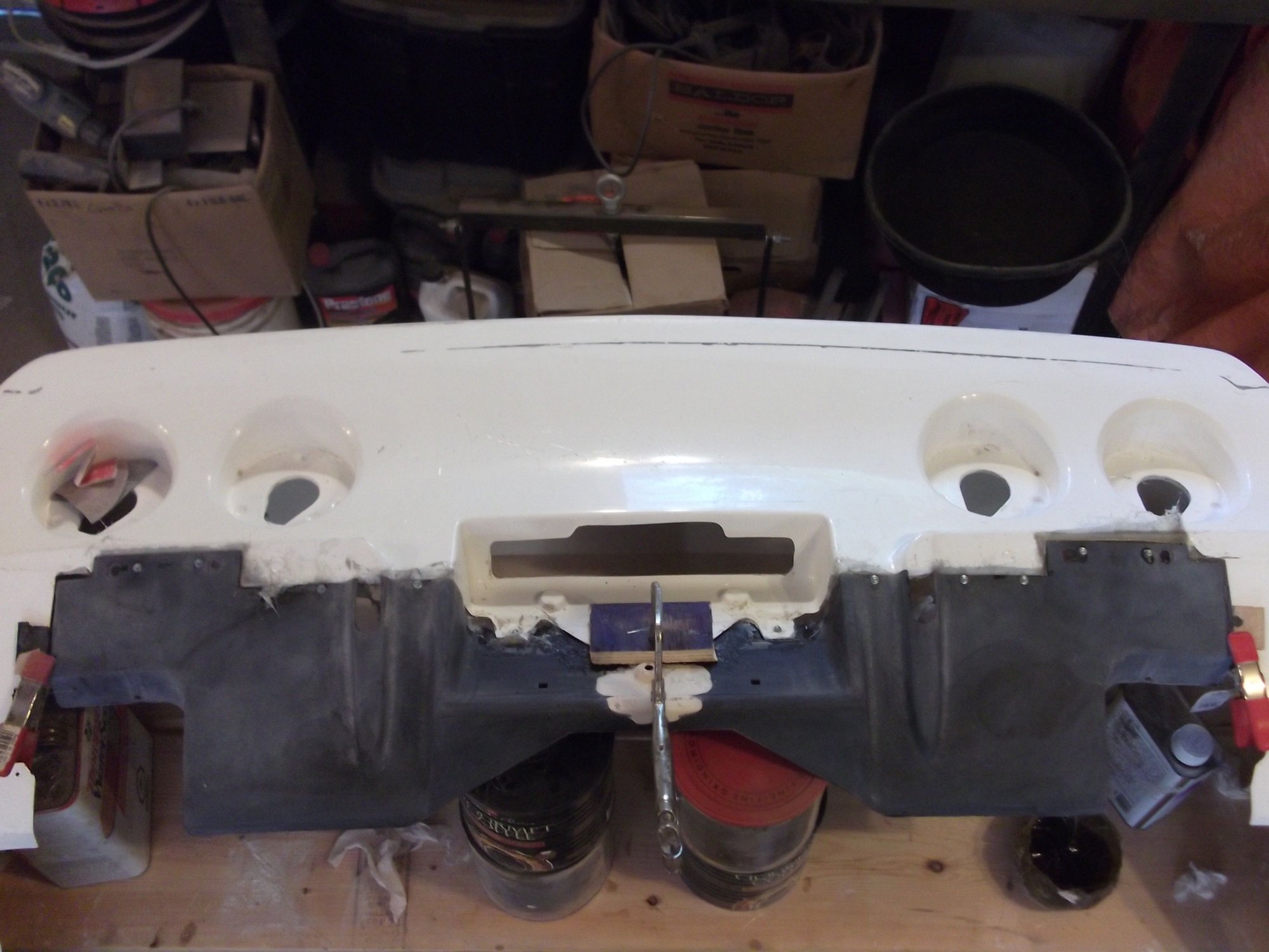

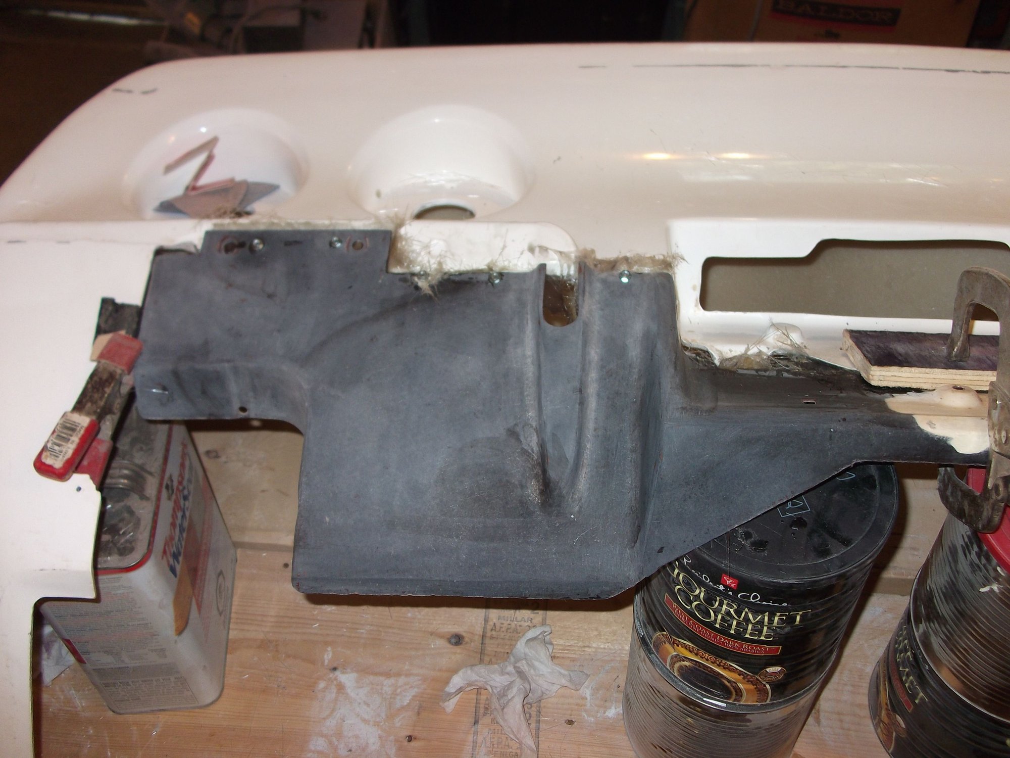

I started fiberglassing the exhaust filler panel to the 70 rear clip today. For starters I roughed up both mating surfaces and put a layer of fiberglass mat and resin between them. I held it in place and hubby turned in the screws to hold it together while it hardened. I put too much hardener in the resin and the thing set up before I had a chance to fully clean up the drips. I had hoped to wipe the resin off the tips of the screws on the underside before it hardened to make it easier to remove them later. The license plate bezel is supposed to be here Monday so I can do the finish work but the post office may go on strike at any time so I might have to wait who knows how long before I can finish off this bit of glass work.

Just my thoughts on this...
I hope you ground off the white gelcoat before doing this in the area where the resin and mat were applied. I am not a fan of applying resin on top of gelcoat.
And I am a bit concerned that the resin mix set up so quickly.
DUB

Well, I didn't remove all the gelcoat, I just roughed it up.

Well I guess I would have to check and see the areas of the mat and resin that are out on the white gelcoat...if you can get under it with a thin sharp tool and get the resin to 'pop' off. That would be my first test.
I use VPA in this scenario to bond the panels together and then laminate over it.
DUB

I'll have a go at seeing if it pops off and redo it if it does.
