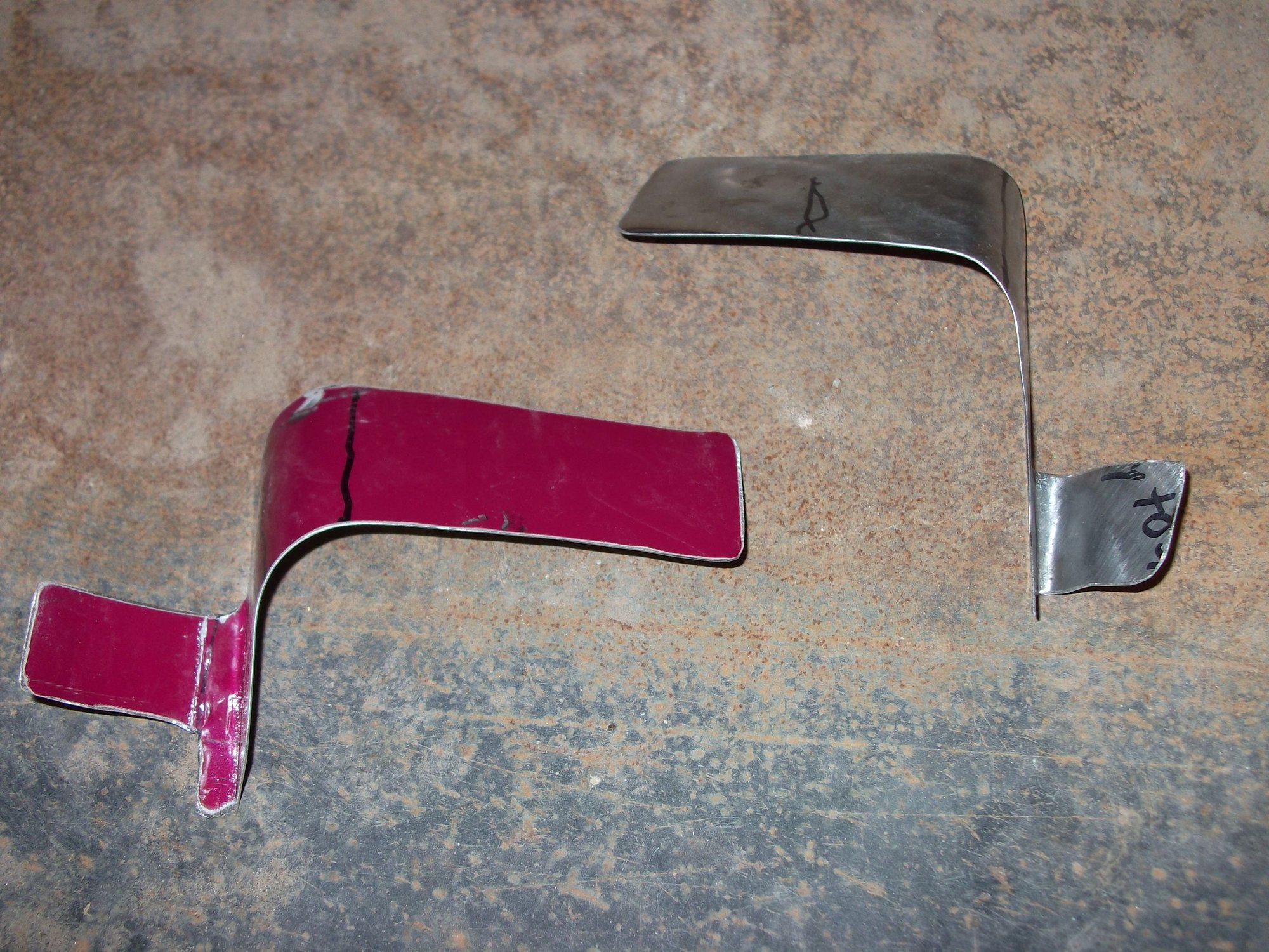

I finished the outer fiberglass flanges for the exhaust bezel yesterday.
I started by making these to backup the wet fiberglass as I laid it in place.

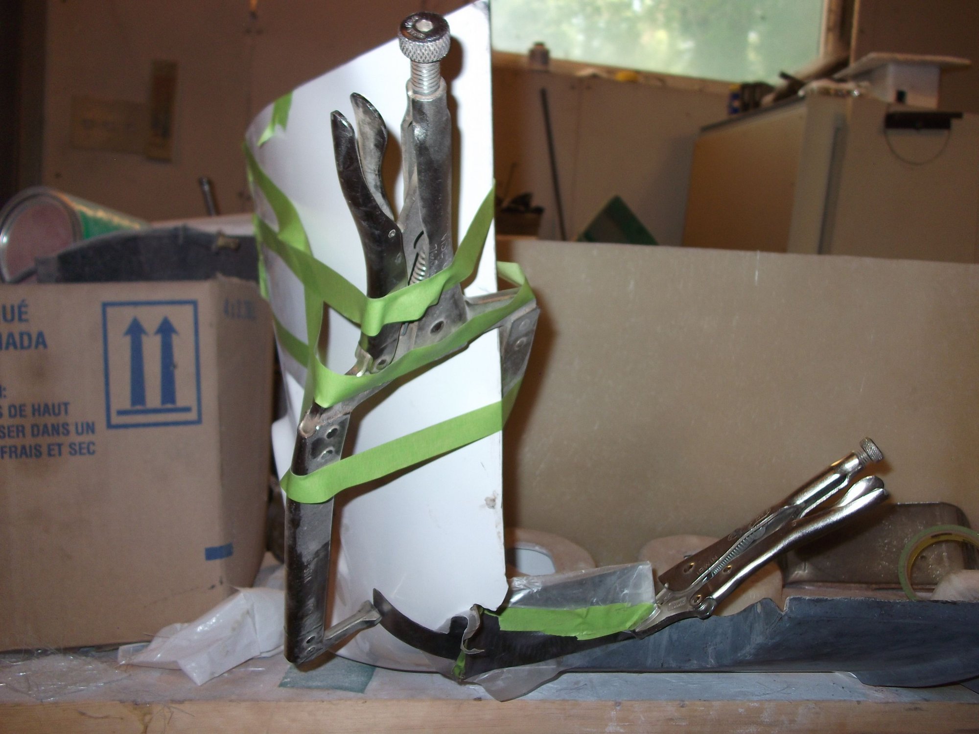

Wax paper on the inside edge to keep the fiberglass from sticking
Here's how I had to clamp it in place, a little tricky to do while maintaining space to lay in the fiberglass

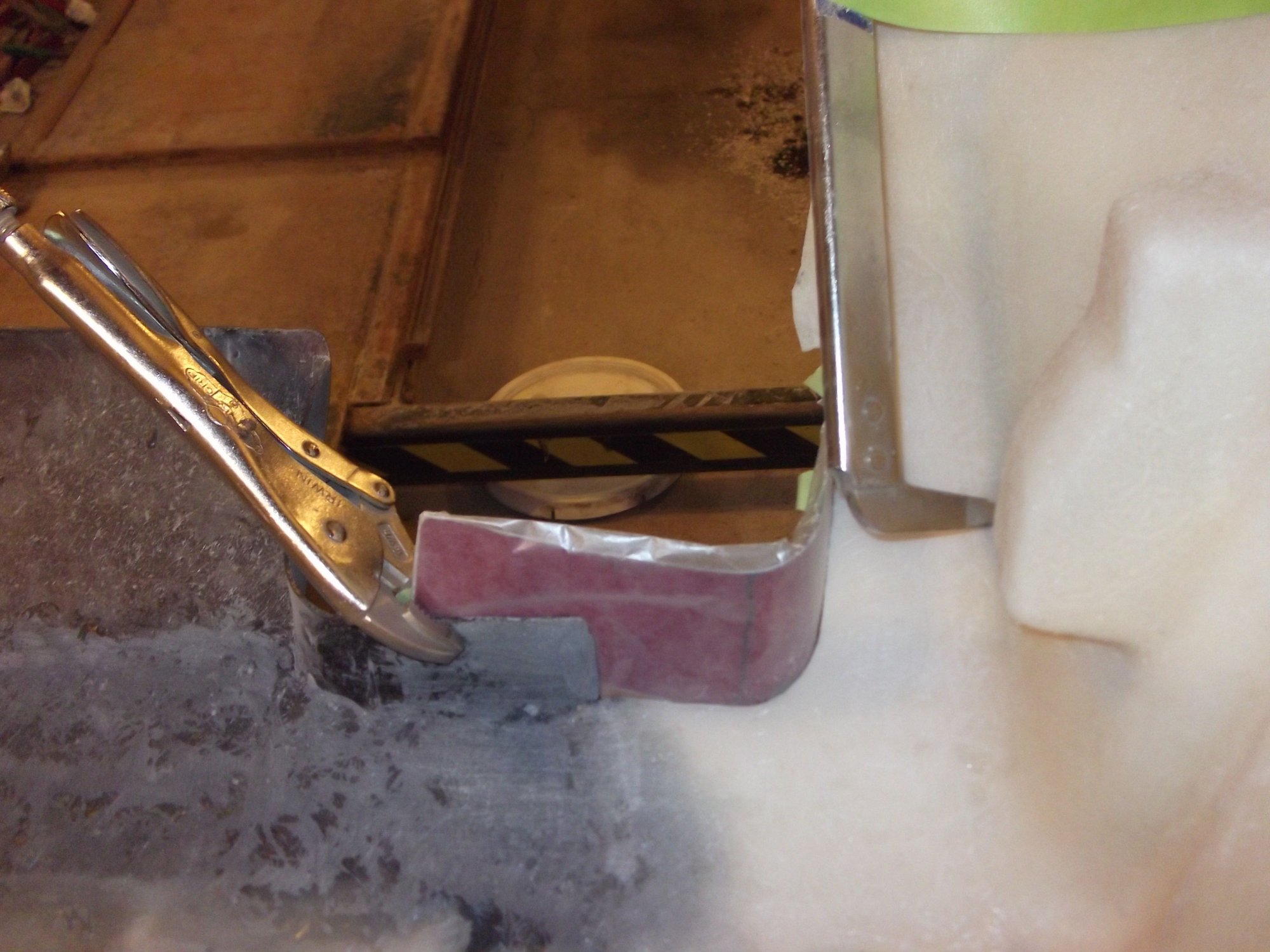

Laying in the fiberglass cloth:
And the finished product:
I tried to test fit the left side bezel and the factory hole in the exhaust filler panel was a long way from lining up so I had to fiberglass up the hole and make a new one. The black mark to the right is where the hole in the exhaust bezel lined up with the factory exhaust filler panel. It was actually right on the edge so I couldn't just drill a new hole in the unmodified panel.
And now the exhaust bezels fit nicely or at least as nice as the aftermarket parts will allow:
