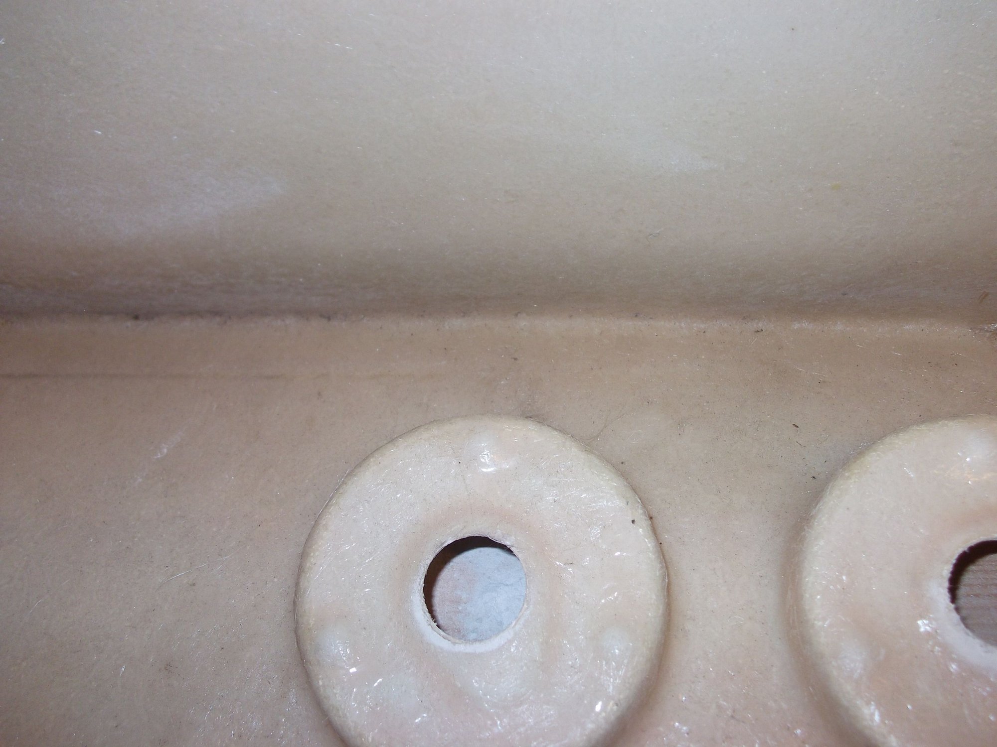

So when I picked up my second rear clip I damaged it stuffing it into my Eagle. There are some very fine stress cracks as you can see in the pictures below if you look carefully. The first picture shows the cracks much more clearly than they appear in real life. The second picture is closer to what the cracks look like in real life - they are very hard to see and one must be at the right angle to see them. Can I just sand these down a bit and put Vette panel adhesive and filler over them, or do I need to lay down fiberglass matt?

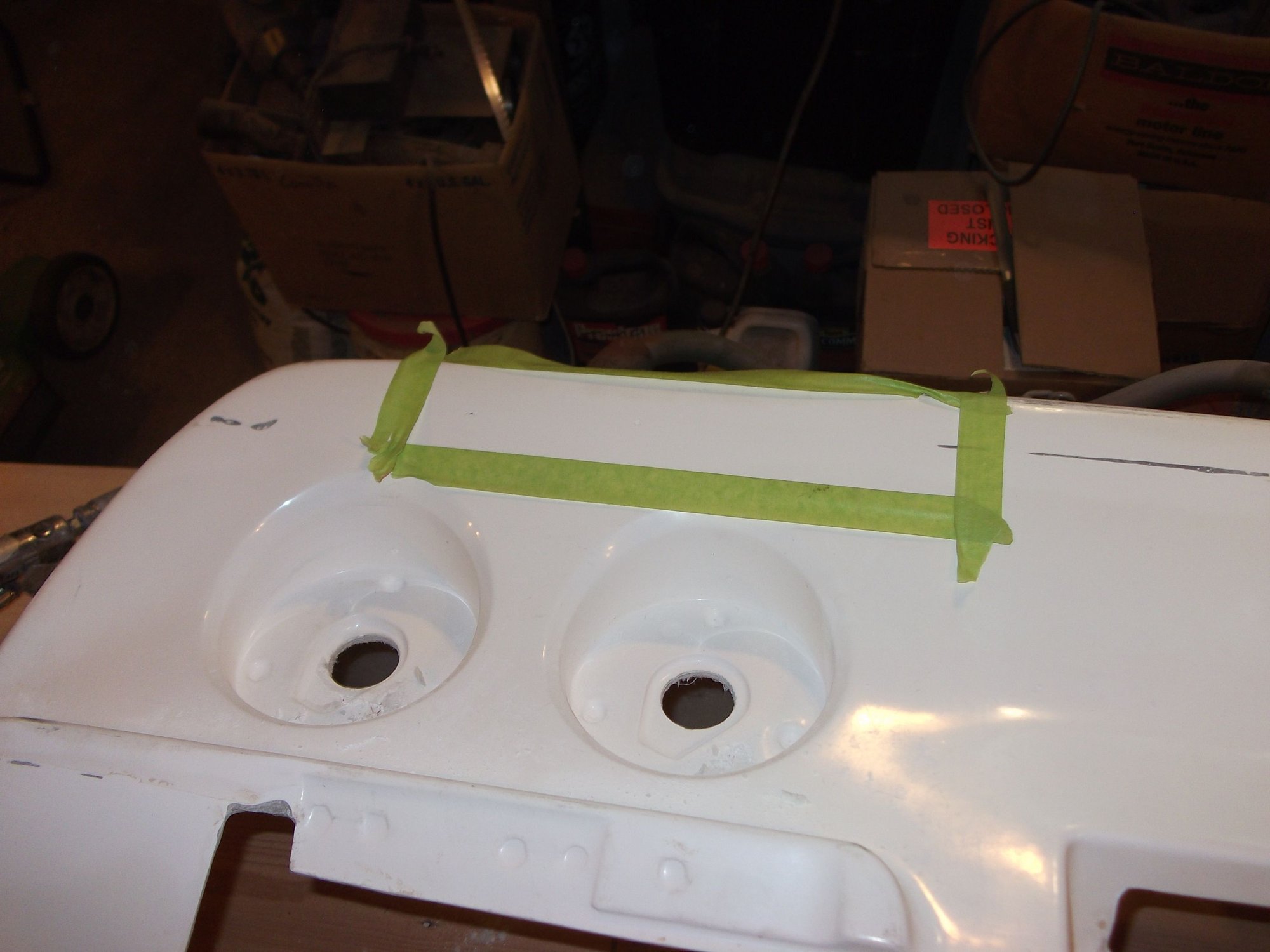

I do not know where these cracks are located. I need a photo taken further back...and if you want to put masking tape on where they are located so I have a reference point.
Is this clip handlaid???.... or factory with what appears to be white paint?
And if you look on the backside of the damaged area...and it being a handlaid part....can you see distressed fiberglass that can have a white look to it????
Using VPA or matt and resin/gelcoating is still up in the air. Which is why I personally need to know where the damage is located on the panel.

The clip is new hand laid fiberglass with a white gel coat. Looking at the backside I don't see any fiberglass that looks distressed/white or damaged.

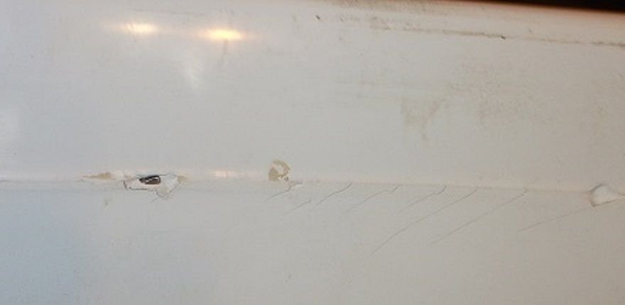

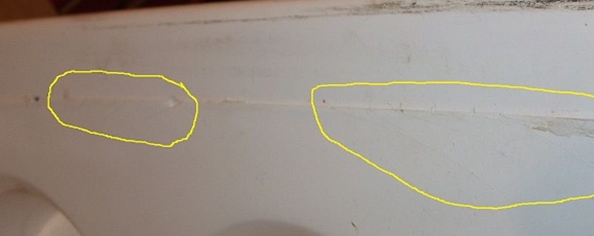

Thanks for the new photo.
Honestly....And I know I am not there to see it due to photos sometimes can not show clearly what an eye can see.
The area of concern is where the parting lines of the mold come together. And what you might think is damage that you did to it...actually can be cracks in the mold that show up in the gelcoat of the part when it is made.
In your series of photos...where you can see the crack BELOW the parting line...I do not see any above the line...which tells me there may be an issue in that section of the mold....and not a problem in your part.
Because I can not see any issues from the backside. If you still feel you have a concern...either take a magnifying glass and look at the crack really good...OR...take the part outside in the sun..and look at the 'damaged area' from the backside with the sun on the outside and chances are...you will have enough light shining though to let you see if you see cracks that are actually wider than what is seen from the outside.
Either way....VPA can fix this.

Dub, I sanded the parting line where the cracks are with 120 grit to even the level between the two parts of the panel. I hope you can understand my diagram below. I've exagerated the shape to hopefully make it clearer what I'm talking about. This is viewing the rear clip as it would sit on the car but from the passenger side. The black line is the original outline of the rear clip. I sanded the mold parting line down to where the red line is. Now there isn't a smooth curve from the ducktail to the tail lights. Should I continue sanding the tail light panel at point "A" to regain the smooth curve or should I fill the tail light panel out to the blue line in order to get the smooth curve?

OK...from what I gather from your drawing....the parting lines were OFF a lot...and NOT flush. So you sanded on the parting line to get this area flat. Am I correct???
And in doing so....the contour of the body is off a bit and not to your liking. Am I correct???
AS long as this sanding you are doing is not going into the fiberglass a lot....then applying VPA to build it back out to where you want it.....OR...as much as I hate to write it....depending on how much you have sanded it...you could block this issue out and not need any VPA.
This is where your sense of feel and being able to close you eyes and picture what you are feeling and then apply what you are feeling to the panel and decide if adding VPA will get you to what you want is the way to go...or carefully blocking the panel out and then taking into consideration applying gelcoat back on this area to build it back out and then possibly a polyester primer.
IF you feel that the amount of gelcoat and/or polyester primer is going to be quite a lot to get this area filled in and right...then you might want to apply VPA.
MANY times when I am working on a Corvette ...where I feel a body defect. I can picture it in my mind after feeling it and decide IF me blocking it out will do it OR it is better to STOP and fill it in with VPA. Over the years I have learned and know what I am feeling and how it equates to how much of the body I would have to block down and off to get that distortion out of the panel.
I am more concerned about sanding down the thickness of the body to get the repair flat....and WEAKENING the panel at the same time.
Hopefully what I wrote made sense and helped you...If not...let me know.
DUB
Correct.
Correct.
DUB
Makes sense. I thought about this a lot last night and I'm going to fill the area on either side of the mold parting line with VPA as well as blocking a little farther down on the fiberglass where I now feel quite a bit of a bump where there should be a smoothly transitioning curve (or at least I assume that's the case as I didn't think to feel the tail light panel area before sanding down the part line).
