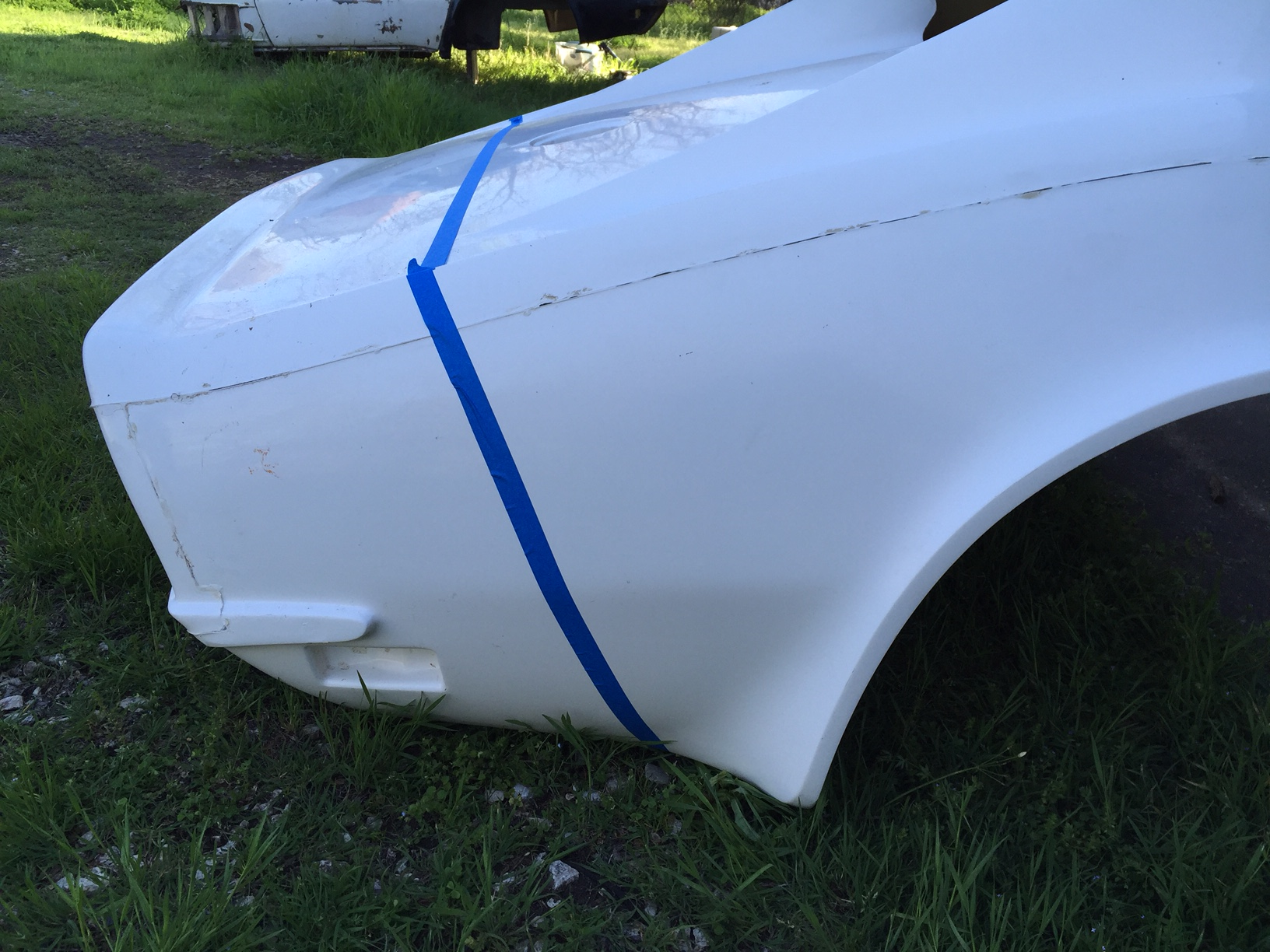

Priya.......you can MAKE it fit the '79 body. Stay focused on the general appearance of the new piece in relation to the car. If you focus mainly on the character line----the new piece will NEVER seem to fit. I think you will really like it once it is finished!
I think the striping in your sample pic really exaggerates the actual character line......when you remove approx. 10 inches (or less) of the rear secton of the '79 bumper the character line will be even less noticeable..........
(forgive the uneven/rough VPA...I didn't rough-sand anything yet)......
As I learned...."Easy Does It".......do not cut the '79 bumper off EXACTLY where you think it should be cut.......leave several EXTRA inches on the '79 for positioning the new piece. The new piece will not LOOK as though it will fit when you position it OVER the "extra length". After being positive that you have the new piece positioned to your liking.........(I waited a couple days/repositioned the "new piece" a little before I made the FINAL cut to remove the "extra" material on the '76 rear bumper)........remove the extra material so that the '79 edge will butt together evenly with the new piece---it will take a little "coaxing" to make everything fit "flush".
I hope I worded it so that it make sense.

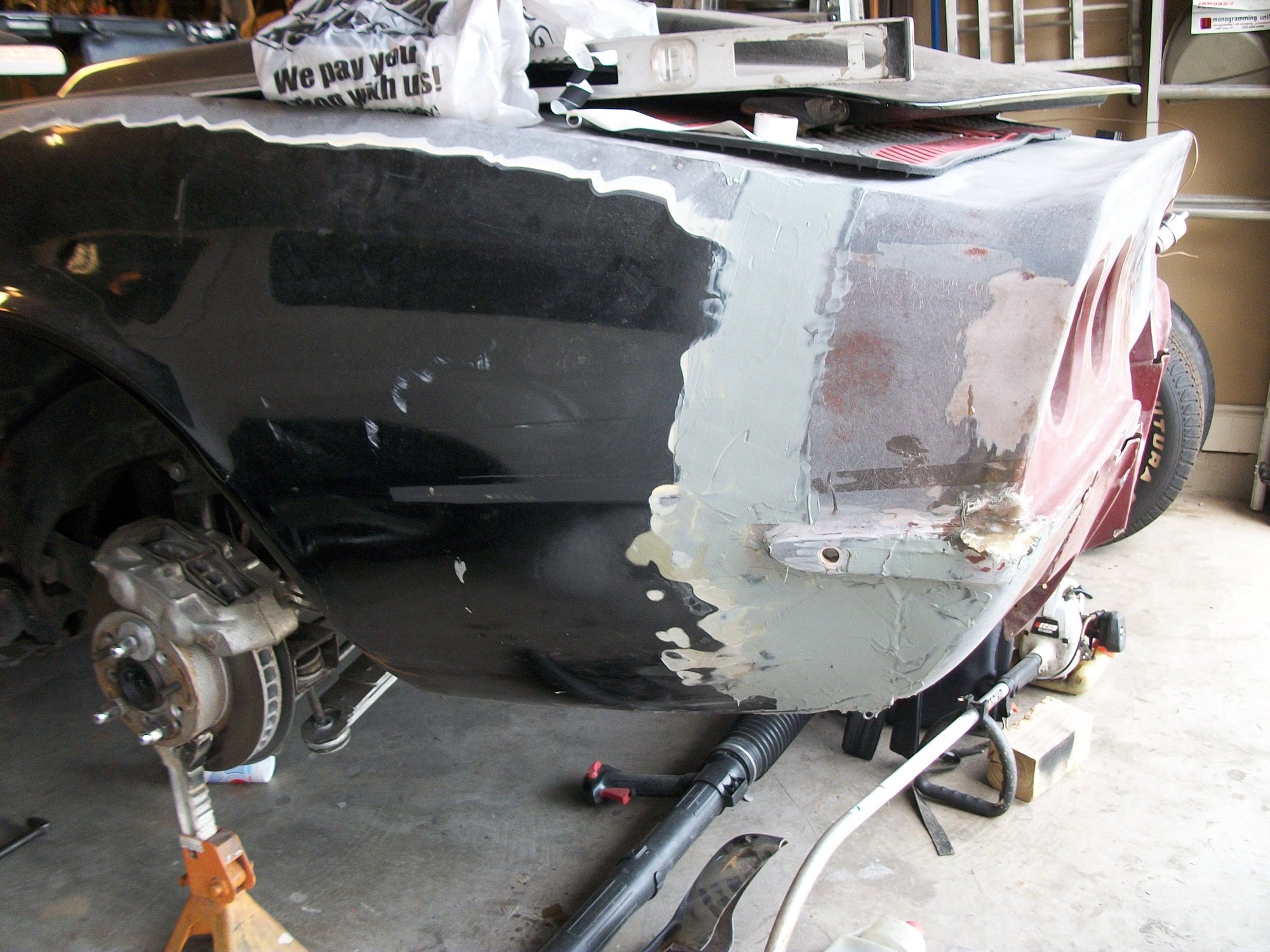

When the filler hardens it will reach an intermediate stage where it is not quite hard yet. At that time you can do your rough-shaping using a body file, aka "cheese grater". It lets you get 90% of the work done quickly. Then you let it harden all the way and have very little sanding left to do.

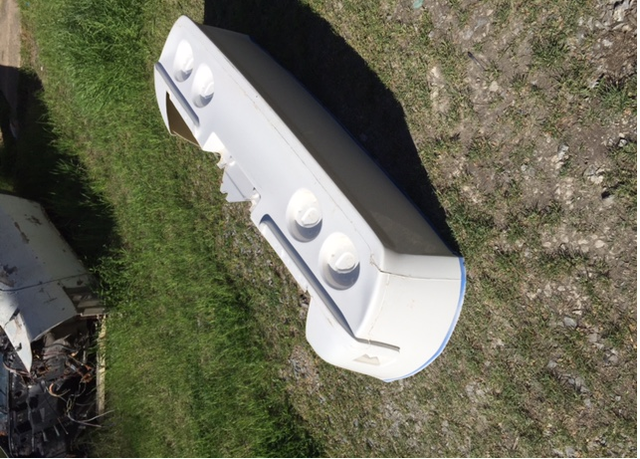

I'm going to use the rear bumper section I recently got. I decided the 69 rear clip I've been working on is too beat up for me to have a good chance of getting it properly shaped.

ok, that rear bumper section may just go right to your rear bumper flange. does it have a mounting lip on the front edge?
Old Mar 31, 2016 | 09:02 PM
  #130
Priya's Avatar
Priya
Joined: Dec 2009
Posts: 6,397
Likes: 649
From: Saskatoon Saskatchewan
No, it was cut from a complete ACI 70-73 rear clip. The upper deck part is longer than necessary just to make sure it wasn't too short so it'll need more trimming to fit.

That's great to hear........now you can "trim as you go!"
