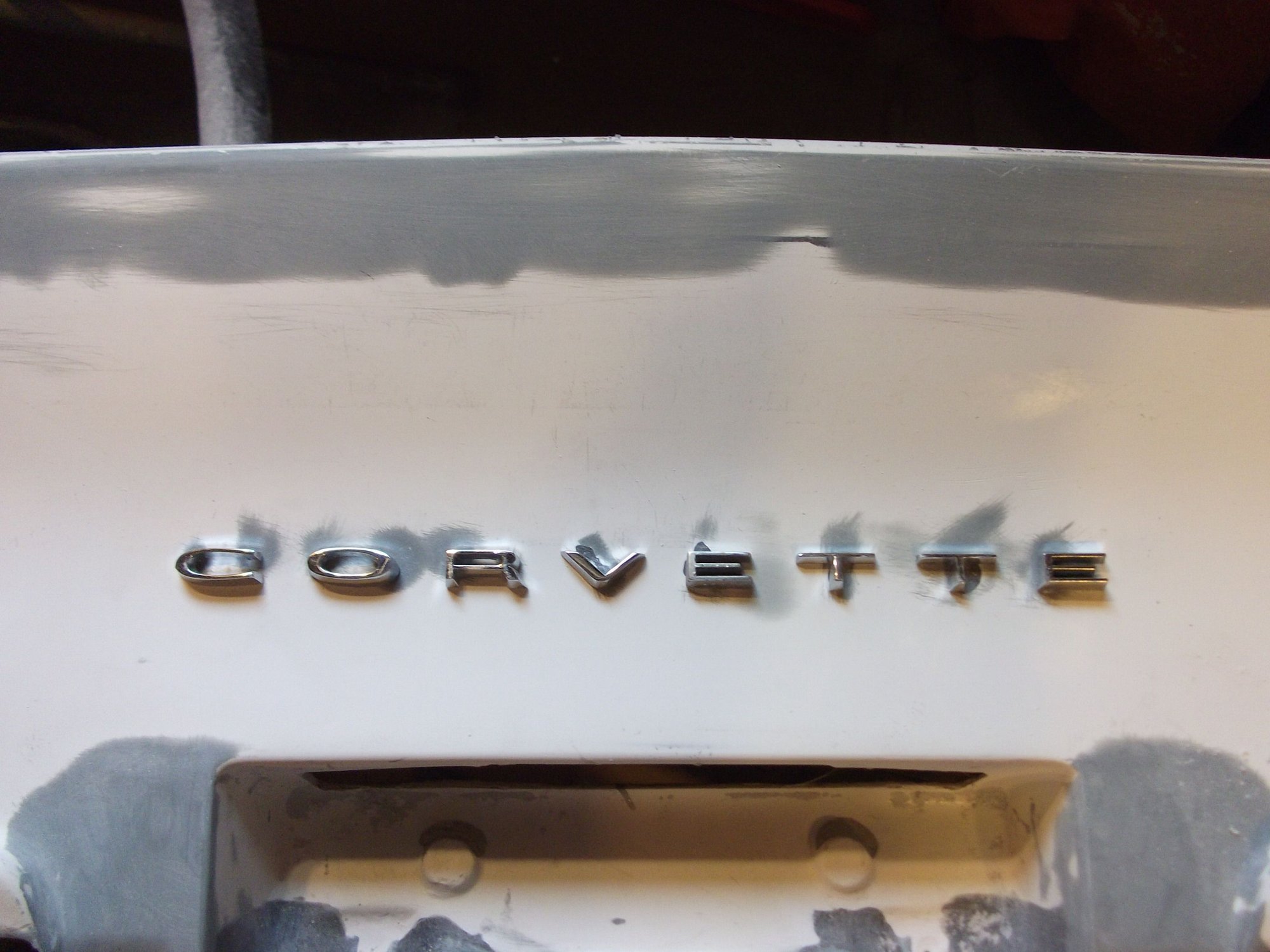

Third time's a charm??

In carefully manipulating the scroll button on the right side of the screen I can see I've still got the right side slightly lower than the left side, but sometimes you just have to say "After 3 tries this is probably the best I can do."

I decided I'm at that point. I know for example the holes on the "T"s and "E"s should be vertical. When I made my cardboard template from the tail light panel section you sent me and marked it on my rear clip I noticed the marks weren't perfectly vertical on one of the "T"s and one of the "E"s. I adjusted the marks slightly on the panel to make them vertical. Still when I drilled the holes I didn't place the drill bit in exactly the places I marked and the holes weren't vertical. As the long post is a bigger hole than the short post I started with a thinner drill bit sized for the small post and then when I went to make the bigger hole I pushed to one side or the other with the smaller drill bit until I had a bigger hole vertical to the smaller hole. I needed to do a bit of slotting to get the letters even and was able to do so without making the holes so big that the holes show underneath the letters. Given the inevitable bit a person is off on marking and then drilling the holes I think I'm unlikely to get this any closer on a fourth attempt and there's a good chance I'd be farther off If I redid it yet another time.
So, sometimes, like you say, you need to know when to stop.

Now...getting these letters to where you are happy with them. When you start applying primer, paint and clear. These holes will close up. SO...when you go to put them on. What I do is use the drill bit and manually run it through the holes....BIT....here is where it can get really touchy.
IF the larger hole for the emblem is so precise that when you put the letter into it...and then have to take it back out for some reason. The correct nuts used can cut grooves (threads) in the shaft of the letter...thus changing its diameter....because the metal that now has thread on it has to be able to go somewhere. And when you try to take the letter back out...it can grab the primer, paint etc you applied on the panel and cause it to chip off.....and that can still happen if you are really diligent in paying attention to the prep of the fiberglass around those holes. And this goes for all emblems that go through the fiberglass.
Do not think that the small holes for these letters are not just as important...they may need attention also.
DUB

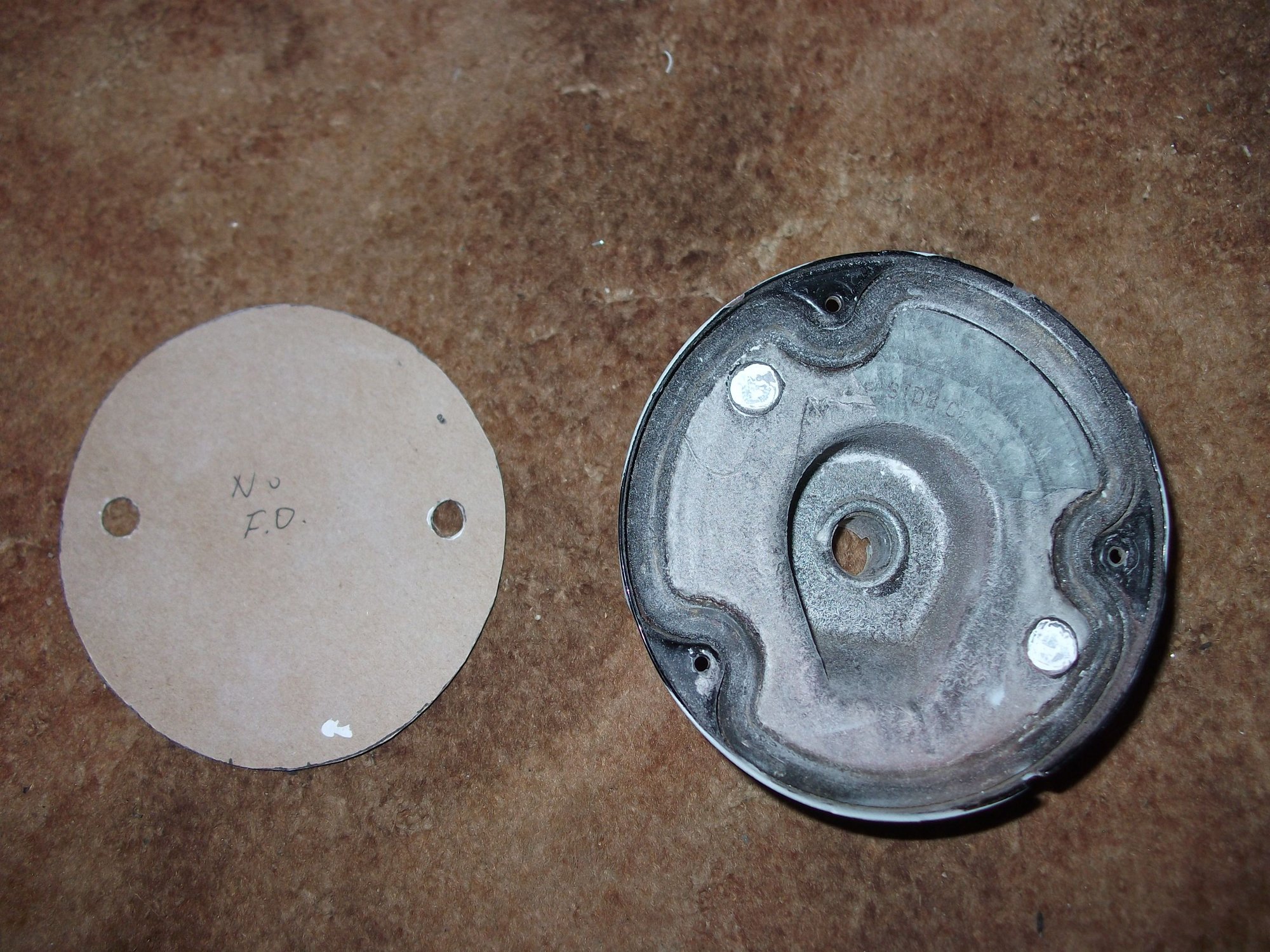

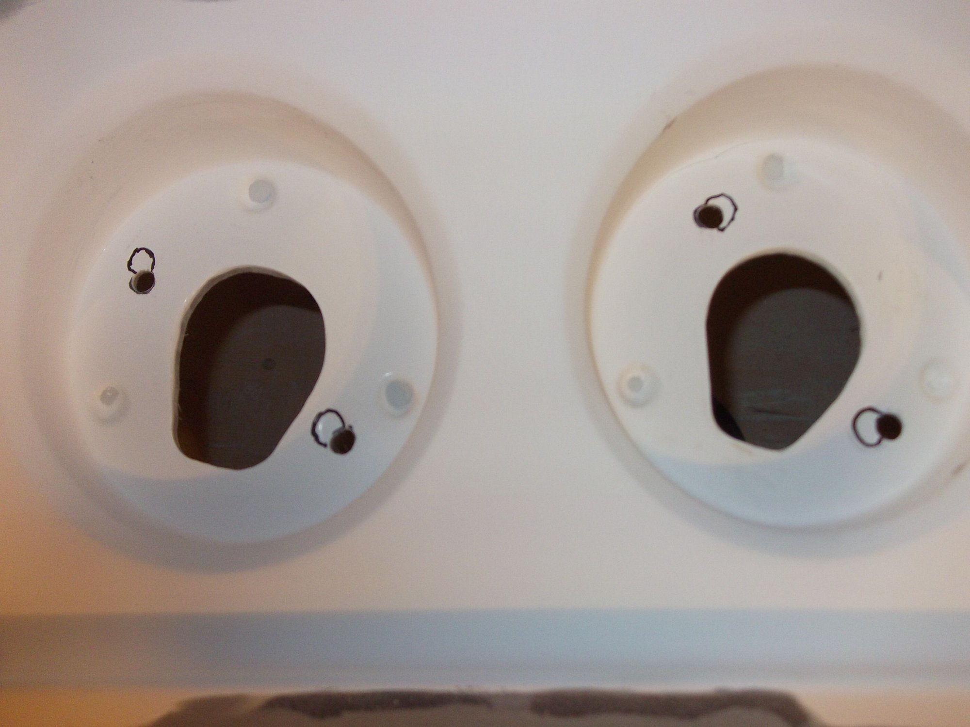

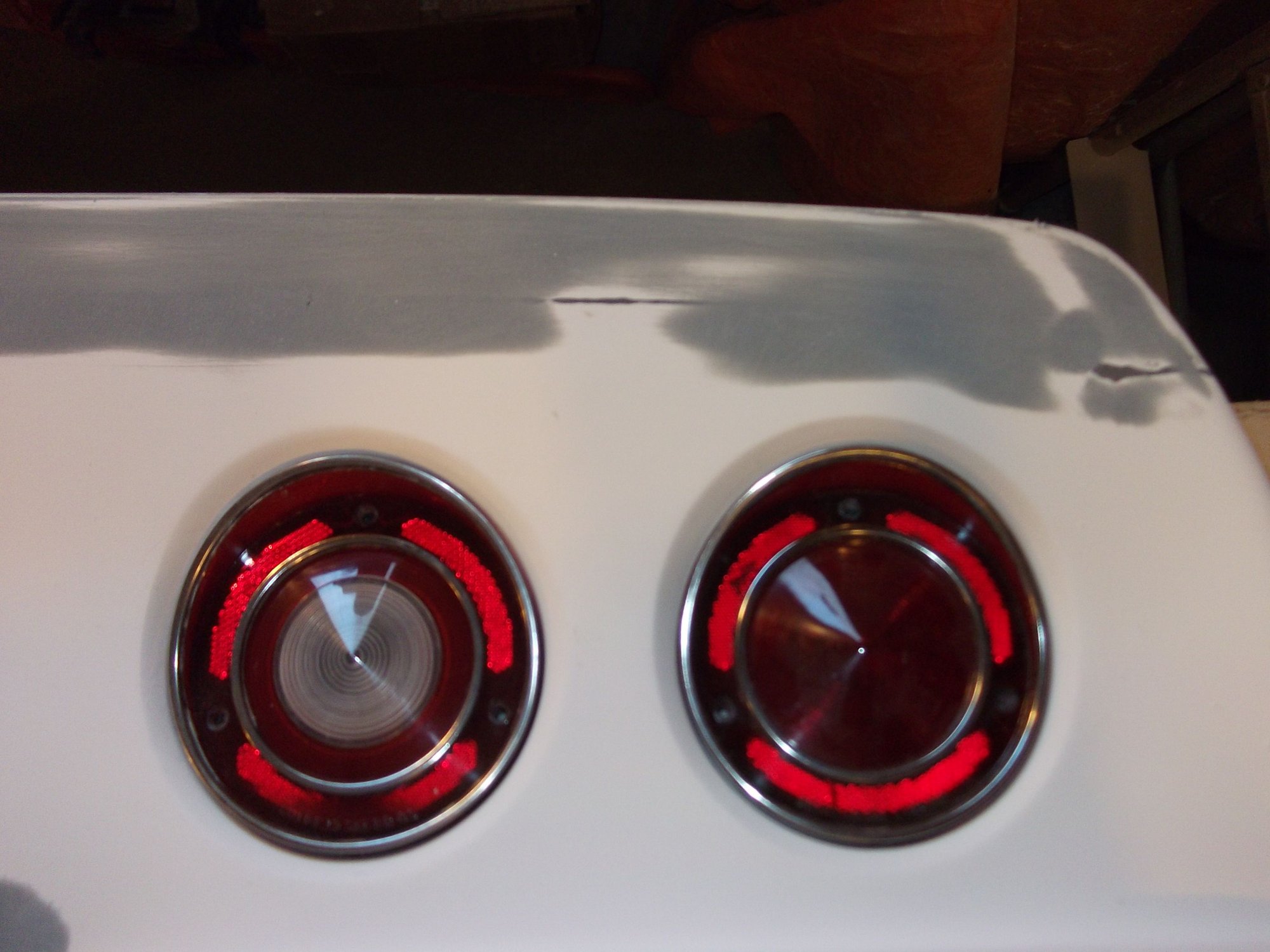

Today I drilled the holes for the tail light housings. Once again, ACI Fiberglass put indentations supposedly where the holes for the housings go. I got smart this time and didn't trust them. I took both styles of housings and made cardboard templates with the location of the bolts on the housing and the lens screw hole facing the top of the opening. I put a wet coat of some white-out on the housing bolt holes, pressed in the cardboard circle against the bolt studs and marked the location of the topmost screw hole from the back:
Just for illustration I outlined with a black sharpie the ACI indentations to show how far off they were:
And I got the housings lined up nicely:

There really is something beautiful about those taillights in the gently curved taillight panel!
Especially when the bumpers are mounted and you see the reflection of the lenses in the chrome! (So you still have something terrific to look forward to.)
I don't think you'll ever drill a hole again without testing first!

I don't know - the marks look kind of close, your mounting holes are too small. 3/4 inch would work fine.
Great job - looks great..

3/4" holes where??? You are not referring to the 2 holes to mount the taillight assemblies are you???
The holes that were drilled to mount the taillight assemblies are just fine. No need to go larger.
I know there is more than one way to do something....and that may be what we have here...a different way of doing something.
